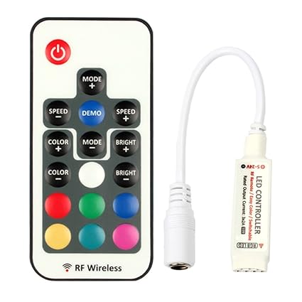

You can get these remote controls/controller for the strip lights in either RF, IR, wifi or wifi+IR. If its wifi I check the app can do groups and control all at once. If its IR then they should all change at the same time assuming the remote can see all the ir receivers. However if your going to be running some colour changing sequences etc... be aware that they probably will drift out of sequence.
