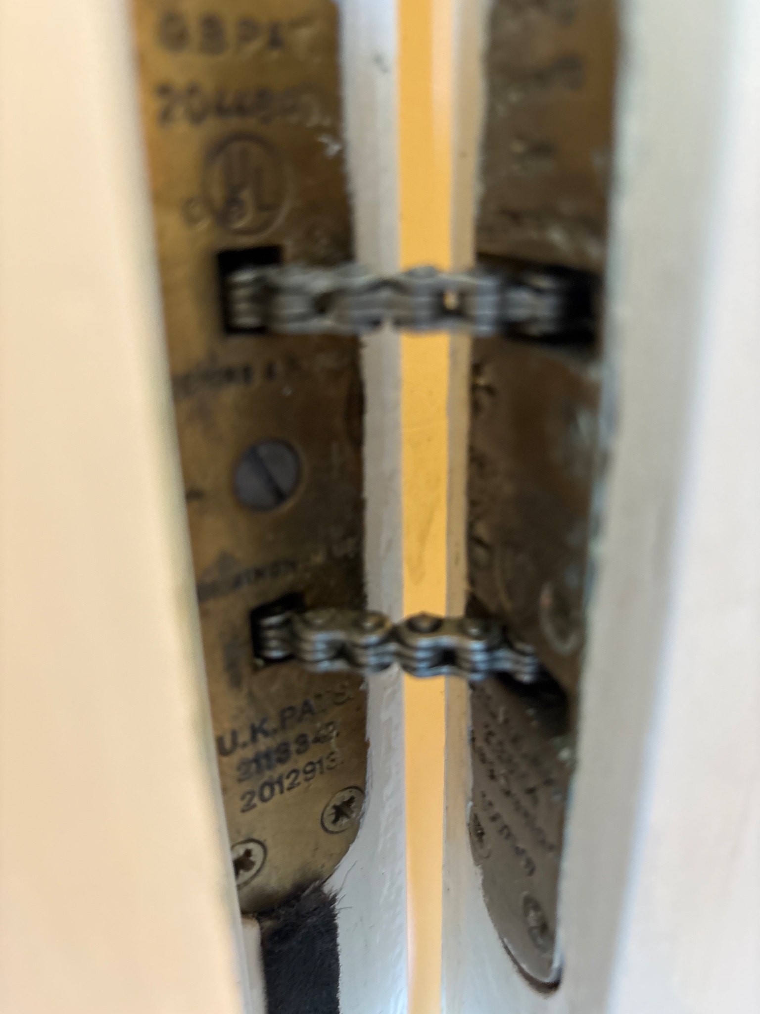

Hi
We have a concealed door closer on our flat front door, which is a fire door, necessarily. However, the door is not completely closing 100% of the time.
Is it possible to adjust the closer, if so, how?
Always grateful for any advice offered. Thanks.
On single chain closer which you don't have you jam open with the metal slotted plate placed behind a chain link.
Unscrew door side.
Turn to tighten or slacken.
Screw back on..
That one with double chian I'll guess you turn slotted centre screw.
I assume you need two chain jamming plates to get mechanism off though.
