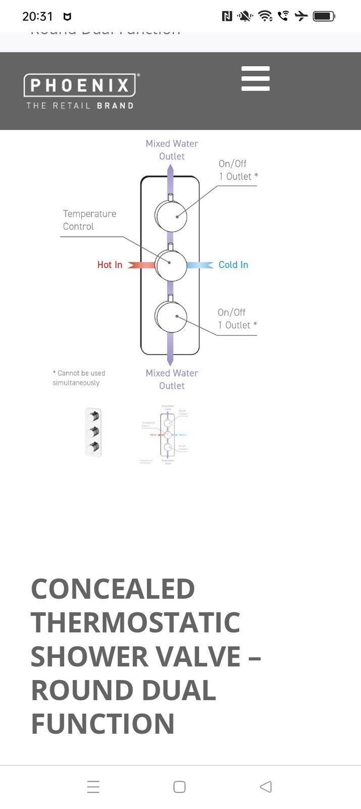

Is this usually the cartridge on the temperature dial? Does it just stop letting hot water through? Thanks
Check the head or hose isn’t causing a restriction then, if not likely the cartridge. Could also be a failed check valve.
That's the style of shower so they usually have check valves on the hot side? Or must likely the cartridge?
Guess there is no easy way of checking the check valve? Just trying to avoid swapping the cartridge if it's not this.
