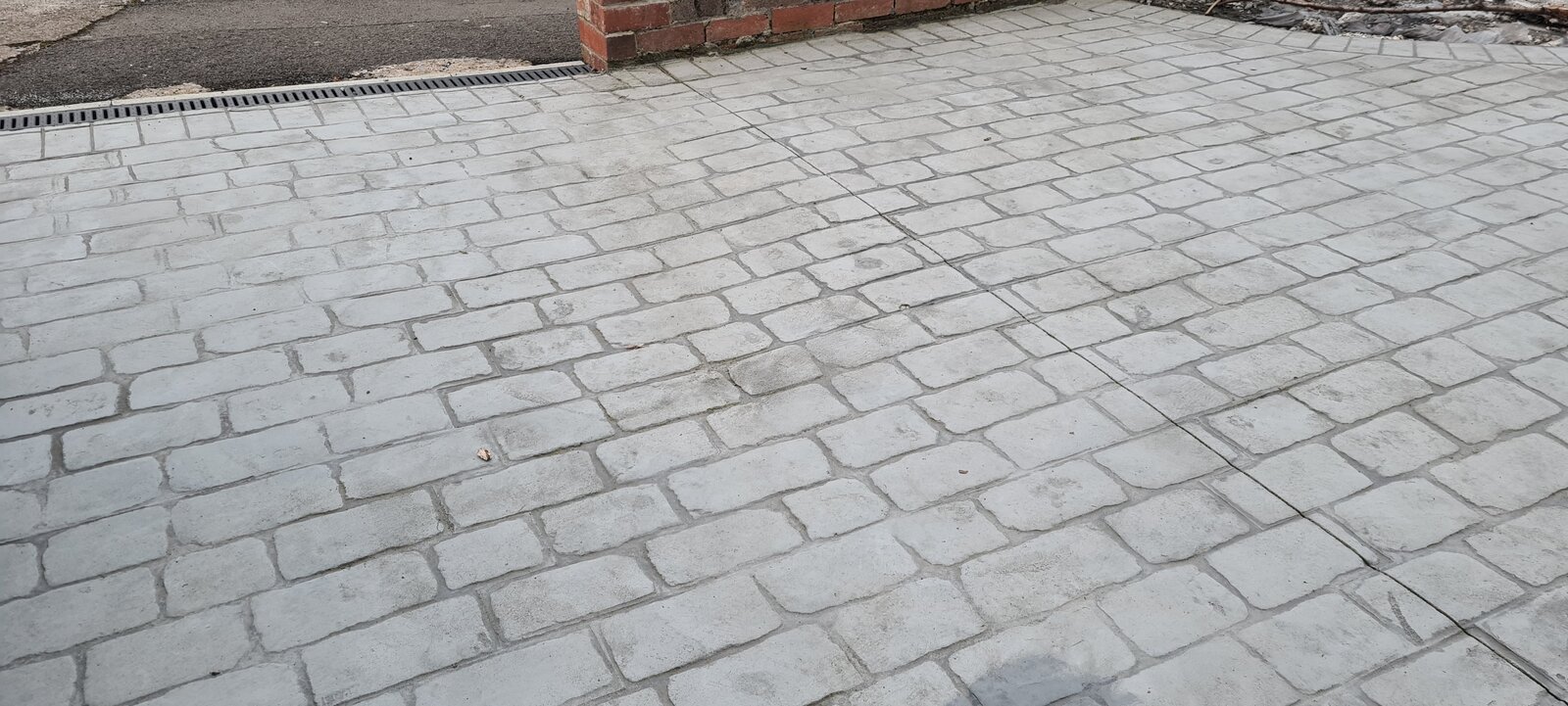

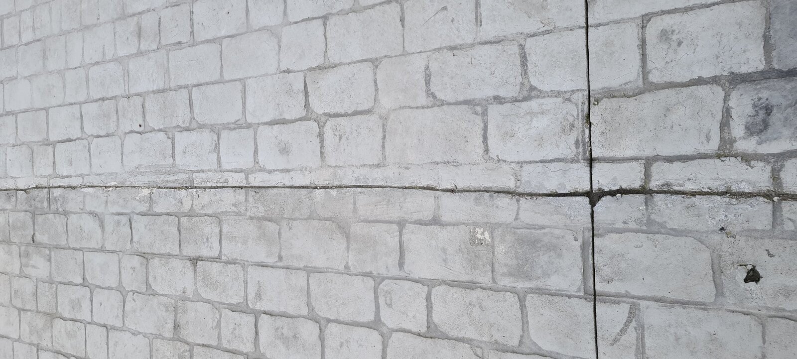

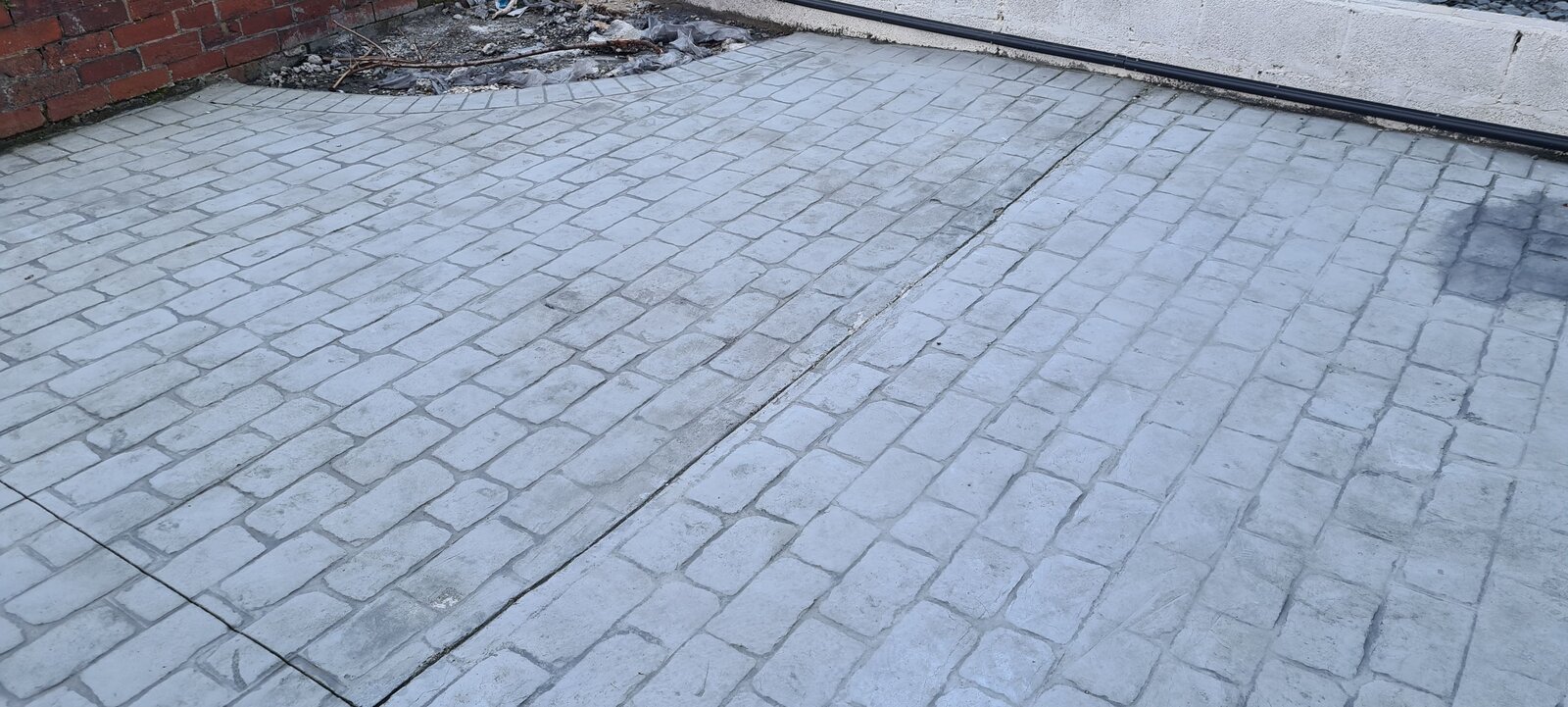

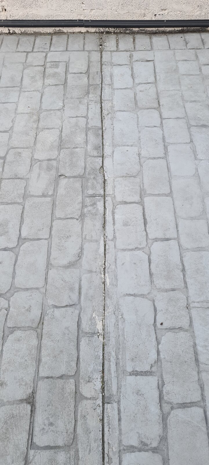

This was the state of the drive in the photos - it was really bad with trowel marks all over it, in places where there was no imprint etc we also had a horrible crack where he poured two different concrete lorrys mix too. Thats the really rough one going accross the drive (its unsealed here btw as you can see he tried a few test patches to see if the sealer would help things). I told him not to bother sealing as it was a mess and needed to be re-done.

to be honest, it's doesn't look great. Straight away, there's dry joints (perps/vertical brickwork joints above one another) going on, so it makes the pattern look dreadful. If you were wanting a brick effect, block paving was the answer.
I cant ever see him getting compensation from a concrete company, ever. Did he specify a concrete mix design for the concrete? Did he sign the delivery ticket confirming the load was acceptable against his order? Has he any proof the concrete is defective or against specification, below strength, any defects specifically relating to the composition and mix, rather than workmanship, weather, finishing etc etc
Looks to me like nothing to do with the concrete itself rather the placement and finishing
Any concrete company will have 100 and 1 ways to get out of paying any compensation. Thats just a loads of lies.
I only wonder why he bothered to rip it all up - probably so you had no remaining evidence of his wrong doing! Probably cost him a day to rip up all the evidence of his poor work and wont ever see him again, or this "compensation" from a ready mix firm
