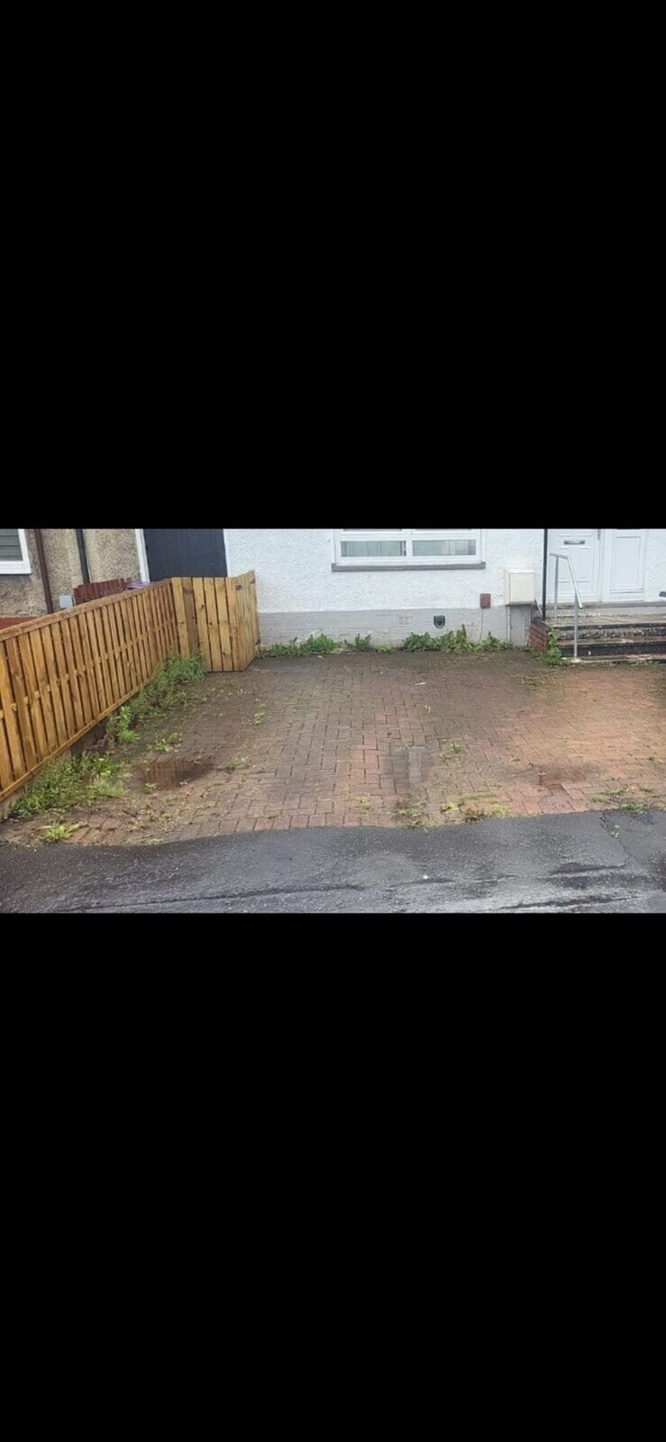

The new guy from today said this. What are peoples thoughts?
(1) driveway will be flat with a fall to pavement for all surface water
(2) If there is a drain that is accessible, we would install a channel drain and outlet would connect directly in to main drain. As discussed on site, the best option would be to have a fall on the driveway for all surface water to run off onto pavement. This can be discussed in more depth on our second visit.
(3) This can be achievable, no problem
(4) We recommend tarmac driveways to be 100mm thick 60mm base and 40mm finish
(5) we would be using permeable tarmac which allows water to drain through naturally
(6) we excavate driveways to 250mm - 300mm
From finish hight. This will allow for a minimum of 150mm of type one build up base and allow 100mm of tarmac. If subsoil is really soft we sometimes excavate more than 300mm and install a geogrid menbrain for added stability.
Where will the permeable tarmac drain to? You will have problems if it's not to a soak away or a drain
I'm in Scotland and found this.
3:6:3
Still not clear if he can do this.
He said that in this area it is mainly all clay under the driveways so the soak-a-way will just fill with water like a bath and there is no drainage at the front of the house or even drain pipes on the front of the house so he can't use a drain. So his only suggestion was to create a fall so any rain water that doesn't seep into the permeable tarmac will drain into the street into the drain in road??
What do you think?

Thanks. I can't figure out based on skipping though the Scotland legislation if it is or isn't permissable to run surface water off a driveway onto a public path/road? Can you?
Can you think of any other options to get rid of surface water?

I emailed the local council and asked them about if the driveway has a fall onto the public footpath for the rainwater to drain off that does not drain through the tarmac and this is what they said. Under my driveway it's all clay so a soak-a-way wouldn't work and there's no other options for drainage other than a fall. So can I ask what others would do in my situation? Here's council's response.
This is not something cover buy building standards in relation to drainage on to public paths and roads most local authorities do not allow it however it is not enforced buy building standards

It seems a grey area about the running off of the rainwater onto the public path and road here in Scotland. I am seeking futher clarification from the local council first, but seems such a grey area that doubt I'd get a clear answer and seems like it is not really enforced even if a driveway is on a fall for rainwater into a public path.
Yes I have been assured it's a permeable tarmac.
Around here, you are allowed to replace/repair a none permeable, draining out the path/road, with the same. If you make a new drive, then it has to either be permeable, or have drains added to catch the run-off. Some use Aco type drains, often leading to a soak-away. On heavy clay, as we are, soak-aways are not very effective.
