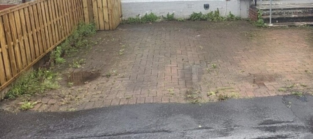

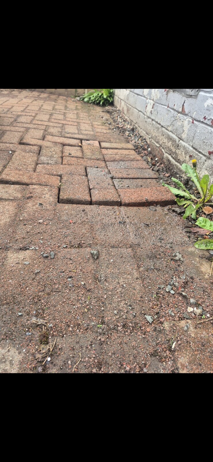

Very annoying as one of the guys who was going to do the driveway he said he needed to check under driveway to know how best to do it. So in 3 places he dug up like 7 or 8 mono blocks and either didn't put them back or didn't put them back properly. Then I asked him if he could give me a receipt at the end and that was all. He then sent a message saying he is too ill to do anymore driveways.
I ask him if his guys who dug up the driveway could please pop them back level how they were but ofcourse he has ignored my call and texts. Mrs is not happy :(

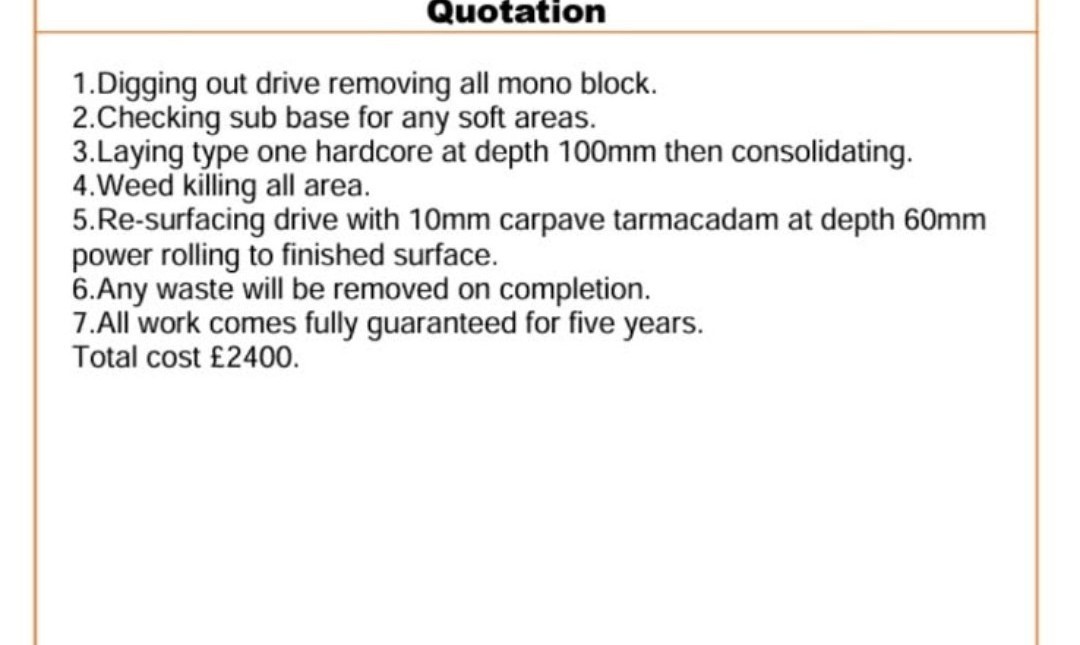

The quote I got from a company a few weeks ago was this below:
He said I would get a receipt and 5 year guarantee not insurance backed. He said price doesn't include VAT as he's a sole trader. Not sure if he has PL insurance but don't want to ask.

Does he know how to lay resin drives?
They should be laid on top of a firm base such as concrete, tarmac or asphalt, not straight on to stone
Doesnt sound like he does from the quote. Plus to quote £12,850 + VAT ???
What I dont understand is how the other quotes I got were all between 3k - 4k and his 12k plus???
