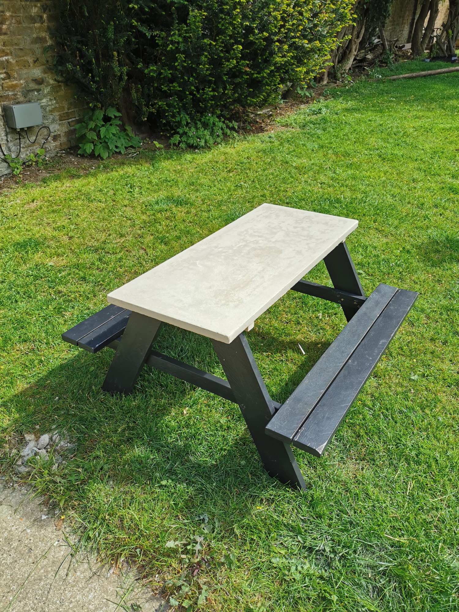

I did something like that. I used a mix of 2:1 sand to cement (snowcrete), reinforced with approx. 5% glass fibre. That turned it from a sloppy mortar mix into a weird unappetising spaghetti dish.
The sand was a vibrant yellow so the effect is creamy rather than white, you'd need dye (or white sand?) to get a good white shade.
Mine was a sub-scale demonstrator before I got round to doing a full sized table. It made an excellent child's picnic bench though.
The odd patina on the top is due to an attempt to seal the concrete, which I don't think I got right.

Made in the mould. Melanie cast with silicone around the corners to give a rounded corner edge finish. I applied 'face' coat applied by hand then the fibre reinforced mix layered in afterwards. Despite my efforts one or two fibres did poke out the top which let the look down a bit, but plucking them out sorted it.
The underside is very rough, you'd struggle to get a nice finish with the fibres, although if you're tiling the top it's irrelevant. Happy to share additional details but I don't think I can claim it's the right way to do it yet. It'll need more time to prove that.
PM away, but I'm happy to dump and details on this thread for posterity.
