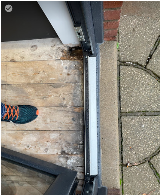

It seems the concrete step is leeching water through from outside to inside and part of it is in contact with the floorboards, they are rotten and will be replaced
The step starts outside and continues inside under the floorboardS
(so the part of the concrete step on the inside is wet)
How can I stop this, new rear kitchen door recently fitted (the old door was visibly leaking)
I was going to coat the outside of the step in thompsons water seal and put a dpm over the inside portion before replacing the rotten parts of the board.
would that work?

Are you sure it’s not damage from the old door?
I’d take some of the floorboards up first and then take some pictures and post here, it could be damp from a wet ledger joist and/or from the door.
There could be condensation from the step too.
Sort the problem, not try to cover it...

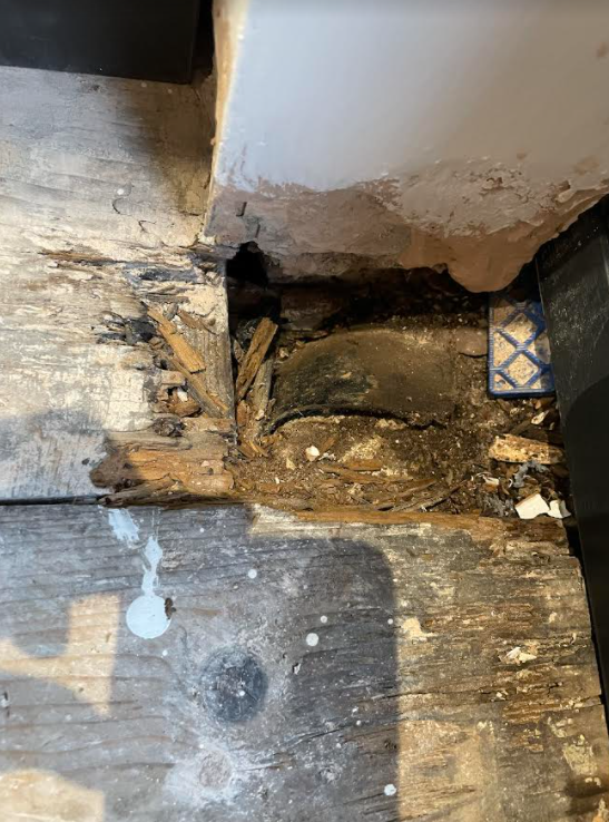

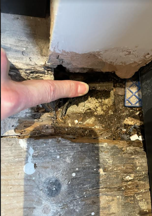

Thank you, there appears to be dpm over part of it but not all, the concrete dried out after door fitting a week ago but is now wet again inside, but once kitchen finished Ill take up and post photos of whats underneath thanks, in meantime
where floorboards meet door inside with concrete step underneath
,second photo shows me liftin what I think may be dpm (Im learning new words every day, i try and google first but then come here)

Although it’s a suspended floor there doesn’t seem to be much air space to the ground (unless it’s difficult to see on the photo).
Looking at it the current floorboards are they sitting on the step or is there a piece of wood underneath them?
it won’t be a big problem to fix.

Yeah there is a fair bit of space apart from where the backside of the step intrudes into the floor, which is what your looking at where my finger is.
The floorboards are resting directly on top of this, there is no other wood underneath it, just part dpm (again where my finger is).
