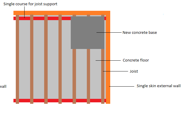

Hi,
I have a washing machine that bounces around. I've tried many ways to remove the bounce from the floor, but failed. I've given up on damping, supporting the floor, cross members for the joists, sistering the joists.
I want to build a concrete platform for it to sit on.
The room is an single skin brick extension. With a concrete base, wooden joists are supported by a single course of bricks on one end and span the full width of the room to sit on top of another single course of bricks. Chipboard is screwed to the joists as floorboard.
If I were to make some kind of base in the corner for the washer to sit on (see diagram), can I just pour concrete in a form and make it level with the top of where the chipboard is now?
1.
What mix would I have to use? The depth of the pad will be about 225mm.
2.
I plan on leaving a small - say 50mm gap between the base and the two walls so not to interfere with the damp course. Is that sensible?
3.
I presume I can pour straight on to the concrete floor?
4.
Should I pour the concrete so that it is top-of-floorboard level, or leave enough to add chipboard as floorboard?
Any help or advice would be appreciated.

When we say level, it has to have the same weight on each foot so it can't move. But it sounds like you've tried everything else.
Regarding the concrete base, just put a damp proof course in there somewhere and allow air flow around it. Don't let it touch any timbers under the floor if possible. You can save on concrete by building it up with bricks most of the way.
Having said that we had an old broken up hearth covered in mortar in our kitchen, covering and touching loads of timber, no dpc, next to a leaky chimney, and everything was bone dry. So anything can happen.
It looks from your original post that you didn't try making a new sleeper wall under the machine, might be simpler than a whole pad, and much stiffer than trying to strengthen the joists.
Hi,
I did support under the joist with wood, not brick though. I made it as tight a fit as I could. Forgot to mention that.
What ratio of sand/cement/ballast should I use? I'm no builder.. I've built bases for sheds, but that's my limit so far.
Dave.
I usual just Google for concrete mixes tbh or read the back of the pack. Off the top of my head I'd probably bed the bricks on 4 to 1 mortar with sharp sand, then damp proof course, then another row or two of bricks, then fill up the rest with the same, then cover it for a few days to keep it damp. If you're mixing by hand with a shovel the bricks will save a lot of effort.
