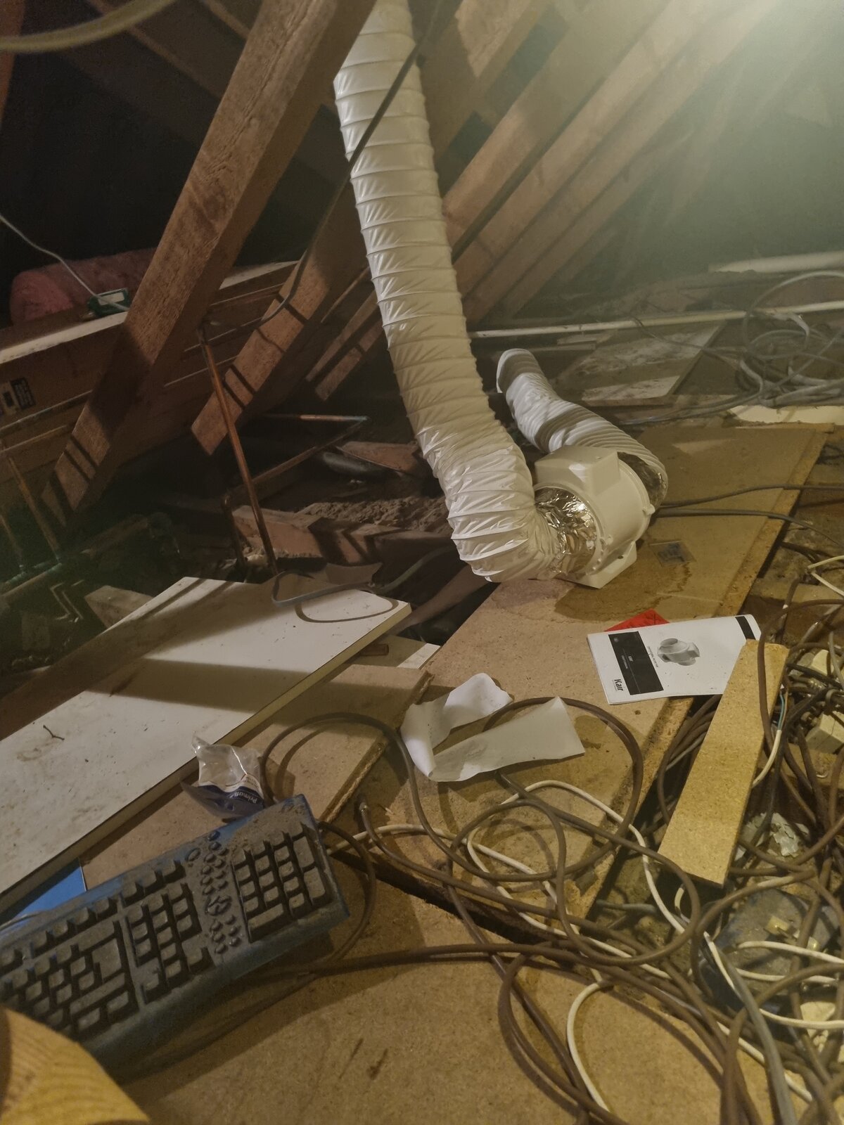

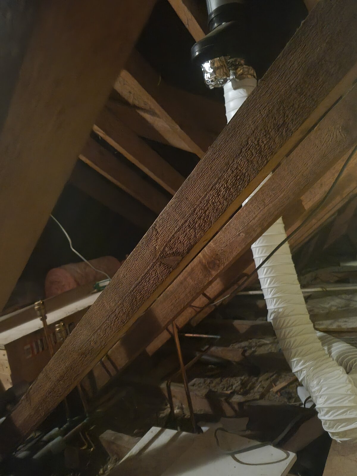

Had a new bathroom a few months ago and had poor performance from shower extractor.
Took a look in loft and it is a bad install ductwork is badly done into vertical extraction and no codensate trap. Moved the ductwork can hear water in there. What do i need to do/buy to rectify?

Not the worst I’ve ever seen, but I’d re-do it properly.
Ideally use rigid ducting, with a constant upward gradient. Then any condensation would run back to the shower. If you fitted a condensate trap, where would you drain it to?
It should probably be insulated.
(Is that a boiler terminal in the roof that it’s connected to?It seems to have a taped-off second connection.)
Hose looks far too long , shorter the better .Insulated hose reduces condensation .
Vertical vents are NEVER a good idea, especially that long
