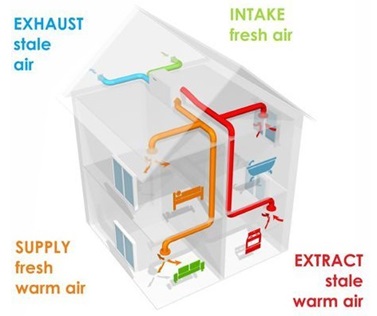

MHVR systems are more expensive but provide a better solution as they control where the air enters and exits the building and also provide heat recovery.
