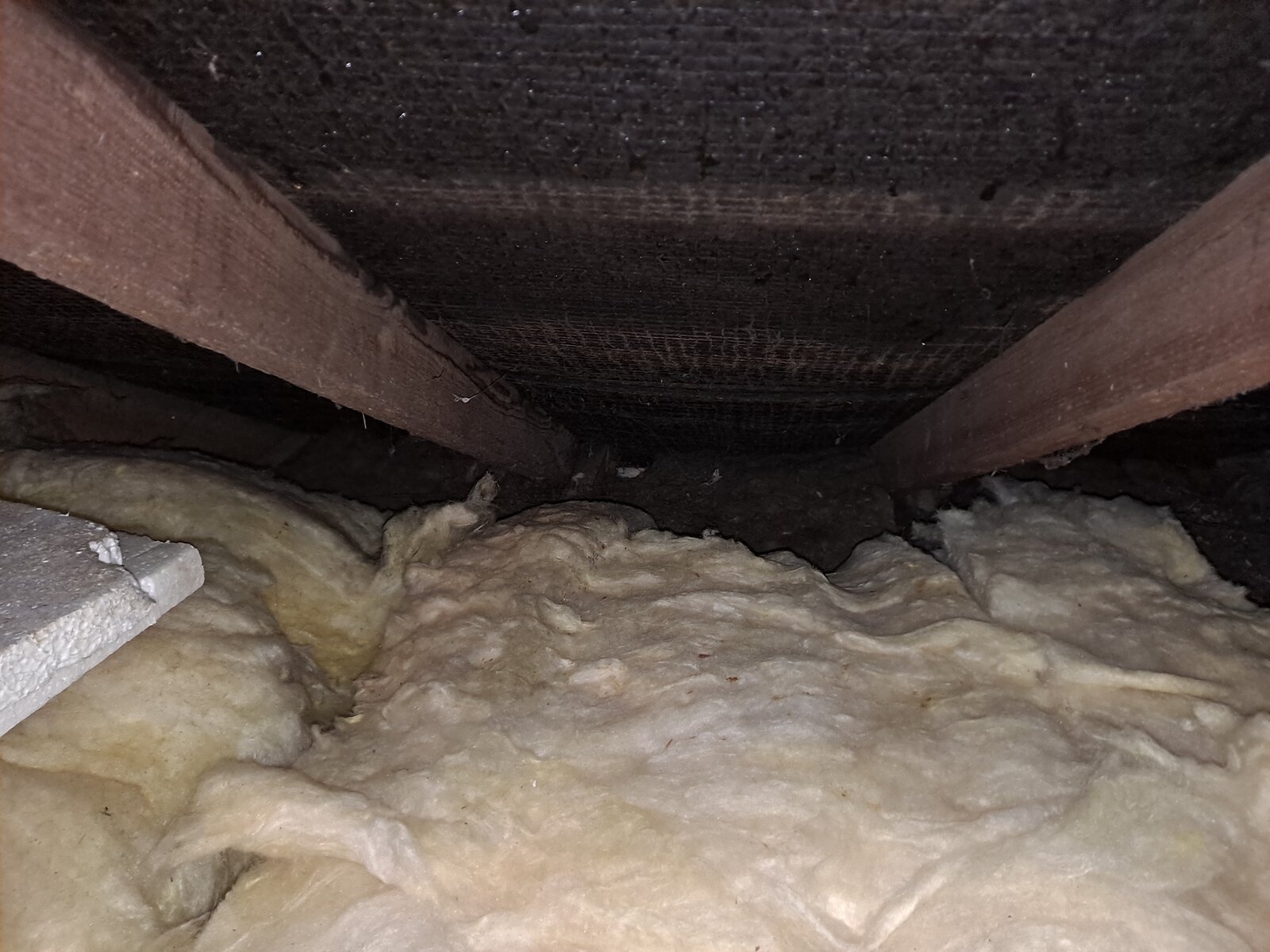

Hi, a couple of years ago I had an issue with condensation in the loft. We fixed the problem by installing felt lap vents: https://www.amazon.co.uk/dp/B00M9ILJPG/ref=cm_sw_r_u_apa_fabc_0bMYFbF6HRYMA?_encoding=UTF8&psc=1
I have just been into the loft and was greeted by condensation (not as bad as a couple of years ago but still pretty bad).
I fitted a new airtight loft hatch and a nuaire drimaster heat PIV unit this year which has been brilliant at preventing condensation in the rest of the house, but could this be the reason for it returning in the loft?
We are due to have a new heating system fitted in January do you think that will make the condensation worse as hopefully the house will be hotter than it currently is?

We have followed a lot of these pointers over the last couple of years and seemed to have had some success.
I was just shocked to find condensation this year as the only thing I can think that has changed since last year was fitting the PIV unit, so was just curious on peoples thoughts as to whether the unit is possibly to blame?

May be worth thinking about the number of vents you have in place now. As apposed to the volume of loft space you are venting?
One way ahead?? install more vents?

If you have these "peripheral strip vents" a quick fix is to ensure that the installers who "placed ??" the insulation in the roof space did not jamb the insulation into the eaves?
These guys simply do not have a clue at times, they shove the glass wool right into the eaves, I asked one guy and he was trying to stop the draughts meant to vent the roof from making the house colder?? a reasonable rational there somewhere ??
bottom line is that if the eaves are stuffed full, asimple fix would be to remove this areas insulation??

That is a good point, I did pull all the insulation back from the eaves a coupe of years ago but only in about a third of the loft space, the water tank prevents access to the rest of the loft.
We are having a combi boiler fitted in January though so as soon as the tanks are removed I will go along the rest of the loft pulling back the insulation.
Hopefully that will be enough to prevent the condensation this winter.

So just had another look, and even though I pulled all the new insulation back i never pulled back the old brown insulation that is underneath, I'm hoping if I pull all that back it may help further with the condensation.
I guess you should be able to see the white of the eaves all the way along the inside of the loft?
Stotty, good evening again.
In effect yes, clear all the older insulation out, if you have perimeter vents, what you are looking for is daylight when you are in the loft and looking at the eaves. A lot of lofts I have been in they are positively draughty.

you can trim it with a big pair of wallpapering scissors, then it won't flop back.
start by opening up a few on each side so you get a through draught. The loft should feel dry, cold and draughty

Thank you, I could see daylight in some areas, I will go around moving all the old stuff way back until daylight is visible all round.
