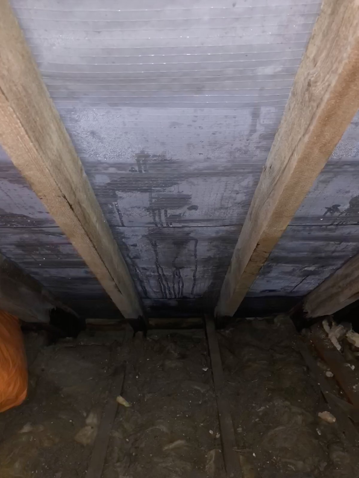

I don't think there is enough ventilation up there, and there is a fair amount of white mould on the wood. The condensation was terrible when it was there (this coincided with having a very full house over Christmas).
The reason I noticed the condensation was because I wanted to (and since have done) fit a Nuaire Drimaster to sort condensation and poor ventilation in the house. Before installing it, I found lots of unexpected condensation on the undersarking. To address this I fitted 10 x Lap vents but in doing so noticed that the overlaps in the undersarking are quite large and not all the vents separate the entire overlap - so they probably aren't as effective as I want them to be.
Since doing that though, the loft does seem to have dried out but I'm still concerned there isn't enough air flow up there especially with the Drimaster in place.

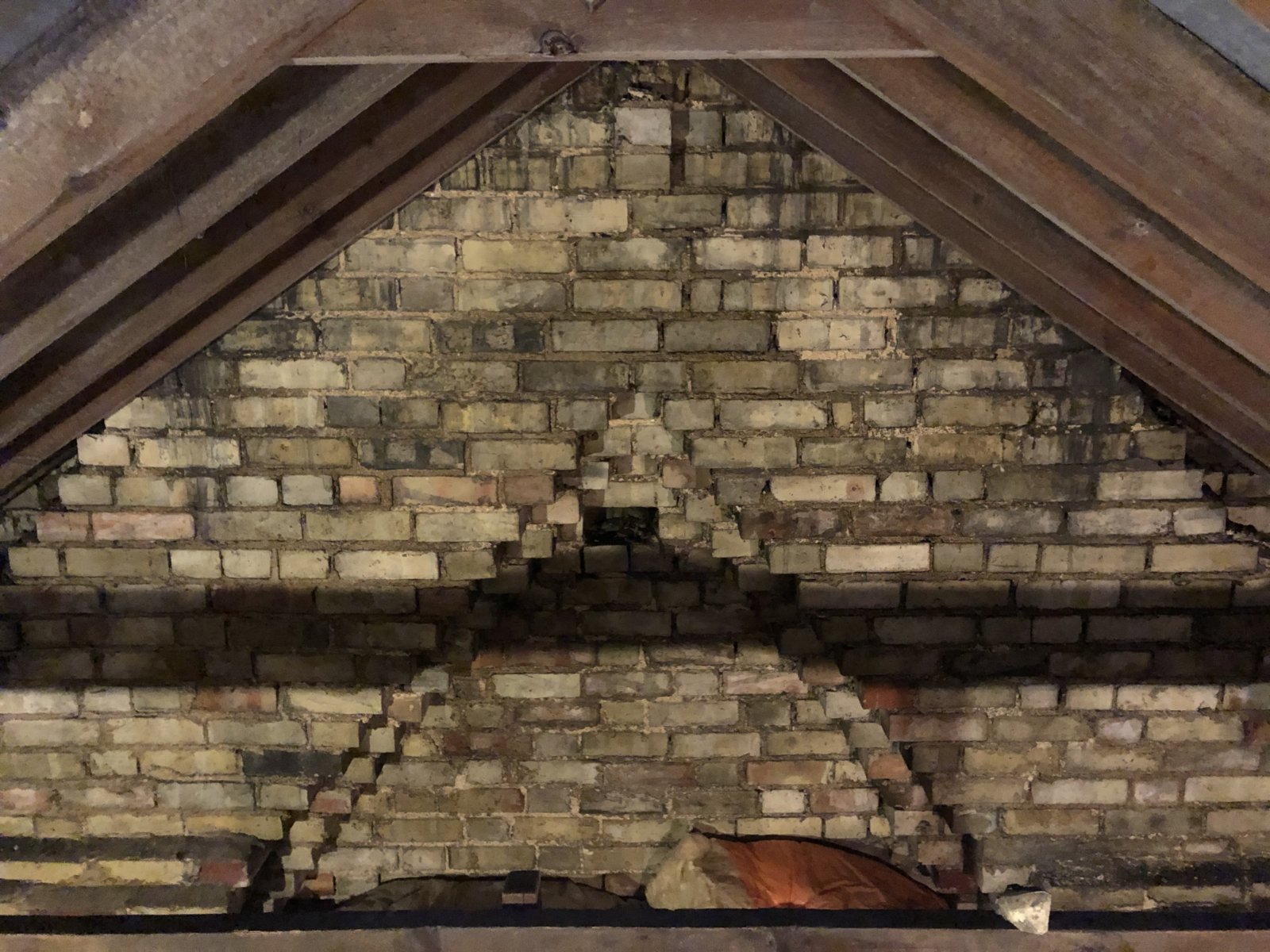

2) Fit an air brick in the gable end (there is a loose brick already between the chimney breasts, about halfway up the gable end)

In terms of easiest first - what can I do myself? I could probably knock out the single brick and put in an air brick, but that is quite low in the gable end and probably wouldn't be compatible with a loft conversion and would only be one side.

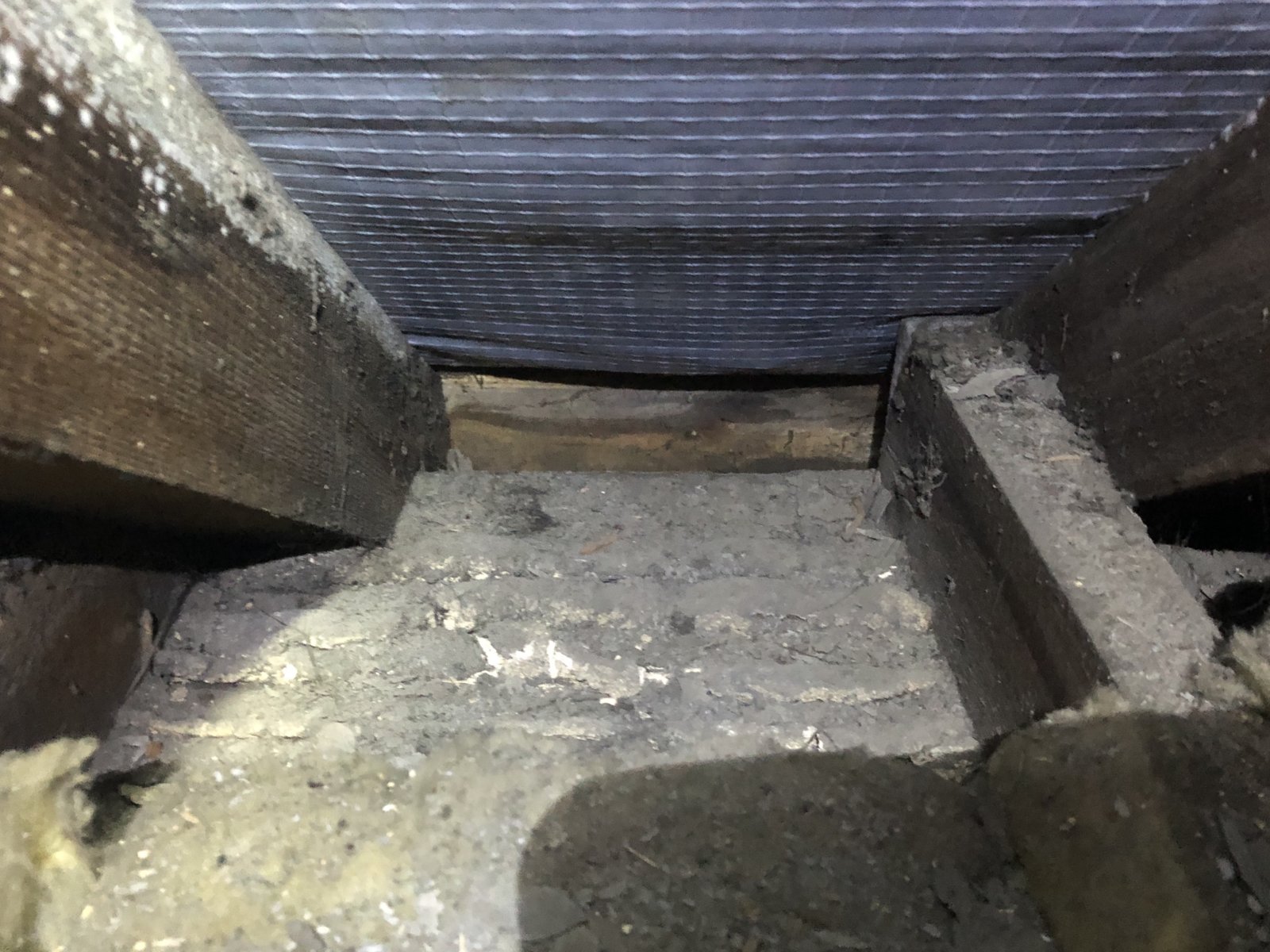

can you photograph the eaves (with the insulation pulled back)?
That's true. I couldn't just wedge a plastic one in there?
Photos of loft attached - would be really grateful to hear what you think.
T

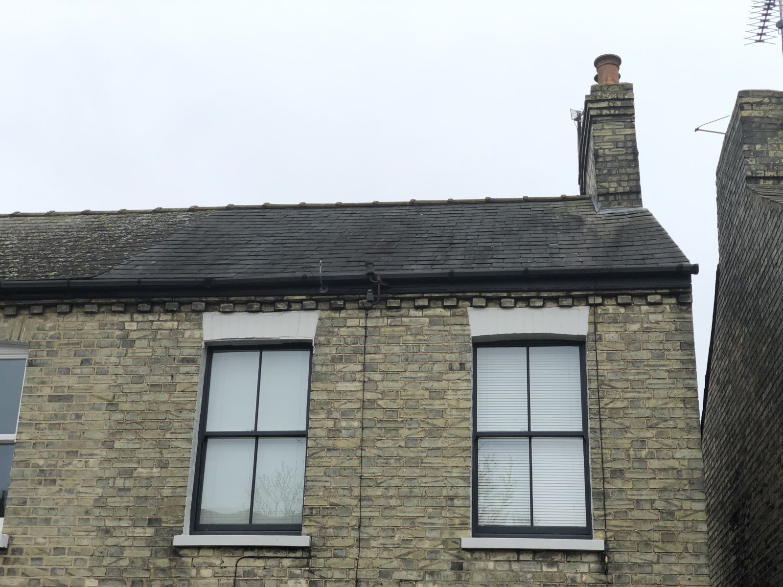

Also pictures from outside the house to get an idea of what the eaves/roof looks
like...

I'm a bit surprised there is no visible gap at the eaves. Must be a different style of construction from what I'm used to. I'm sure you could bore some big ventilation holes, but someone more familiar with your roof will know better.

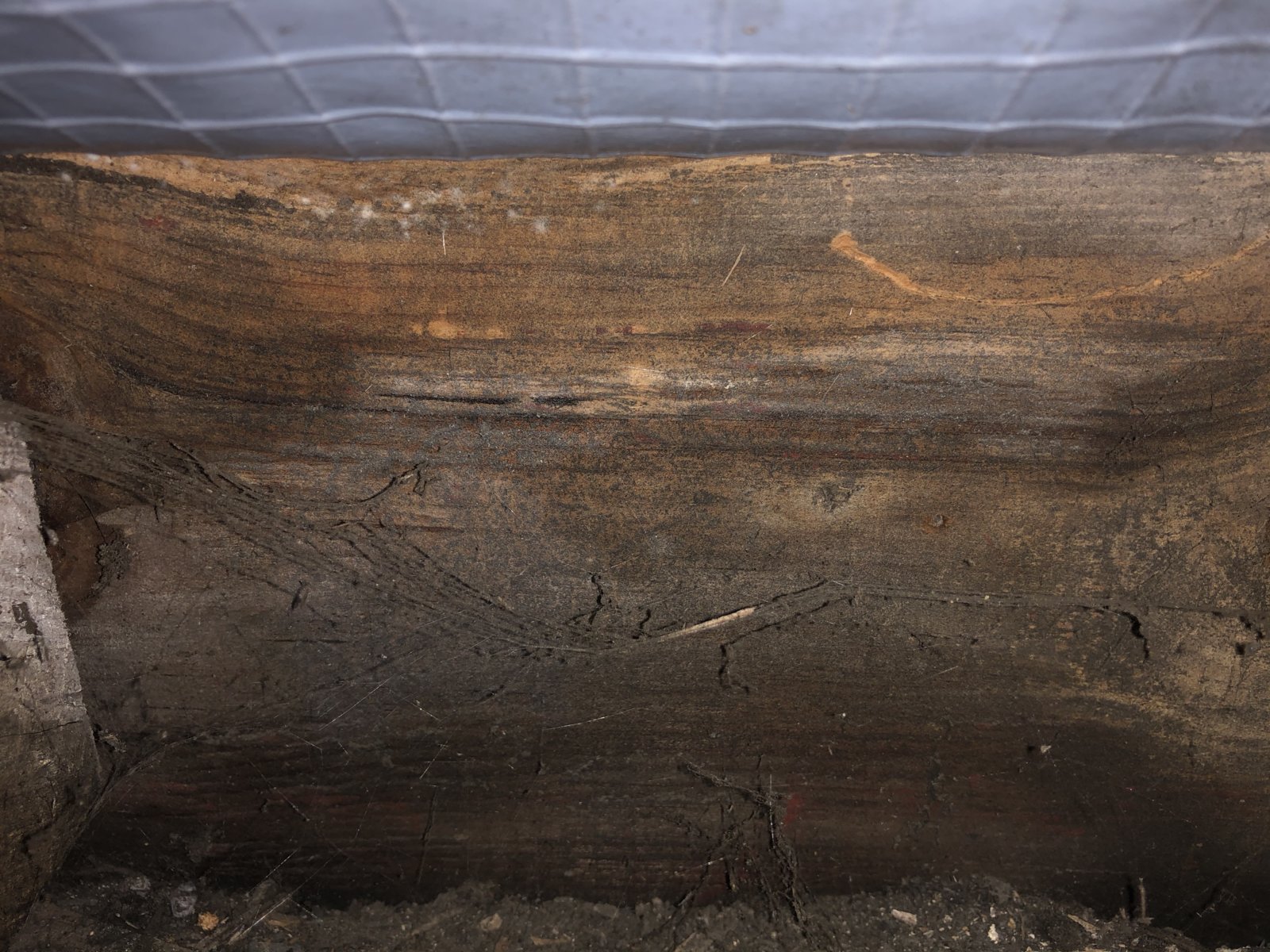

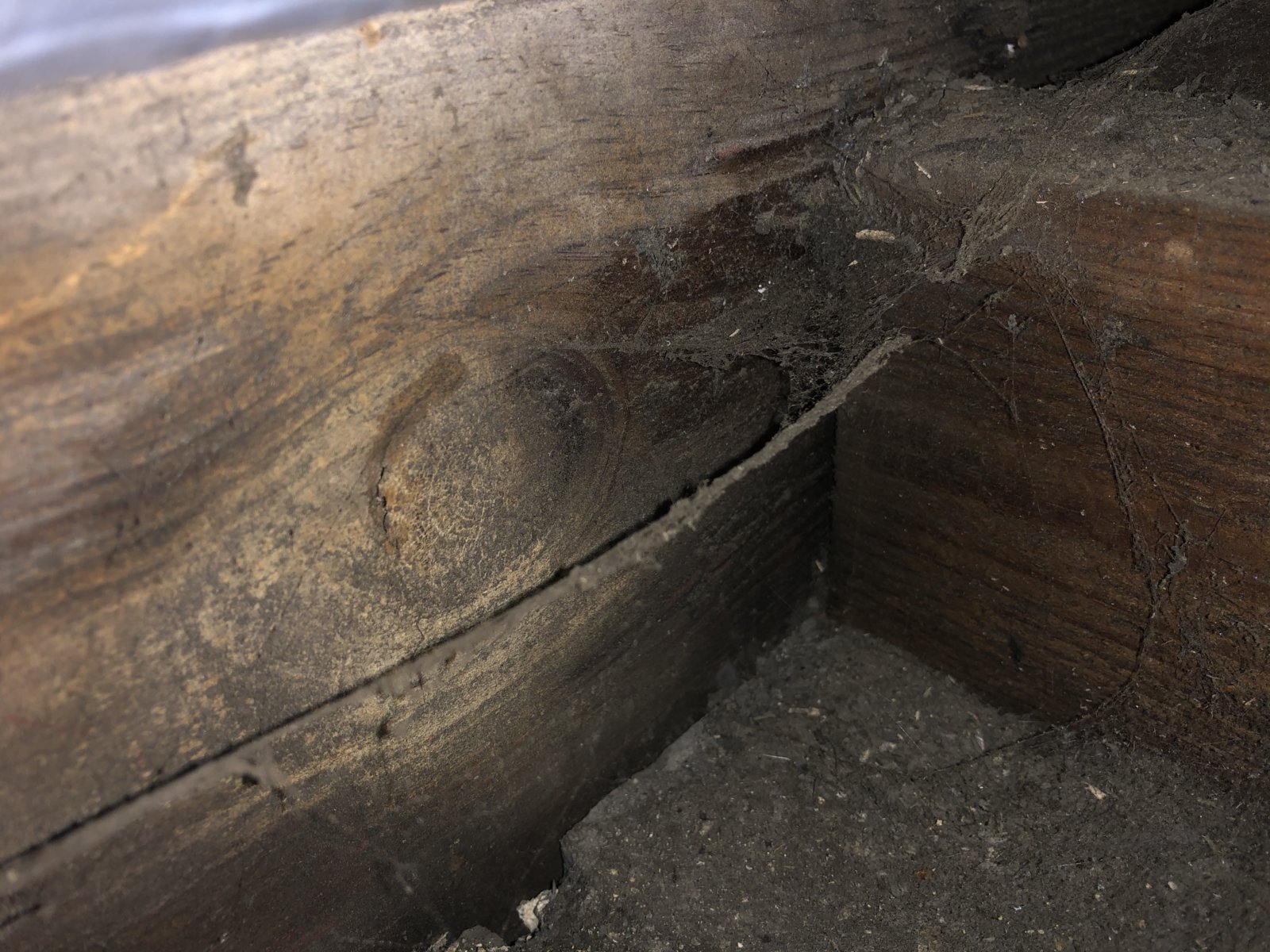

Some of those timbers look to me as if they have been badly wet. Prod them with a flat screwdriver to check that they are sound (not with a round or pointed prodder as the marks will look like wormholes)
Taking out that loose brick would help, but you need to prevent rain or wildlife getting in. A plastic airbrick may fit.
Nice brickwork, good windows.

Worrying that you mention about the wood looking very wet. I'll get up there and poke it. Just looking to see if it's soft, right?
Regarding the air brick- I don't think that one (visible in the photo of the gable) is loose as such, but it does seem to be a single brick only between inside and outside. Hopefully if I make a neat enough hole, I can just push a plastic brick in from inside to out. Probably not best practice but what can I do.
Ventilating the eaves seems like the best thing though, as that would have to happen with a loft conversion as well. Any idea how to do that? Or what to put in the hole to make sure it doesn't leak?

airbricks most often go under the floor where a bit of rain penetration won't do much harm, but in older properties they are often laid on a piece of slate, which is waterproof, preventing the immediate bricks getting saturated. You could line the "bed" of your hole with some waterproof material,slightly tilted to encourage water to run outwards.
I haven't seen plastic duct in that exact size, but it might exist.

I think as a starting point I'll add a few more LapVents (to make 20 total) and some EasyVents along the ridge (there's a lap in the plastic undersarking right next to the apex of the roof). That should hopefully provide some good in- and outflow of air.

I meant about how to ventilate through the eaves. But you will probably soon also know if they have been affected by water.
An air brick will inly be any use if it is high enough to ventilate the new roof space after conversion. That sort of eaves (fascia on corbel and dentil brick feature) would require over fascia type vents.
