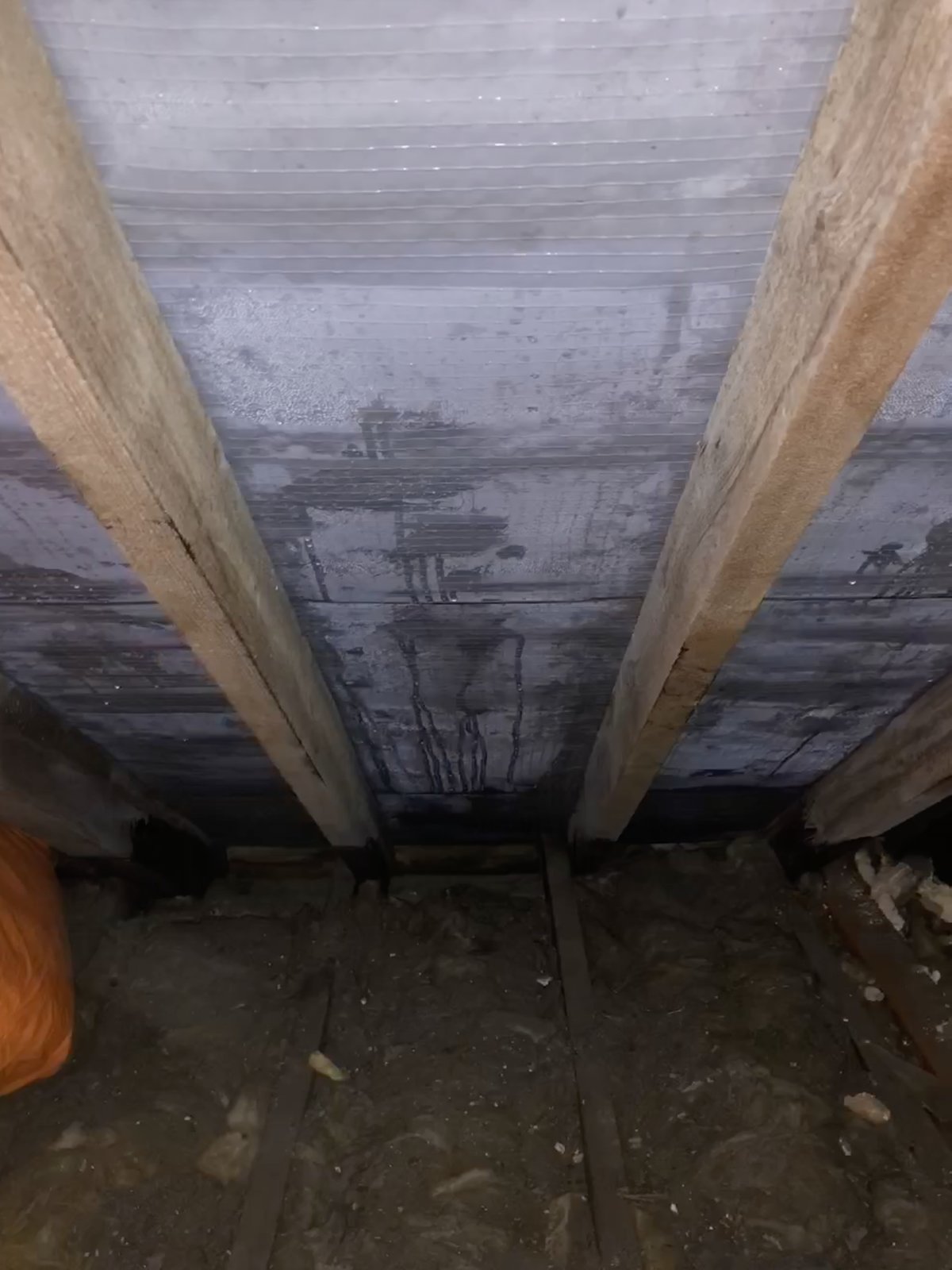

I was referred over here from the loft forum as I'm having trouble ventilating my loft space.

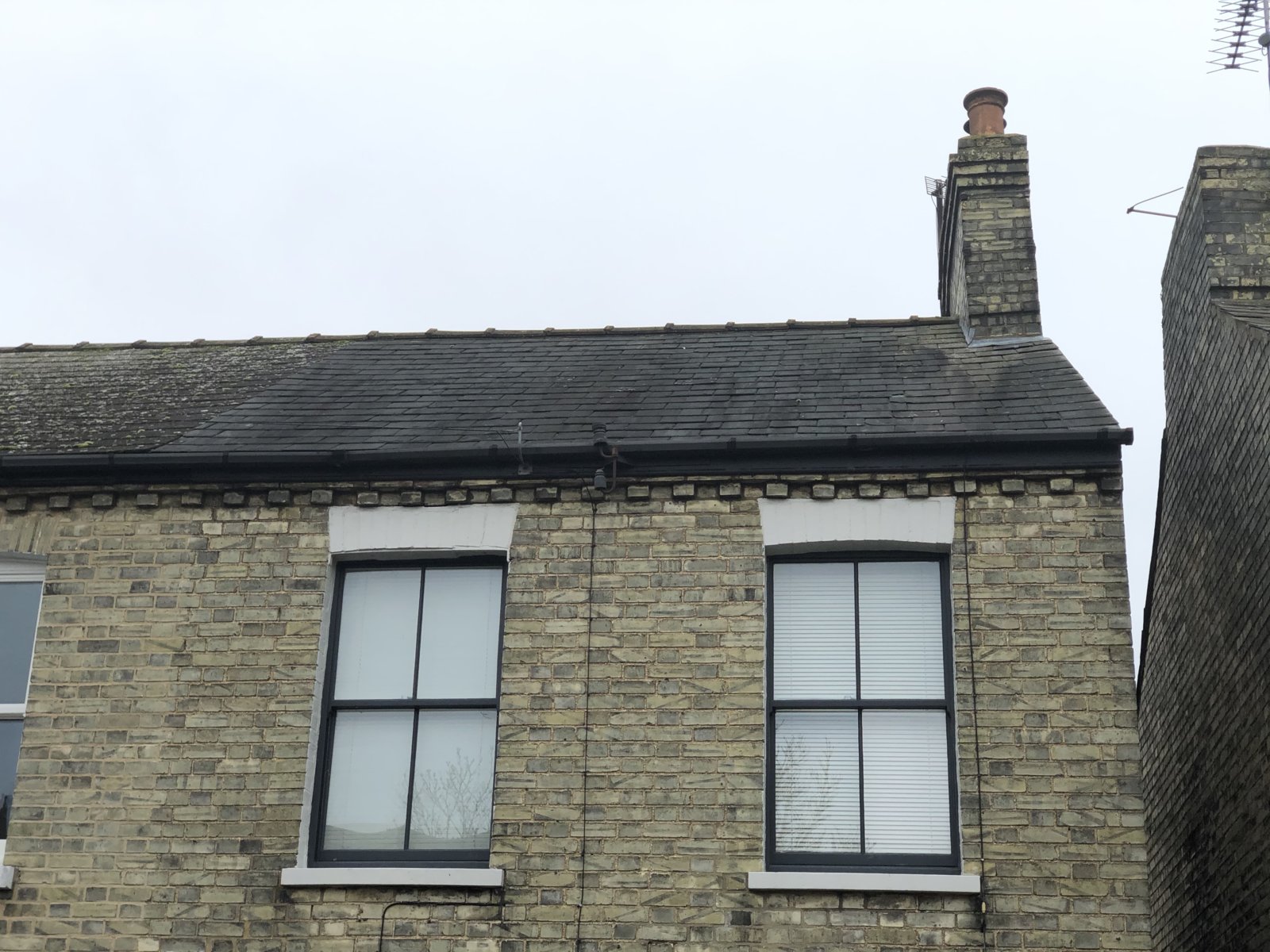

I have a Victorian semi-detached house with a slate roof and impermeable plastic undersarking. There's no obvious ventilation for the loft. One side is a brick gable end with the chimney breasts. There are no soffits and there doesn't appear to be any eave vents either. Theres no daylight coming in around the fascia boards.
There is not enough ventilation up there, and there is a fair amount of white mould on the wood. The condensation was terrible over Christmas, it was almost raining on the inside of the undersarking.
I have fitted 10 x Lap vents to try to improve ventilation but noticed that the overlaps in the undersarking are quite large and not all the vents separate the entire overlap - so they probably aren't as effective as I want them to be.

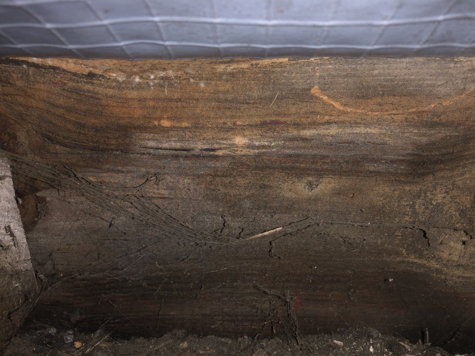

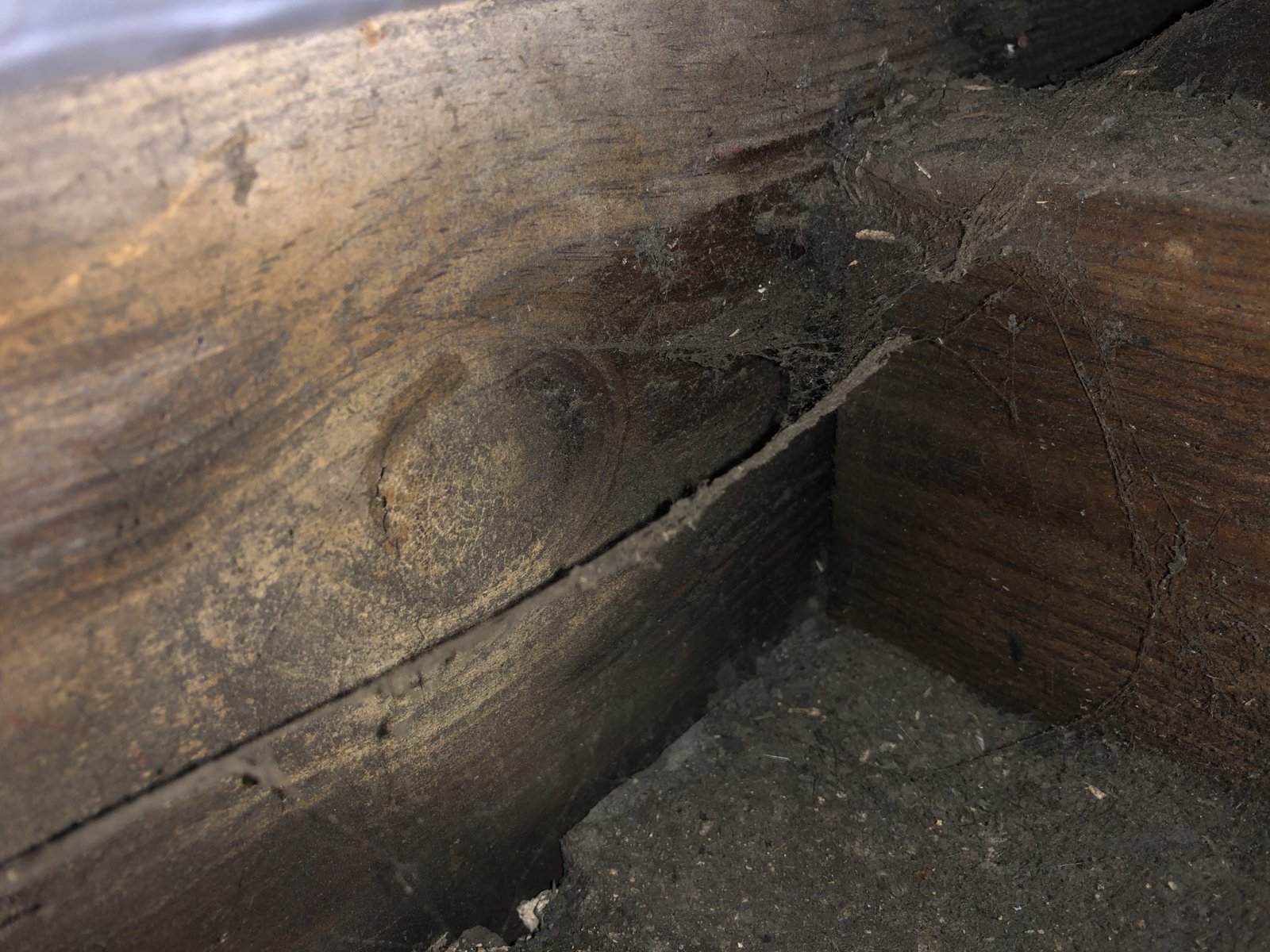

Also JohnD mentioned that the wood looks like it might have been wet - any opinions on that would also be great. I'm hoping they look okay to you all!

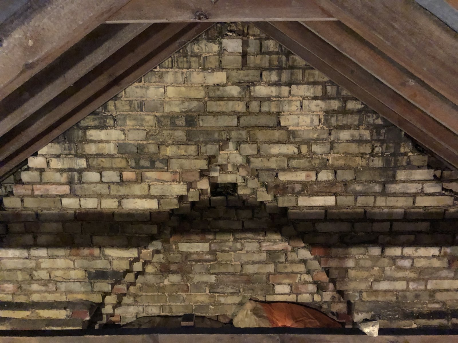

Other than introducing air bricks into the gable end (where possible) your only option is to try and persevere with the lap vents until you can get a roofer to fit cross ventilation via over-fascia vents and ridge vents - but this would involve removing tiles etc.
Is that the back of the fascia I can see in 3rd image?

I could try to put an air brick in the gable end, but that would be just one I think (as there's a point where there's just a single brick. Might not provide much flow. I've ordered some more lapvents to make 20 total.
Yep - 3rd photo is the back of the fascia board. What do you think?
air brick in gable, thru vent slates and up the insulation at ceiling level including the hatch.
if the fascia is not to firmly fixed, then carefully ease it off , cut it down by 40mm and fit over fascia vents, re fit and put the gutter back

You need to stop warm air getting up there to condense in the first place, so insulate the ceiling. Otherwise no ventilation will help.
Next, make some timber wedges, or form some polystyrene blocks and place these in the membrane laps to open them up.

Going by the photo, it looks like you wont be able to fit over-fascia vents without lowering the gutter. Then you need to install what is called rafter roll, to duct air between the membrane and insulation at the eaves.
