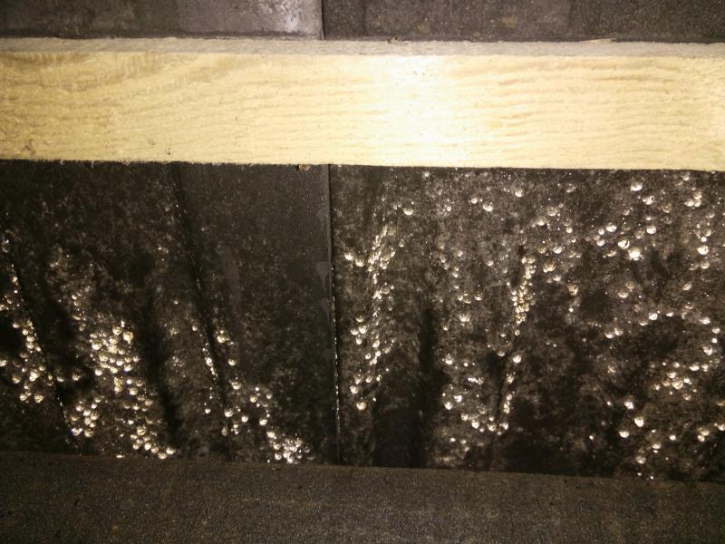

Been in our new house for 4 weeks now. Couple weeks ago I went into loft to fix the TV aerial. I found lots of condensation on the roof felt. Went up again week ago and noticed it wasn't as bad.
I thinking or rather hoping it is because of the warm air circulating since we moved in as the house had been empty, I will start to dry out. Is this a valid possibility?

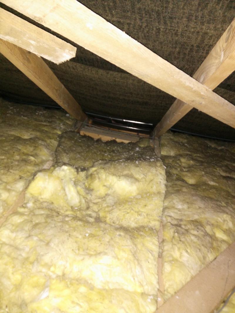

There is not noticeable ventilation. I.e. Airbrick but the soffit does seem to be vented and from photo below you can see daylight so some ventilation much be getting in.

Is wet washing draped around inside your home?
How long is the extractor fan run, during and after each bath and shower?
Are the gaps at the eaves exposed so air can flow (not blocked by insulation)?
How long are the bedroom windows opened each morning?
Thanks for the reply.
No wet washing however we do have a condenser dryer on most days in the utility room. Door kept closed, window open.
No other window open apart from bathroom as the house is quite cold and draughty once heating goes off. In the process of identifying draught spots to fix. Around windows, under window sills etc.
Extractor fan on for 20 mins after shower. Although I now keep window open also.
Not to sure about gap around eves. Difficult to get to. From pic above, in part, the insulation seems for away from eves as other places.
