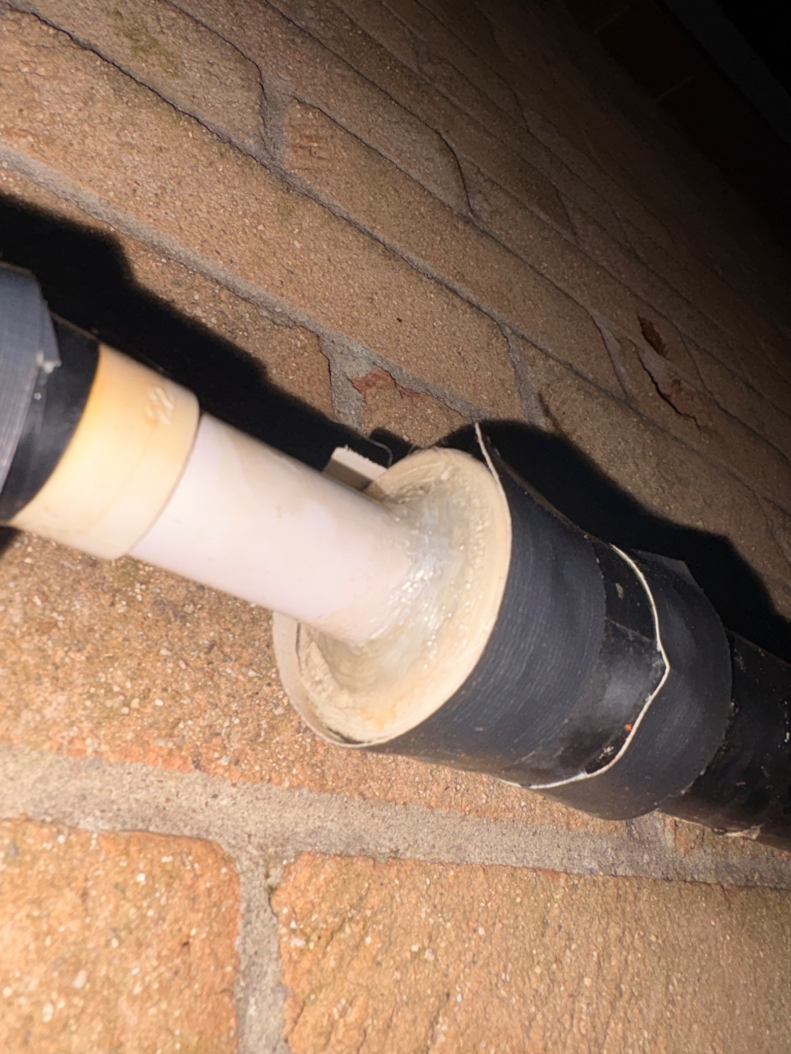

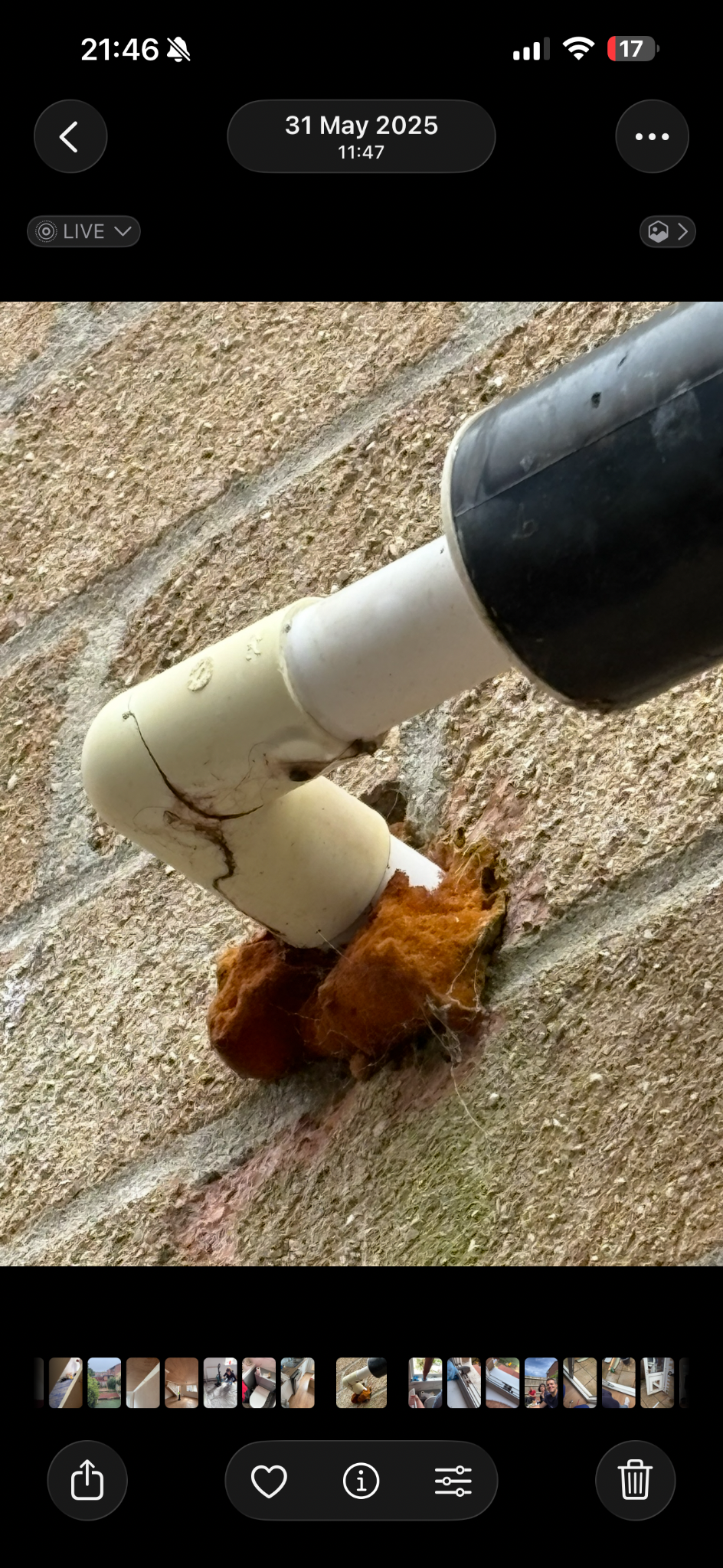

Hi All. I have an external condensation pipe that was leaking in 2 different point. One seemed to be a cracked tube, the other leaking point was where the small pipe goes into the big one. I thought it was very smart to seal the leaking point. Is that correct or water should be let leaked out? I will attach some pictures
In the photo, it looks as if there is a crack in the elbow. That needs to be repaired. Possibly, it has had water backed up in it, has frozen, and split.
It shouldn't need to be sealed into the larger pipe, the larger pipe should be free draining. If not, you need to work out why. Possibly, it is blocked, and water backing up, explains why the elbow has split.
it was just leaking from somewhere on the point where the white tube goes into the black one.
What do u think it would happen in winter if i leave it like that?
How much it would cost to get this sorted?
How cold does it get where you live?
Consider it this way - if it’s going to freeze, it will freeze on the coldest night of the winter … which is exactly when you want the heating to be working.
South UK, Brighton Area. It goes below zero but i understand what u mean. Ill get it sorted soon. In summer it should be okay

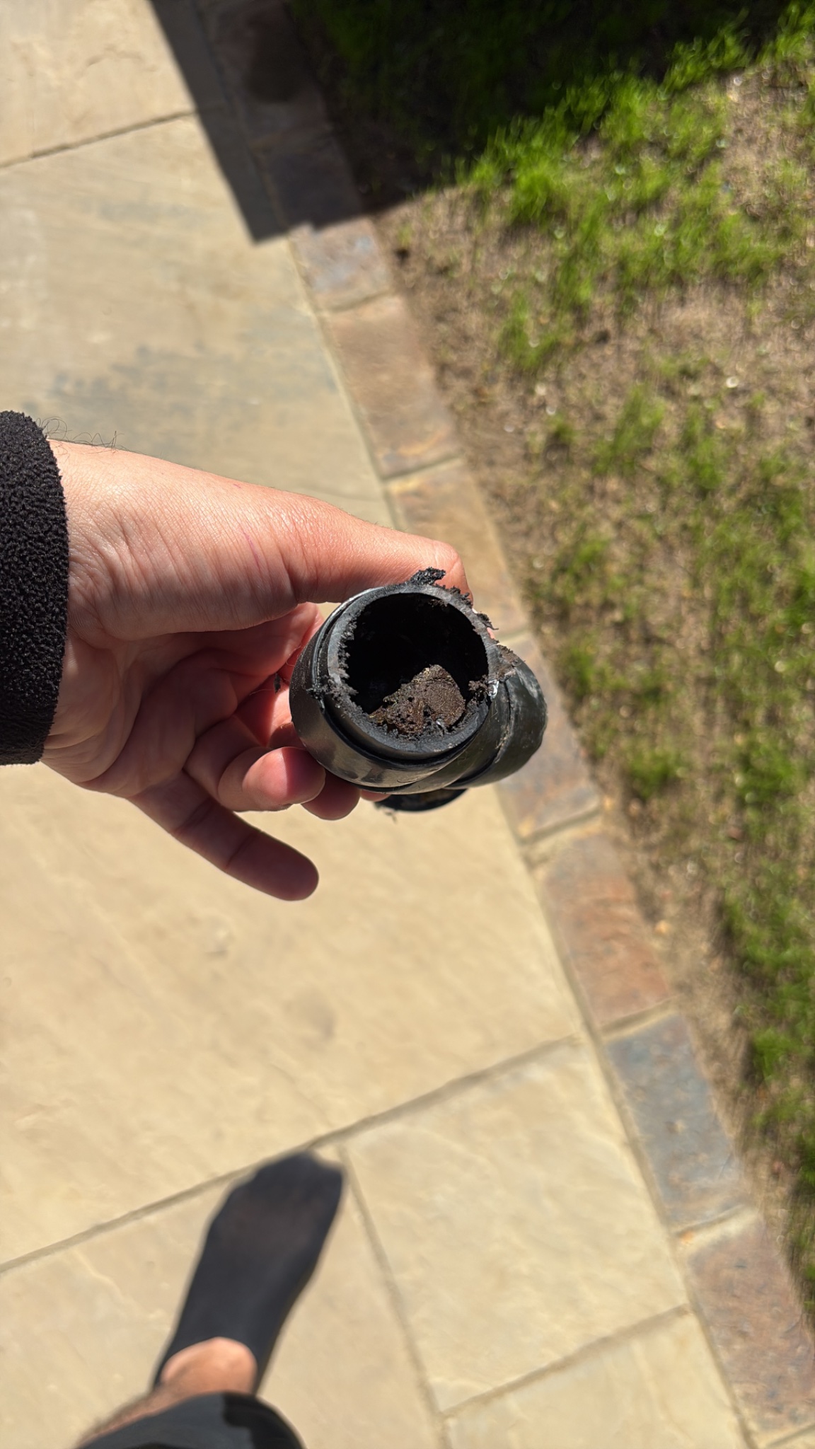

It won't need to have frozen. Those elbows go very brittle with age and condensate running through them.They break easily if moved or knocked. If the joints have been solvent welded it will be difficult to replace it so try something like JB Weld to repair it first.

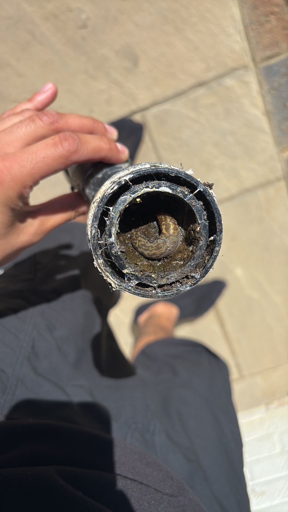

That, alone, suggests that the larger pipe is suffering an obstruction, preventing it draining further down. I would explore that first, as a matter of urgency.
If the boiler is working ok it will be fine for now. I would consider taking the larger pipe into the house and reducing it there, much better frost resistance.

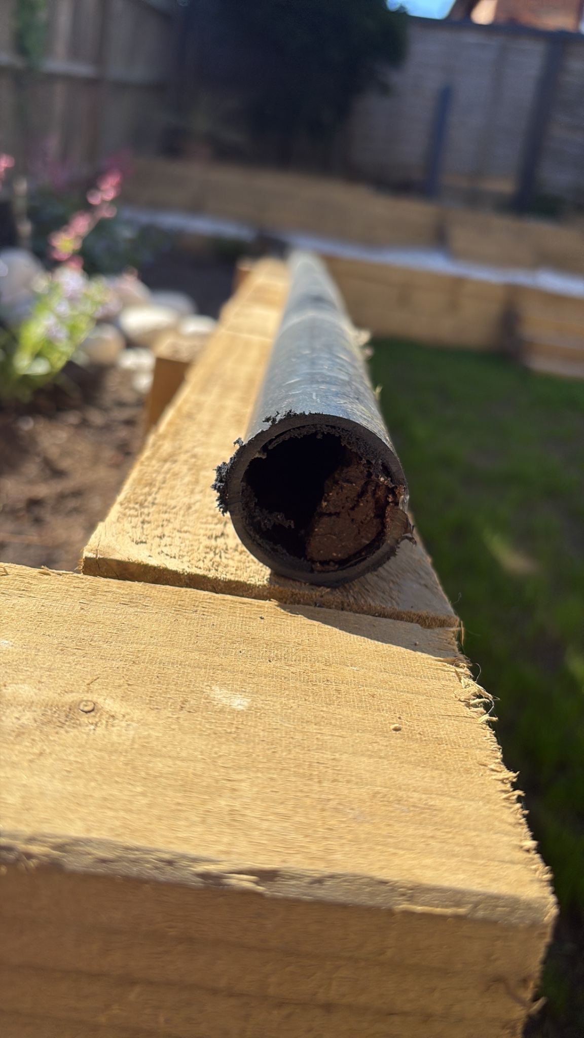

UPDATE: the pipe outdoor has been removed and replaced. This is what we found inside.

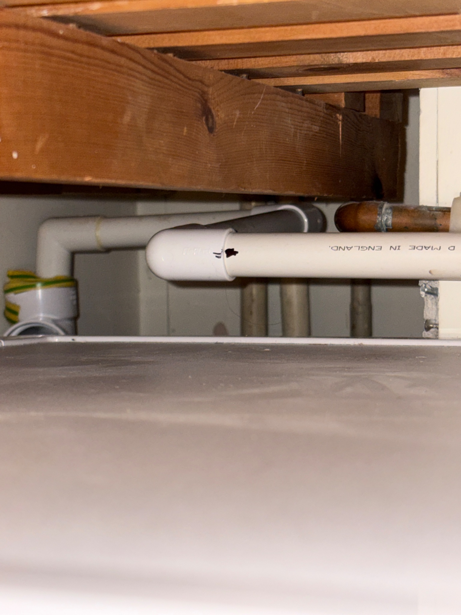

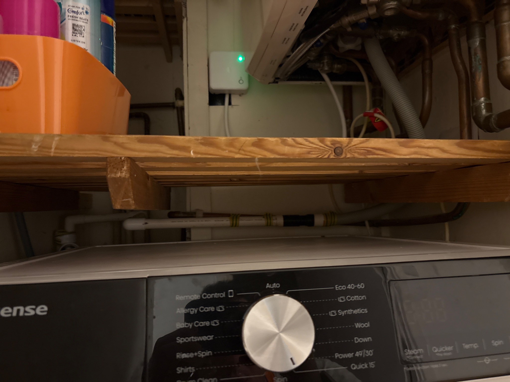

A new pipe is now draining directly from boiler along the washing machine tube. There is a small mistake that i see. One of the tubs is higher than others. Is that done correctly or should i call the guy back?
