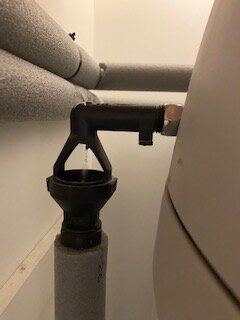

Recently moved into a new build and noticed a drip from what I assume is an overflow pipe every 10 seconds or so. The boiler is a Ideal Logic System S24 which I believe is a condenser boiler. Is this normal or is it a problem? Look forward to your answers and

Are you sure it's an overflow pipe? What pipe specifically is it or can you post a pic. Is it copper or plastic?
If it's a new build then you're looking to get the site office/contact involved, nothing should be dripping anywhere, if it's dripping then yes it's a problem. To what degree is another question.
Thanks for the response Madrab, as you can see it's copper and the boiler is in the garage about 5 metres from the outlet pipe.

There is an unvented hot water cylinder? If so then that needs looked at. Have you been in there for a few years? If so then the cylinder needs serviced by a qualified engineer.

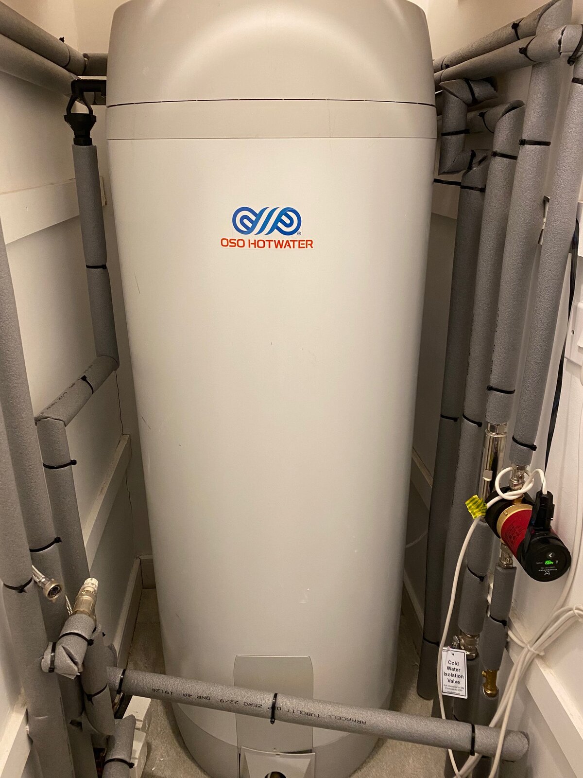

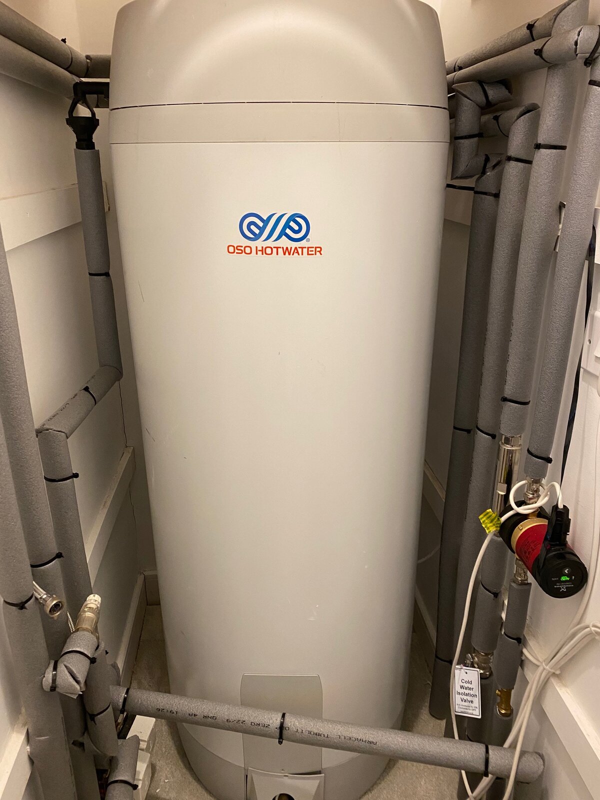

Stick another pic of the cylinder on here. There will be a copper pipe from a large valve assembly and a smaller valve on the cylinder that will probably join up and lead to a small plastic basket like connection (tundish) and you may see water dripping into that

Looks like you are right! Not seen this before, hidden by airing cupboard towels. What is causing the drips and can I rectify or is it a job for a professional. Appreciate your help so far Madrab.

You need a G3 certified plumber / engineer to service the unvented cylinder ,the pressure relief valve is passing water.

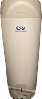

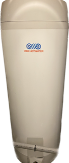

We need to know the make of your unvented cylinder. If you can send a pic of the front with the label/name/maker etc. There are certain ones that can have a certain function performed by the client. If not then as suggested you'll need an engineer qualified to service unvented cylinders.
The OSO supercoil, all round good cylinder IMO. It has expansion vessel(s) inside that grey cover on top. You will need an qualified engineer in to service the unit. Make sure he is qualified and check his ticket is in date. Point out the problem too (just in case).
In the future can I recommend that it is serviced yearly at the same time as your boiler.
