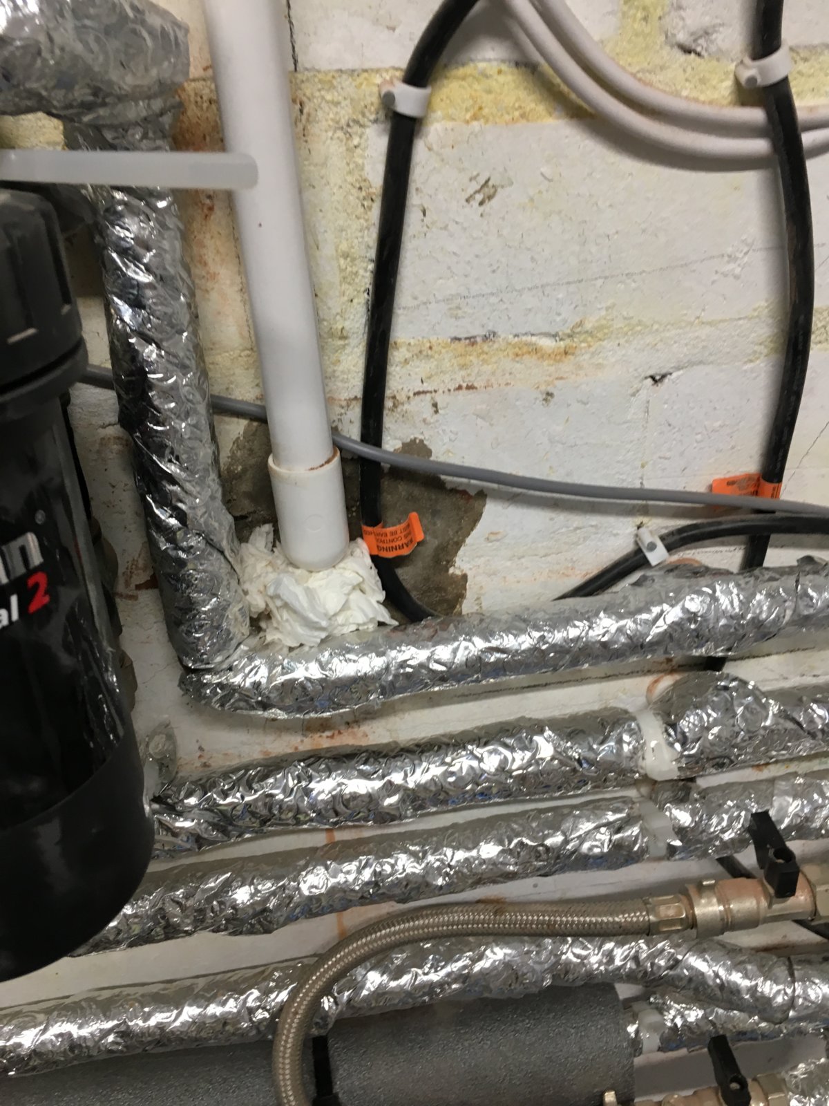

Condenser plastic pipe leak
8 Sep 2012
833
11
West Midlands
i think the joint has a leak. I’m thinking of fixing it. Any idea how? Do I need solvent weld glue to do it?
It's very hard to do anything with a faulty solvent joint, proper way would be cut it above and outside, put a straight couple in, then a new right angle. All with the correct solvent cement.
And this is probably waste water drainage rather than for system as there should be a trap in the boiler, but check the boiler manual to confirm that is the case.
