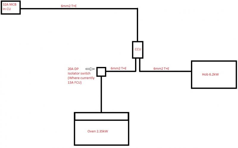

I am having a new Bosch single oven delivered tomorrow. Currently, I have a 32A MCB feeding a cooker isolation point. From there, there is a direct wire to the electric hob and another wire to a 13A FCU which the old oven was connected to.
I purchased a new hob and oven with the intention of replacing them directly. Now, having looked at the manual for the oven online, it says "Do not connect the appliance using a 13A plug or protect it with a 13A fuse". Unless im reading the wrong manual, I can't understand this. The oven is rated to draw 2.35kW, to me that equates to about 10A. Why should I not connect it to a 13A FCU with the existing wiring?
And if not, what can I do to allow safe connection?
And just to add, the hob is 6.2kW. With the oven that is a total of 8550W, so around 35-36A, but am I right to assume that will be ok when taking diversity into account?

Ok the cable going from the cooker point to both the hob and the FCU appear to be at least 4mm2 and judging by the measurements here: http://www.diynot.com/wiki/electrics:cable_types:flatpvccables They actually appear to be probably 6mm2 cables.
With regards to the exisiting FCU, it is some distance from the cooker point and the cable is well buried in between. If I was to replace that with a non fused connection point, what specs do I need?
If I use the device you linked to, where would I place that in the circuit? Would I then have a single cable from the cooker point going to the new device and then cables from there, one large one for the hob and one smaller one for the oven?

Sorry I think there was a bit of confusion in my last message. I am aware of the difference but I wasn't clear. So I have the cooker connection unit on the wall, from here there is a cable to a 13A FCU, and a cable direct to the Hob.
Im not doing anything with the CCU, what I wanted to know was could i replace the 13A FCU with a non fused connection unit in order to avoid having a 13A fuse in the circuit (as indicated in the MI). Or, do I need to wire a cable directly from the Cooker Connection Unit to the new oven and bypass the existing FCU completely? Option 1 would be much easier if possible, otherwise it means burying cable which is not ideal.

Why not simply replace the FCU with a 20A DP switch?
Or even just a flex outlet plate?
The wiring surely does not need changed...
Yes that is exactly the thing I was looking to do. I didnt know what the correct rating needed to be for the switch or flex outlet plate. So 20A is fine and not too high?
