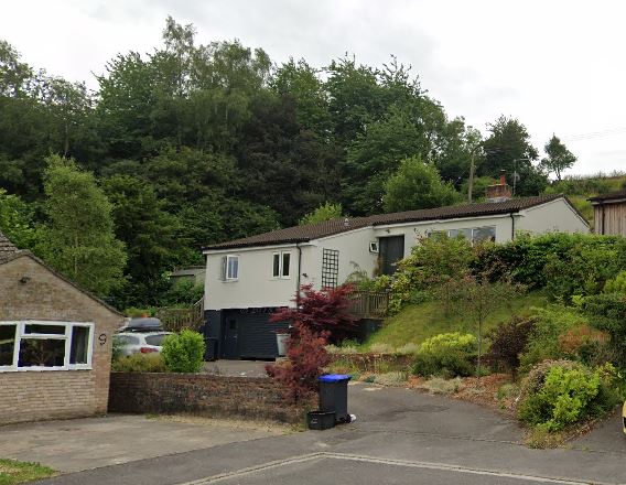

Hi. Does your integral garage look anything like our one built into hillside? what did you find from your pit work?
Why would you need to know? It's not the same house, you need to dig in front of your garage door to see what's there.

just curious to see if its similar to ours and what he found.
