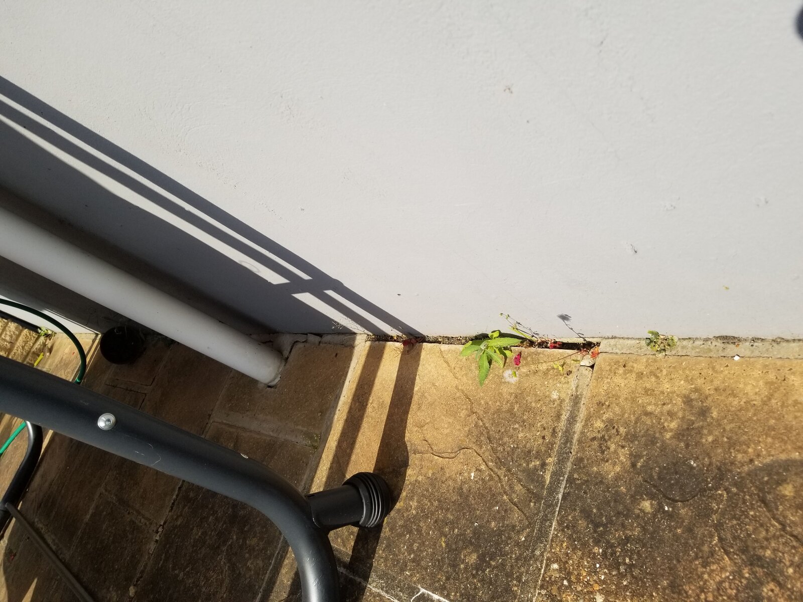

Hi folks, given the weather I'm planning to fix a few things at my house but struggling with what to buy and how to proceed. I basically want to:

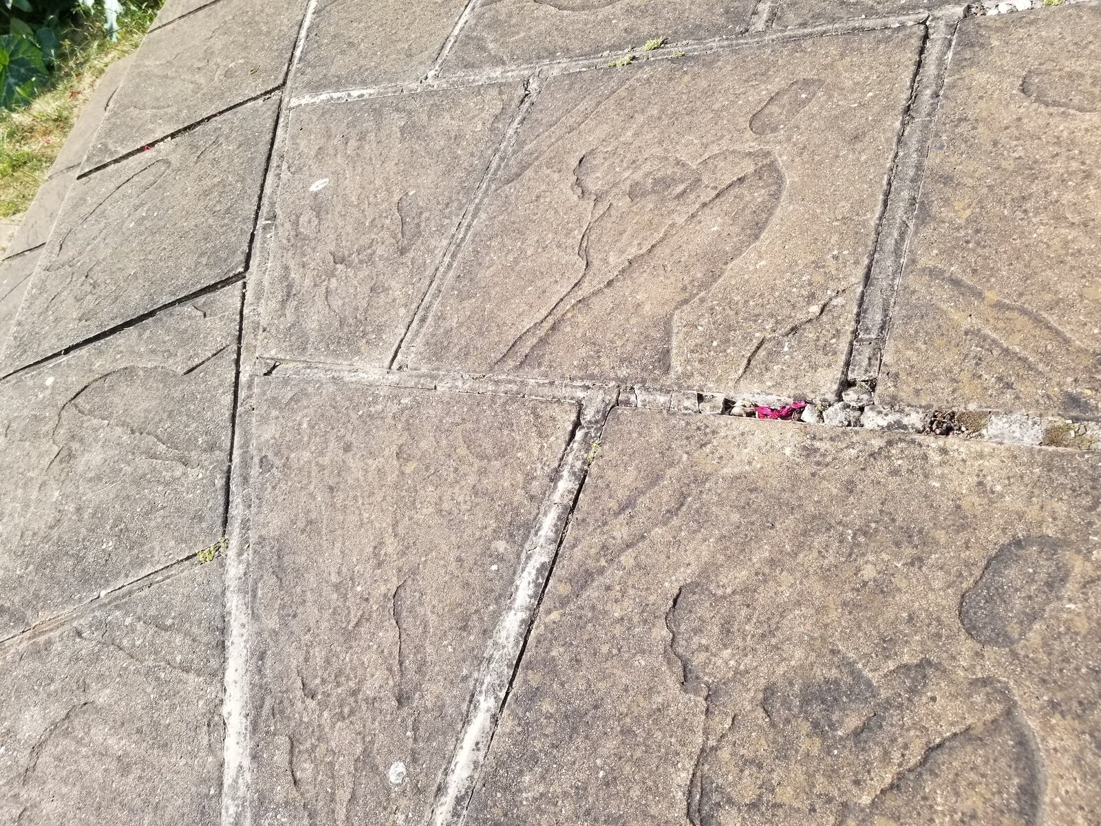

1. Fill gaps between tiles in the garden

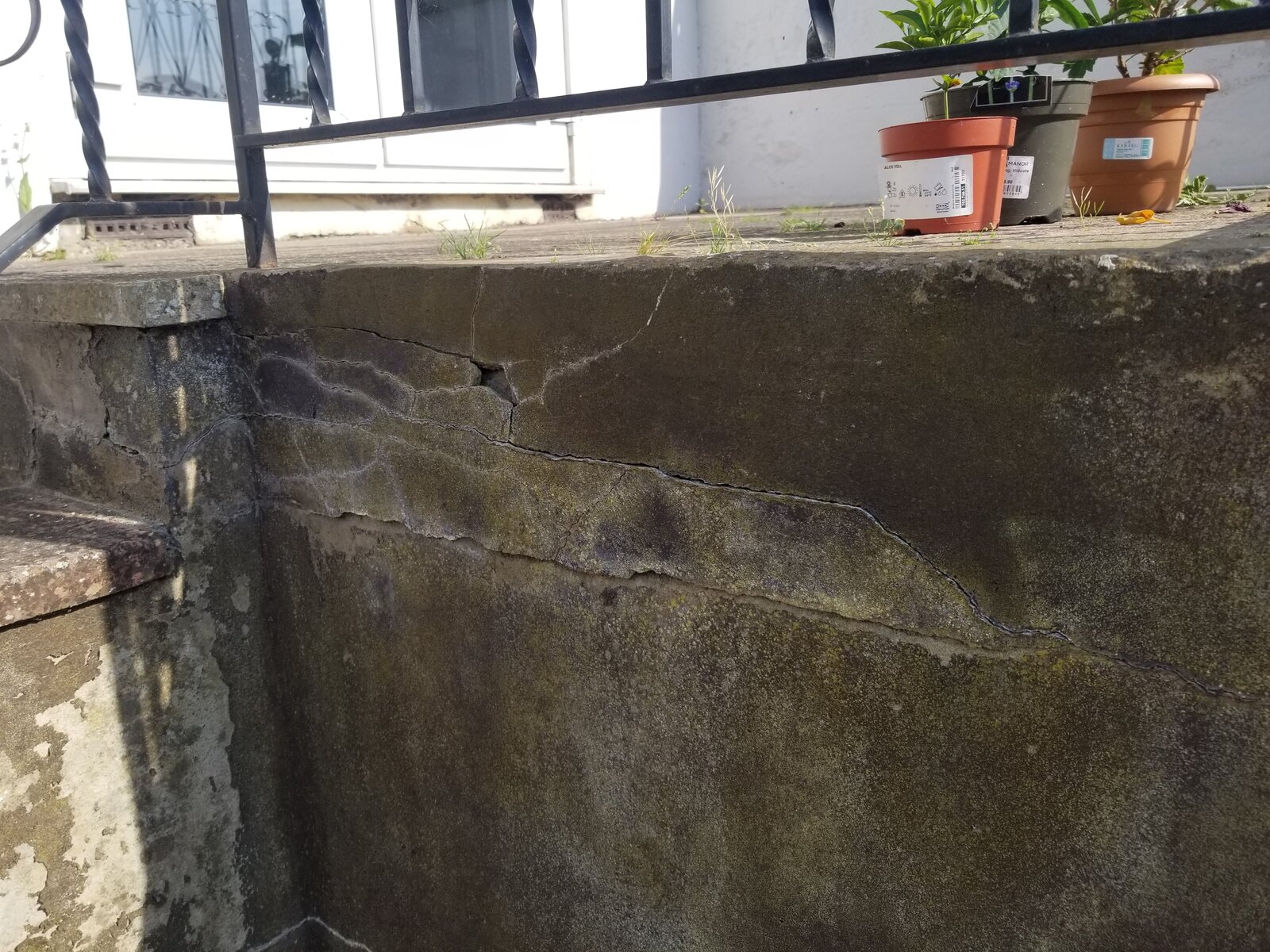

2. Fix cracks in my garden support (not sure what to call it, basically the thing my garden steps are connected to)

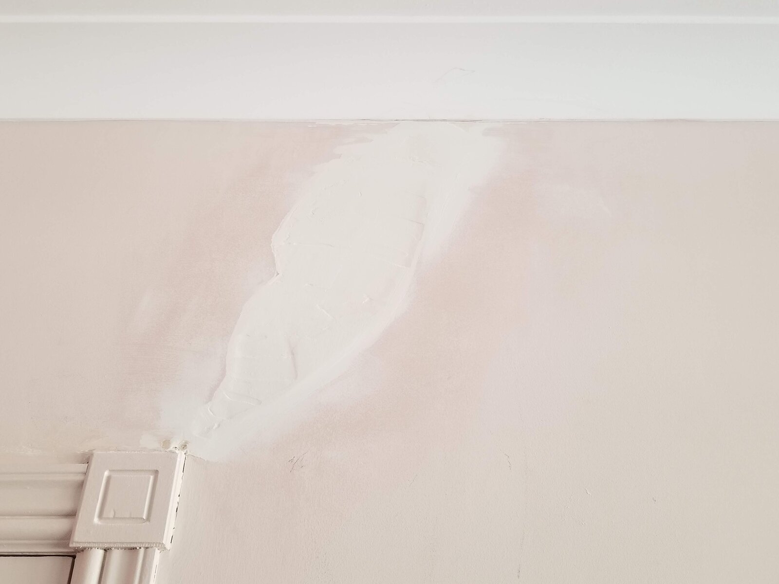

3. Even out the plaster on my interior wall. I tried to use my trusty old filler but it made a mess out of it :(

The toolset will do, add a finger trowel. Don't forget a few buckets (£1 from bandq).
The mortar will be fine for patch pointing the slabs, but personally I would rake/chisel out the whole lot and redo it.
Easifill and sandpaper probably best for your internal plaster repairs.
That retaining wall is a problem - looks like some loose structure behind the render which will continue to cause any render to crack - probably best to hack off all the render and repair any loose masonry (and anything causing water to get in behind the wall - paving on the top?) then get it professionally re-rendered - it's not a job for a beginner. Alternatively, as a budget option, you could leave as is (it's not going to fall down) and clad it - things like timber or composite decking are quite popular these days, even recycled pallet boards if that's your thing.
If you are feeling a bit more flash with the cash, you could use a brush in resin for the paving, once you've raked out the old mortar.
You just brush this stuff around and tool down.

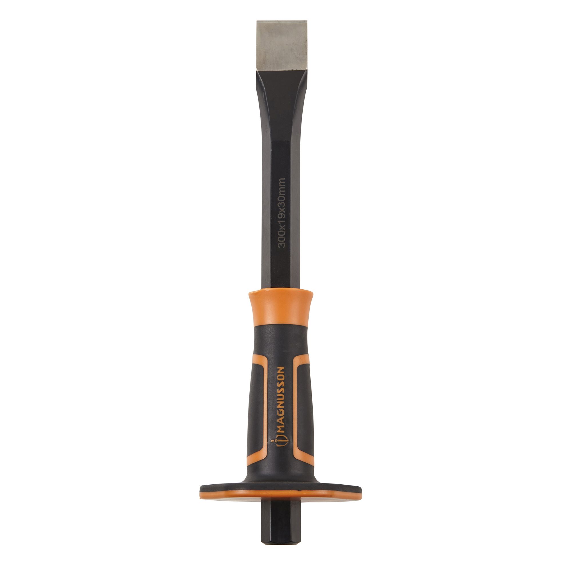

Thank you @cdbe and @Mr Chibs for the clarifications! I've got another question -- what would be the best way to take off mortar from between my tiles. Would a concrete chisel like this one work?
Or would I need to buy some sort of a specialized tool for this?
BTW below are the things which I'm buying:
This is probably what you need if you want to do it by hand. Might be a good idea to start here and see how easy it is/not.
Plugging Chisel
Personally, I'd probably use a small angle grinder and a diamond disc/mortar raking disc... and grind it out, mask, goggles and ear defenders are essential, you can cover quite a large area this way.
For internal filling cdbe is right, I'd just add one of these for the sanding...
Sanding handle
or a Mirka if you can stretch that far, they are great when connect to a vacuum cleaner

The sika is crap , dries out and crumbles after less than 6 months.
