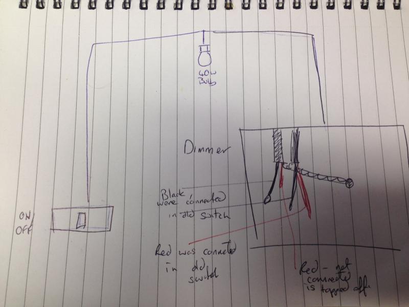

Hi
I've been looking to replace a dimmer switch that causes lights to flicker (even when on full) — all the replacement switches I've looked at seem to have L1 L2 and one other connector.
The switch has two sets of wiring coming into the box — earth & then two black wires and two red wires. One of the red wires was not connected to anything and is taped up.
If I wire the two blacks into L2 and the red into L1 as suggested by an electrician mate the dimmer switch has no effect at all (although the second switch controls the light on/off)
If i copy (as close as possible there were no markings I could see on the old switch) the layout on the old switch the dimmer works but buzzes and flickers. I've currently got it all switched off (not a huge problem) - but I'd like to sort it.
Have attached a diagram

It's a 'normal' light in the ceiling—with a standard 40W bulb in it. There doesn't look to be any connection problems in the fitting—and like I say with the dimmer wired 'out of the equation' the secondary switch works fine and the light is on without flicker.

Which is what one would expect. It's pretty mind-boggling that an electrician would tell you do do that.
See the top-left diagram here: //www.diynot.com/wiki/electrics:two-way-lighting

Flickering etc aside, does it work as you'd expect, i.e, you still have 2-way control with the dimmer and the other switch?

What do you connect together when you take the dimmer out?

Yes… but very flickery and buzzy…
