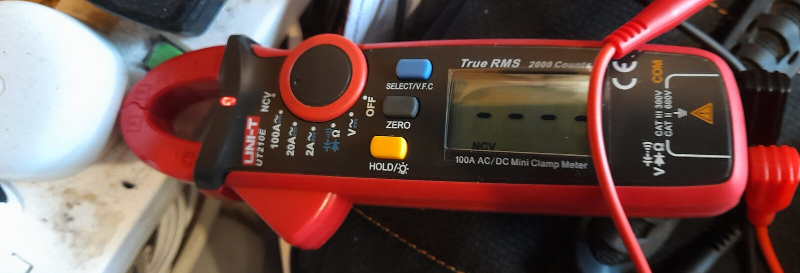

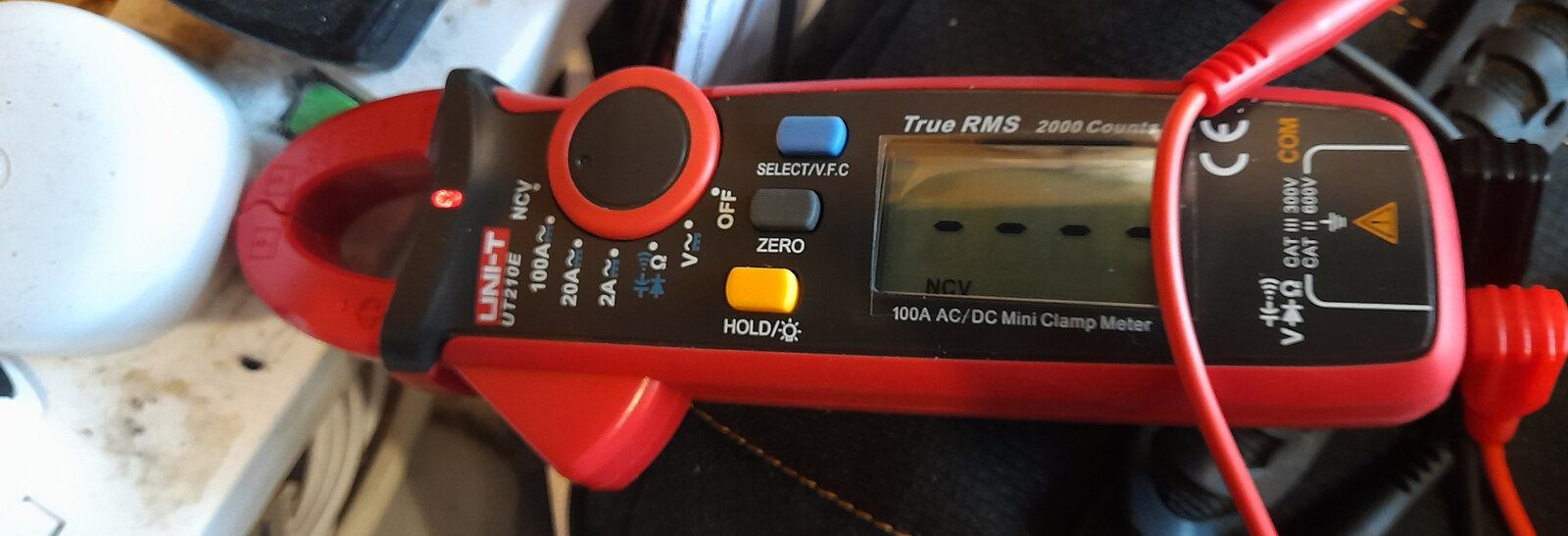

My non contact voltage tester Testing for live.jpg does some times show one bar and a little of a buzz when the circuit is off, they only give an indication that there may be voltage, they are not 100% with no leads used, the current non contact is better, but AC works better than DC, with DC the angle of the tester can change the result, it needs zeroing.
There are different quality of testers, both with and without leads, the one I have is one of the cheapest, only cost around £35, but once the device is opened I will retest with leads.

That is silly, for a pair of leads to work, you need a reference point, the non contact tester uses your body as a reference point, same with neon screwdriver, they will likely save you where there is a borrowed neutral, yes we should put the clamps around the wire before disconnecting, but that is also non contact testing.
The tester I show does have 4 levels, you can see the 4 bars, where some very cheap either light or don't light, and the reed switch in them is easy damaged, hence testing by rubbing on your cloths, they will light with a little static.
So if wearing nylon very likely it will light with any earthed point, as you are charged.

My non contact voltage tester View attachment 293245 does some times show one bar and a little of a buzz when the circuit is off, they only give an indication that there may be voltage, they are not 100% with no leads used, the current non contact is better, but AC works better than DC, with DC the angle of the tester can change the result, it needs zeroing.
