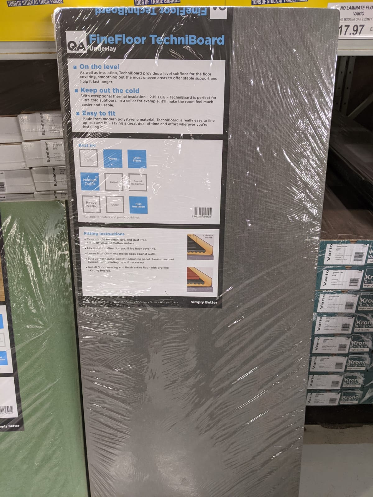

We have found other polystyrene boards in DIY stores that are 5mm purporting to be suitable to ultra cold concrete floors, and no additional OSB or underlay needed, so laminate would to directly ontop. I have attached the image of the product
I'm confused how such boards that are 5mm would out perform 25mm of insulation in the traditional way.

No other product will beat the 25mm of foil faced insulation that you proposed.

That 5mm underlay will not outperform 25mm of celotex or similar. Its worth using, but in addition to, not instead of, the 25mm.
The only thing that outperforms celotex or other PIR type boards is ultra expensive aerogel, which I don't think is suitable for floors as its quite fragile

The thin boards are likely a pressed material. The OSB is far stronger. It should provide a flat surface that's easy to lay laminate on. Once all the T&G has been glued, a garage sized piece of OSB will weigh a bit and won't really move.
Think what happens when you walk on snow, it compresses. The OSD acts like a snow shoe and distributes the weight.
You might need that thin underlay that looks like white fabric between the OSB and Laminate? Thinking that it might add some slippage for both surfaces?
I think that’s an alternative to the underlay that you need between the OSB and the laminate.
