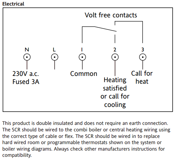

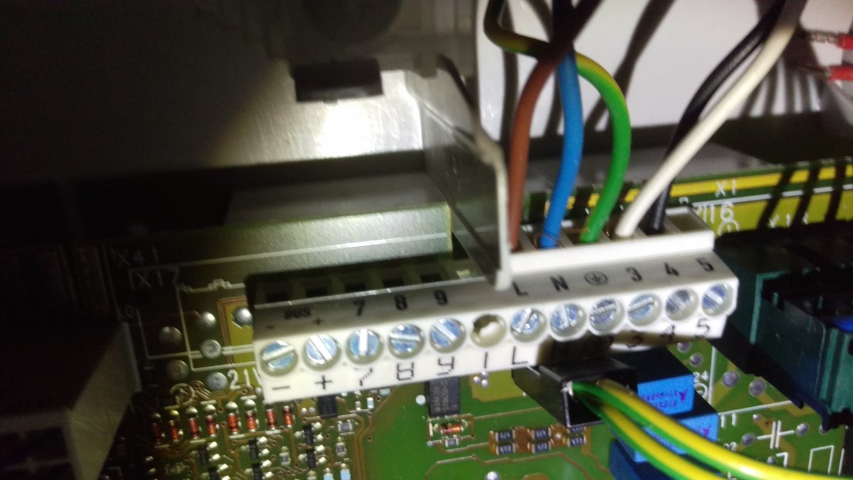

I'm trying to wire a Salus rt500rf unit to a vailiant ecoTEC plus 824 combi boiler.
It is currently wired to a faulty Drayton Digistat SCR as per the below images.
Fused spur in to to N,L & Earth (image 1) then wired to the boiler (image 2)

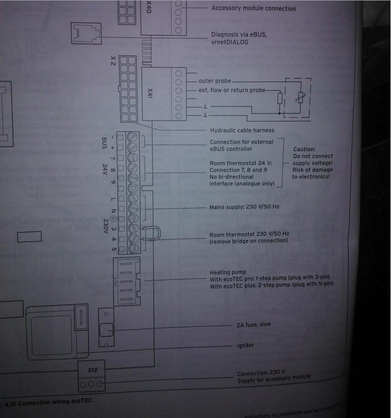

Wiring diagrams for both shown, images 3,4&5
Drayton Receiver
Boiler Wiring Panel
Drayton Receiver W/D
Boiler W/D

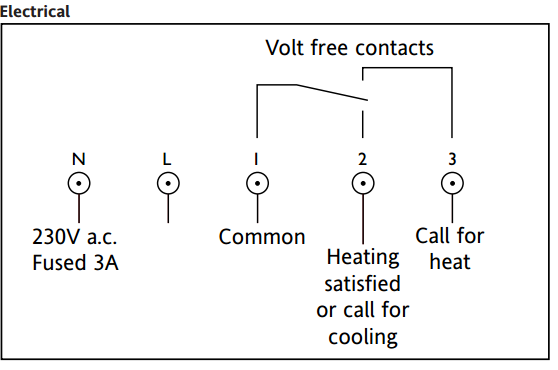

The wiring diagram for the Salus unit is below.
Receiver
Please can somebody provide some guidance for wiring the Salus receiver in.

Hi, appreciate your concern, just to clarify.... I'm more than capable of working with mains electrics + the juice was isolated whilst I was investigating. I'm struggling more with the terminology on the valiant diagram.
I could replicate the current setup on my current unit, but have seen conflicting info with regards to setup, and I'd prefer to understand it fully so I know for next time.....hence why I'm here to find out.

Drayton Terminal 1 cable (white) goes to COM on Salus.
Drayton Terminal 3 cable (black) goes to NO on Salus.
And don't forget Live & Neutral.
(You do NOT need a wire link from Live to COM. which is shown on some diagrams. The boiler takes care of that.)

You should take the loose red link wire out of the Vaillant wiring box, these can drop under the circuit board when the panel is hinged open and short it out, and they are expensive. The original installer should not have left it lying in there when he wired the controls (boiler was delivered with it across terms 3&4).
