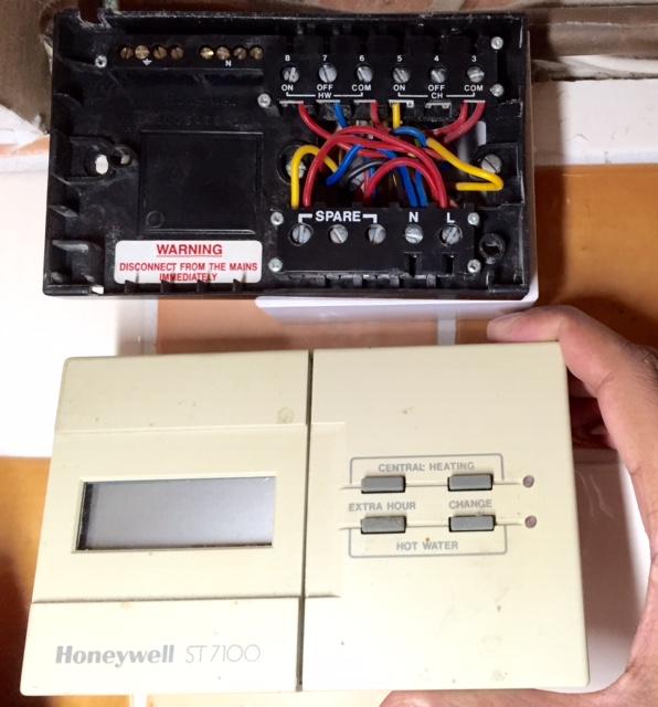

I am trying to connect my new Nest Thermostat to:
Potterton Suprima 60 HE - Condensing Central Heating Boiler
(Manual: http://www.potterton.co.uk/docs/101209_Potterton_Suprima_HE_Range_installer_guide.pdf, see page 30 for wiring)
Honeywell ST7100 Control Unit (http://www.honeywelluk.com/products/Discontinued-Products/ST7100/)
Honeywell Thermostat (1 zone only)
Wired in a C-Plan configuration - Gravity DHW (I think, as there's a water tank in the loft), for Hot Water and Pumped Central Heating System.

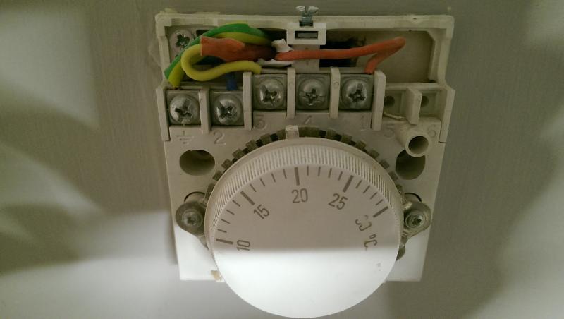

If your existing thermostat has the usual Neutral, live and switched live connections then the Nest remote unit (Which they call the heat link) simply replaces it.
Does your existing controls allow you to have heating on but hot water off? If not then that may be a problem.
If you can have heating on, but hot water off then (with the power off), slacken the little screw on the top of the thermostat and pull the cover off and see what wires you have, or post up a picture of it. If it is conventionally wired you just replace with the heat link unit as shown on page 34 of the manual. Clicky-> https://s3.amazonaws.com/support-as...ges/Nest-Thermostat-Installation-Guide-UK.pdf
Then set your existing programmer to heating constantly on and let the nest do it's stuff.

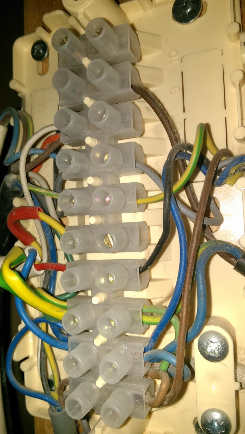

I have the same thermostat and, I'm pretty sure, a Y-plan system.
Whilst I think (so far - still researching it) that swapping out the wall mounted thermostat should be the easy option, I'd rather put the Nest controller where the current thermostat is.
So, my thoughts are to buy a 0.5m length of the same cable that runs from the junction box (situated in the a/c) to the thermostat, and connect the heat link to the other end, mounting it in the a/c too.
Then, I will use the existing thermostat cable to run the 12V from the heatlink to the nest thermostat.
Does this make sense?
wires: earth, 1 = L, 2 = N, 3 = L (switched)
just to follow up.... all fitted quite easily over the weekend - including replacing the old thermostat with the NEST one, using the existing wiring to run 12V to it from the Heat Link, that I mounted next to the junction box in the airing cupboard
