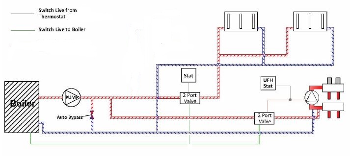

Hi everyone first I will explain the system I am planning...
Boiler is an Ideal Vogue C32
Groundfloor -
UFH throughout split between 2 zones as follows
Z1) - Kitchen
Z2) - Living Room/Hall
Second Floor -
4 Radiators as follows
Z3) Second Floor Radiators
I am going to have 3 Nest (Gen3) thermostats running the show and wondered how to go about connecting them up.
Can I connect all 3 of the nest Heat Links directly to the boiler or will I need a control centre > Boiler?
Will I just need a single zone valve to feed the UFH manifold which will then be connected to the two UFH heatlinks then each of these heatlinks also connected to each ''zone'' actuator it needs to control?
I imagine for the radiators I can have the radiator Nest heatlink connected to a second zone valve that feeds the radiators.
As always any feedback is much appreciated.
You will need a separate Nest Heatlink and Nest Thermostat for each of the three zones as you have figured, but the Heatlinks operate their respective zone valves. The zone control devices then operate the boiler, not the Heatlinks.

It depends what you mean by 'wiring centre' some form of junction box(es) will be required to make the wiring connections. It will also depend on the method used to control each of the UFH zones, it can be a standard 2 port motorised valve, or some other type of specialised UFH controller. Personally, I haven't had any installation experience of the latter.
With standard two port valves, the Heatlink would be wired to operate the appropriate zone valve and the associated manifold pump. Inside each zone valve is a small microswitch that operates when the valve is fully open. This is wired to control the boiler. In the typical simplified diagram of a two zone installation below, the 'Stat' would be the 'Heatlink'

My only other query would be do I need a 2port valve per UFH zone or will just one valve be controlled by both Nets connected to the UFH.
Each Zone that has a Nest will also need a dedicated valve for the Nest to operate. The Nest will open the valve when heating to that zone is required, and close it when it's not required.
Ah I must have got mixed up with all the talk of zones. I was thinking each UFH loop was also classed as a zone whereas actually the whole UFH system as a whole is the zone, this is then split into ''loops'' rather than 'zones''
Turns out I will have 2 zones
1 Zone for radiators (run from Nest)
1 Zone for JG Speedfit UFH (2 separate loops, each ran from its own Nest)
Each of the above Zones will have a Honeywell 2 Port Zone Valve

If that's happening then it hasn't been wired correctly - a simple case of installer error. Nest is just a switch at the end of the day. It turns a zone on, or off. The only way it can switch the wrong zone is if it's connected to the wrong zone.
I've done 5-zone 5-Nest systems before. It works provided your installer understands central heating wiring
But the nest talks to the heatlink via Bluetooth/WiFi that’s why nest says to keep there heat links 30cm apart so I’m guessing people are saying there was interference causing the stat to turn on the wrong heatlink even with them apart, I’m just being over paranoid before I spend a lot of money on 5 nests but maybe it’s not so bad, may I ask what wiring center was used for the stats to control the ufh actuators if you know cheers?
The 30cm separation is recommended to prevent anything blocking the thermostat signal so that it doesn't reach the Heat Link. If that were to happen the Heat Link wouldn't respond to the signal from the thermostat. But it won't cause a thermostat to operate a Heat Link that it is not paired with.
