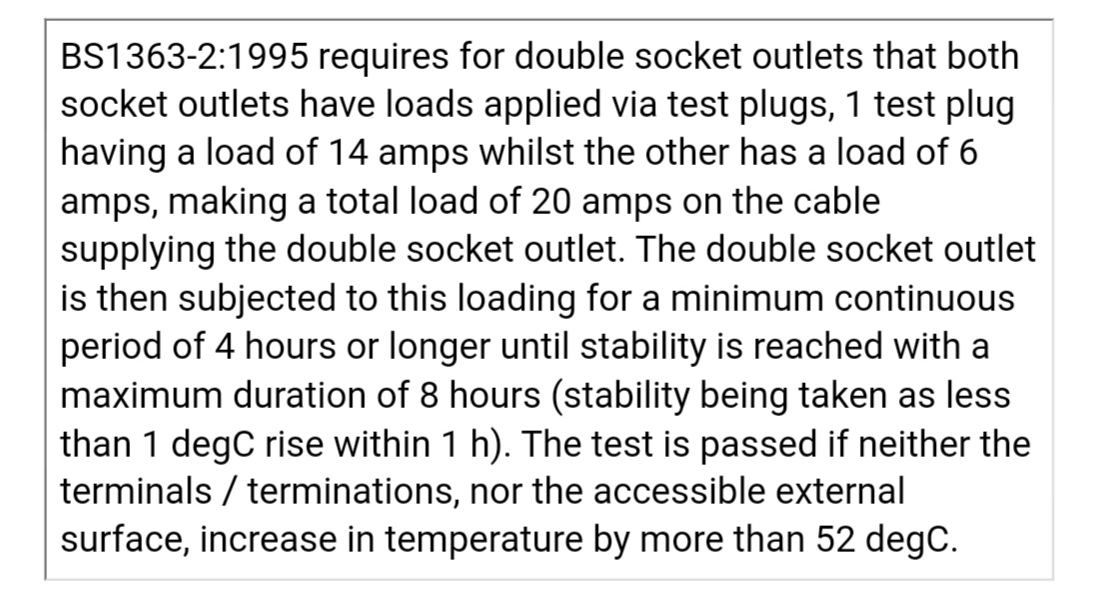

Also, you could consider say, plugging two 2.5kW heaters into a double socket, seems reasonable? - Not a good idea, as double sockets are normally tested to 20A :)
There seems to me, to be a disconnect between the reality of electrical systems and 'common knowledge'.
The common terms are 13A plugs and sockets - why can't we plug in a 3kW load on every socket? ;)
Well, only just - 21A.
Anyway, if someone has been told that the maximum load you can plug into a ring circuit is 13A then it is reasonable for them to think that that is a limitation of the ring circuit, rather than simply the limitation imposed by the plug fuse.
After all - the characteristics of the UK socket ring circuit are identical to the UK standard cooker circuit.
