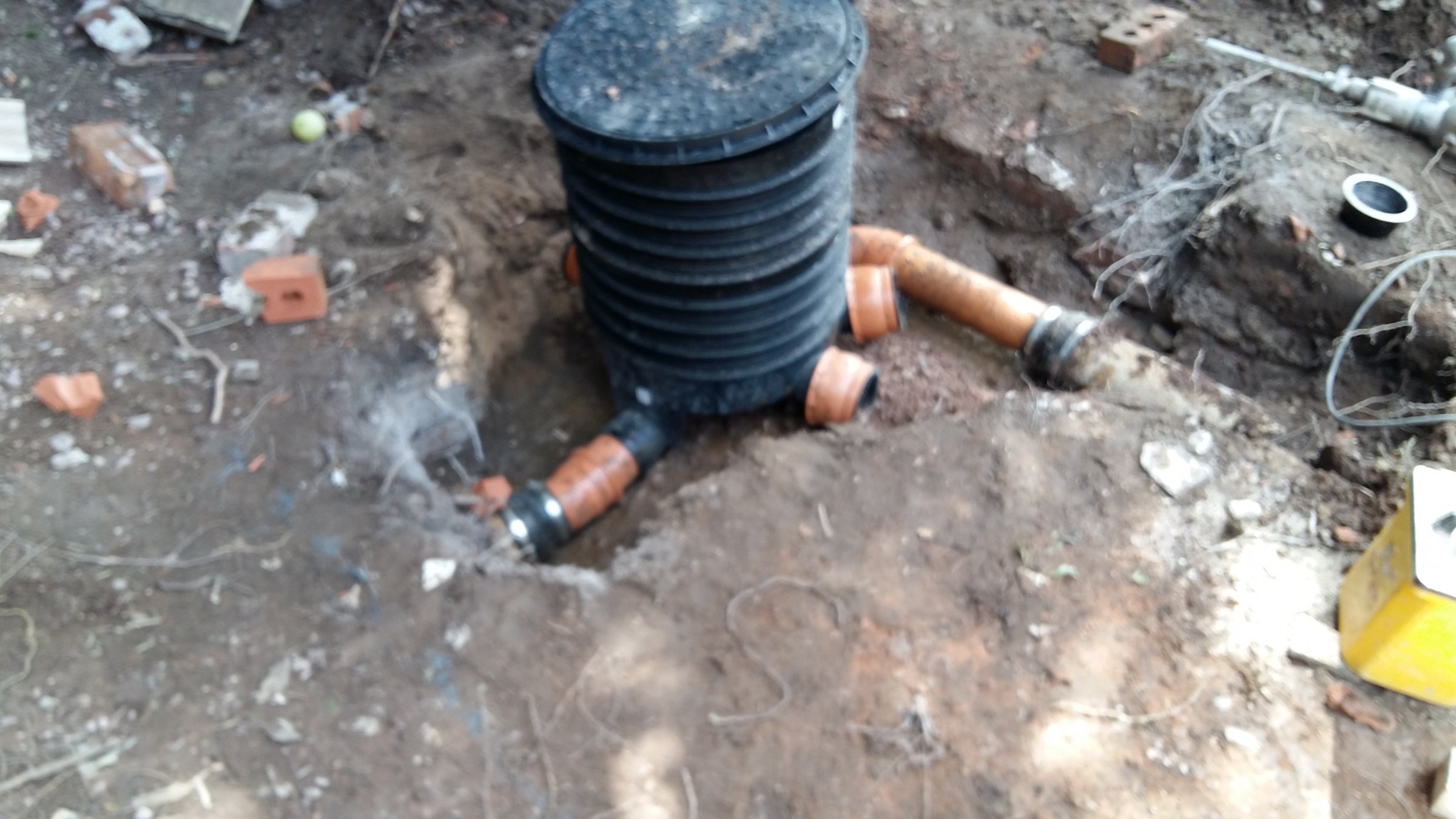

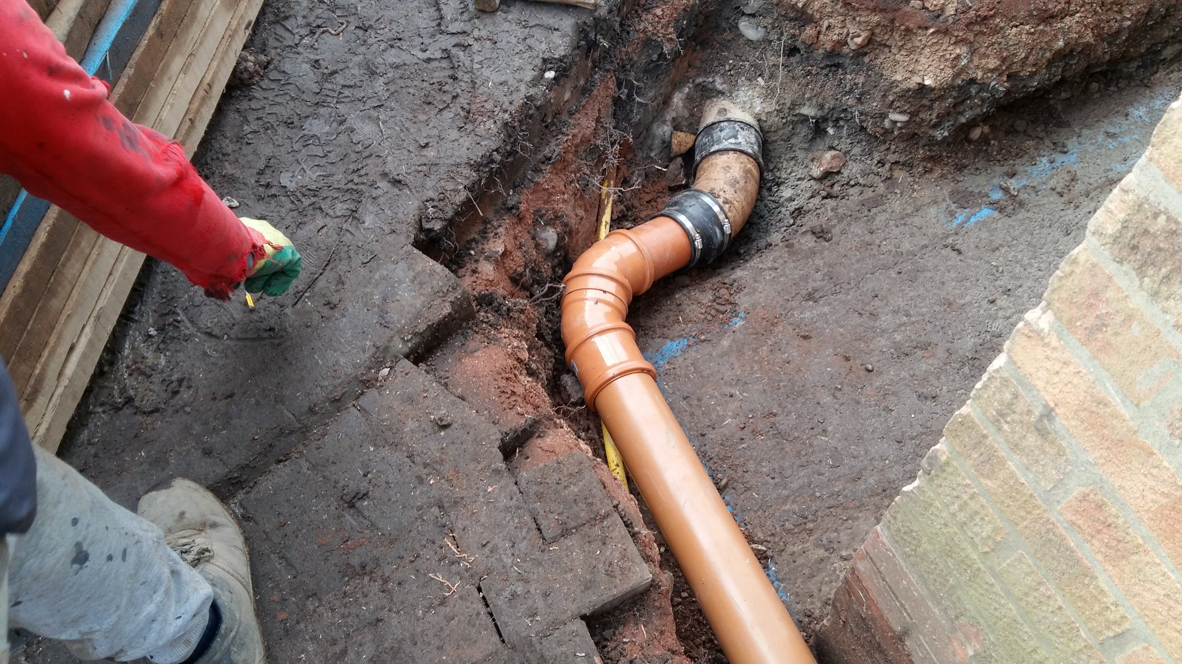

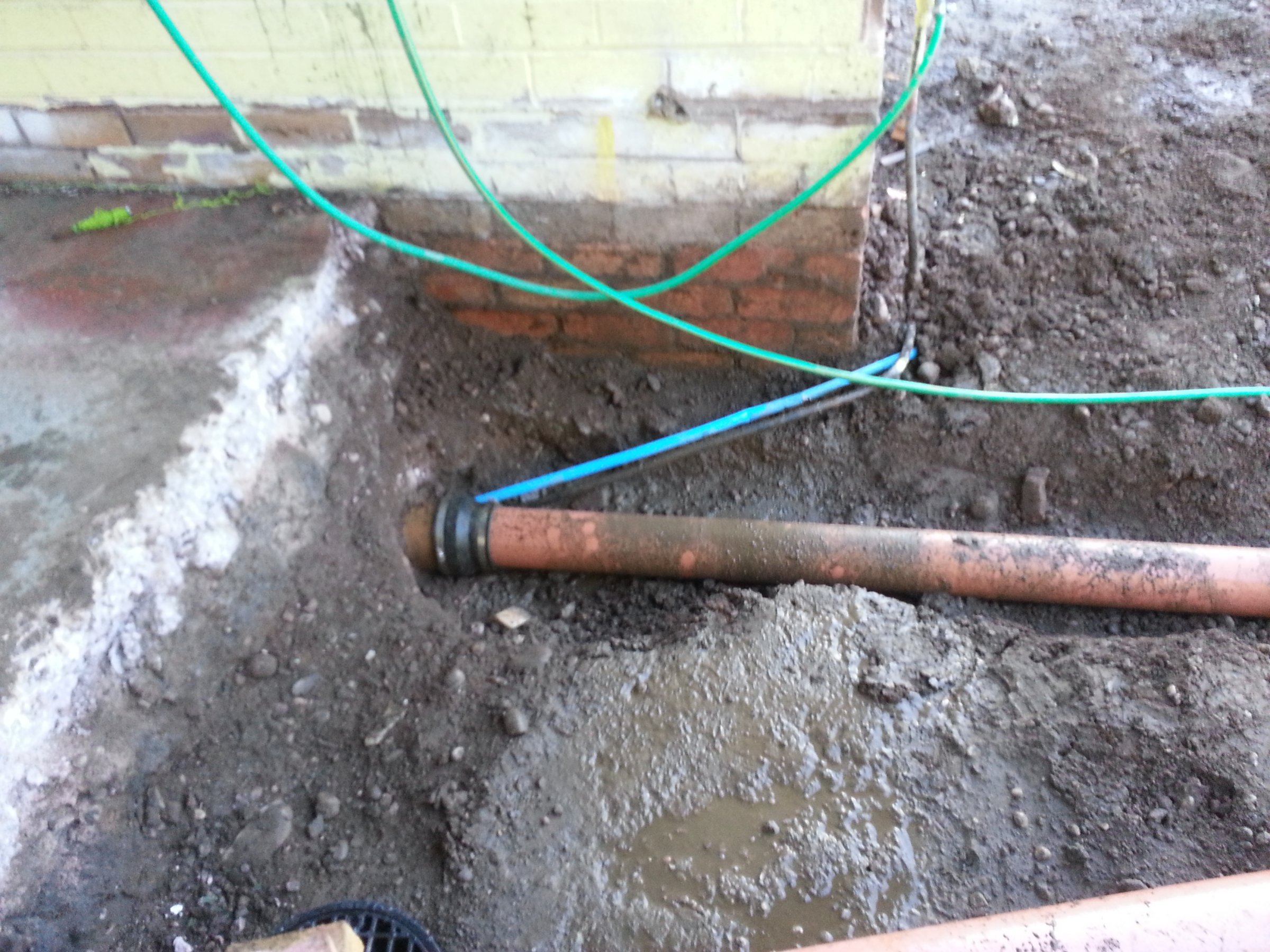

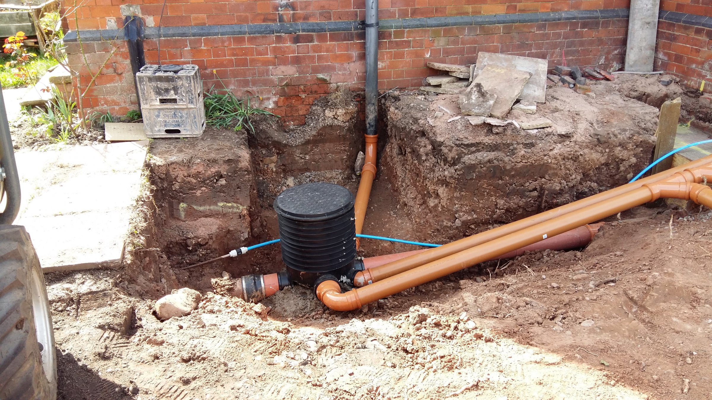

Thanks for the photos Noseall. Very usefull.
