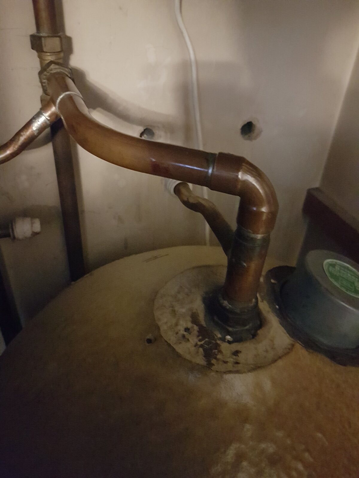

Is it ok to connect hot feed from shower pump from tank by teeing from the outflow at top of tank. See picture. Thanks 20200607_195811.jpg
Yes. Would work(ish) But.
The pump manufacturers do not recommend this and certainly would reject a warranty claim were the pump to fail during its guarantee period.
