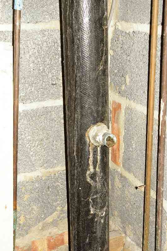

I am re-doing my downstairs toilet and would like a bit of advice regarding connecting the sink waste to the soil pipe. Originally the waste pipe from the sink was running along the wall and was connected to the soil pipe at about waist height which was then boxed in. However, because the waste pipe was against the wall it was a little unsightly so I now want to bury it in the wall vertically untill below the floor and then run under the floor and tee into the soil pipe.
Can anyone tell me what the soil pipe is made of (picture attached). It is black and has a sort of orange peel effect on it's surface. It's not metal or plastic and was put in when the house was built in 1964.
Then, how would I connect the 40mm waste pipe to it and what would I cut the hole with. Lastly what would be the best idea for blocking the previous sink connection hole.

It looks like asbestos cement (can't say for sure), not pure asbestos. If so, it is only dangerous when you create dust. Where dust is likely to be generated (sawing, drilling) use a water spray to damp down any dust. Have a good vacuum of the area of work immediately afterwards too, and of course wear a mask.
Conection to it could be done through drilling a hole, using the correct size core and fit a 40mm bung, which will then take your waste connection.
As for disposal of any waste, in theory it should be treated as hazardous waste (loads a money £££), but it has been known for people to double wrap in plastic bags and dispose of in household waste, i am not condoning this though as it is wrong.

Better to use a strap on boss with a 40mm socket. You can use silicone sealant to make sure that the boss seals to the stack. Sockets come in both push-fit and solvent welded varieties.
Hi
Pitchfibre pipe?
New connection ,use strap boss. Hole saw (Starrett type. )to cut new hole .But not if asbestos!!
Rubber bung, as said, with access cap.Wipe some leak sealer over that old connection where it's been leaking in the past.

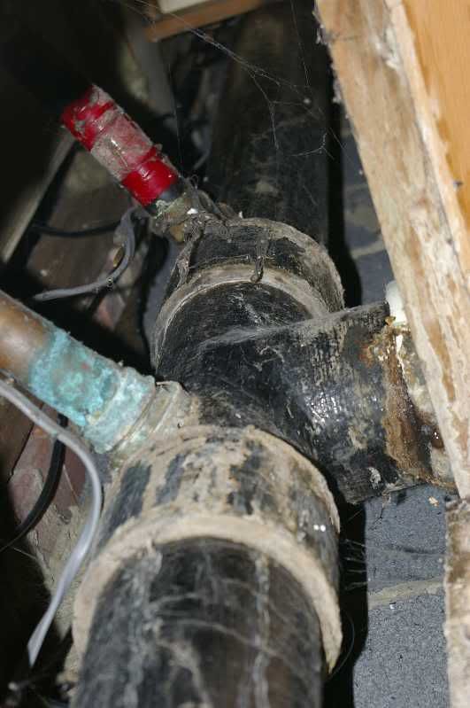

At some stage in the near future we are going to refit the upstairs bathroom where the sink, bath & toilet all connect to this soil pipe and I am going to have the same problems then as well. here is a picture looking up from below at the bathroom connections.....
......and you can see a leak from the toilet connector on the right. The bath waste pipe is copper, the sink waste is an odd size soft plastic type of pipe and I am just thinking I would save myself a lot of trouble later on if I replace the whole lot.

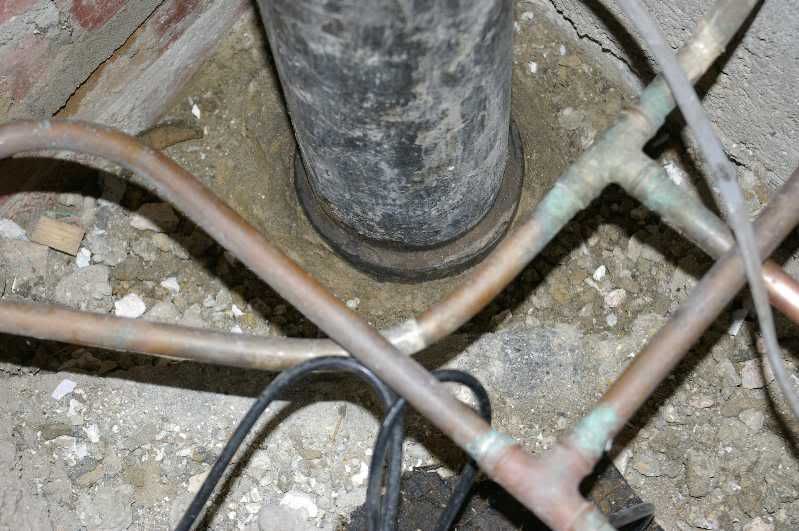

Does anyone have any advice on this please. This is a picture of the bottom of the pipe......
....but I don't know how it is likely to be fixed at the bottom. Would this just be a push fit or cemented in. The pipe goes straight up from this bottom connector and exits through the roof with a vent at the top and the only connections to it are the downstairs basin and the sink, bath & toilet upstairs.

if its standard size you should be able to cut fairly close to the floor but leave enough space to get a fitting on, and then continue the rest in plastic, or up until where your going to be connecting to it.
so just cut a section out and put plastic in it's place. it would save a lot of messing around in the long run.

The problem is it doesn't appear to be standard size. I've measured it to be about 125mm OD (just under 5 inch) so standard plastic fittings won't work.
Russell
You can get rubber couplers to suit the different sizes that are straight forward to use. They clamp to the pipe with hoze clips. The two ends are made to suit the two pipe sizes,and the clips clamp everything up to seal it.
