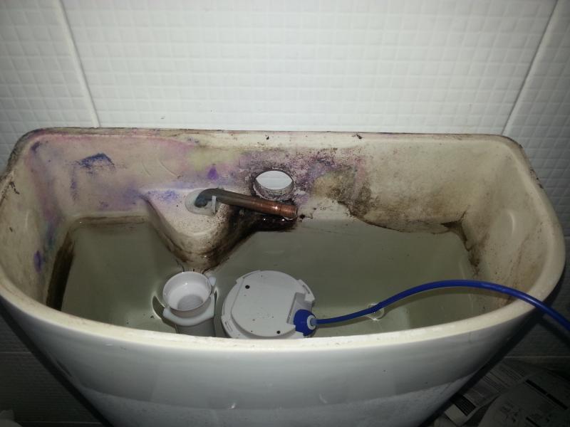

Had a bit of a meldown with my cistern the other week and both float valve and the dual flush system needed replaced. I have swapped out the dual flush no problem and all working / leak free.
However, I am trying to fit a Fluidmaster 747(uk) Side Inlet valve to complete the set up. However I am being somewhat dense I feel as the connections I have don't seem to match up.
My water supply into the cistern is 10mm copper and comes through the body of the tank in an unusual way (see attached pic). It doesnt come through the side, instead up through a purpose made hole in the tank and points out to the side. The fluidmaster has a 15mm threaded shank on the end. Now I realise this is meant for side inlet, so should I be looking for a different float valve or is there a way for me to go from 10mm copper to 15mm female.
I have a spare 10mm/15mm reducer but that has 15mm male end that just obv doesnt connect to the fluidmaster as it has a 15mm male also. I need a reducer that takes the 10mm copper onto a 15mm female, but I cant seem to see one anywhere.
Someone please slap me upside the head and tell me where I am going wrong.
