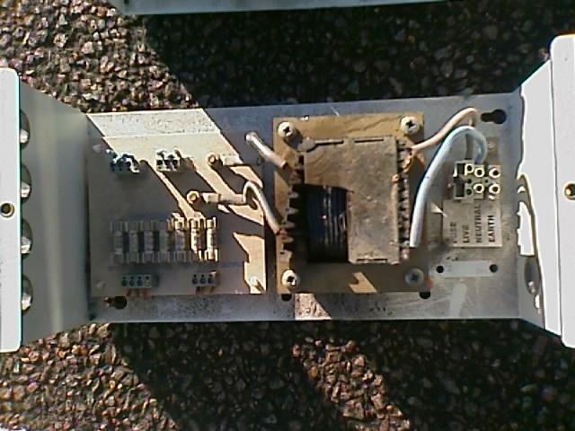

Hi folks in the process of installing a set of 12v spot lights, each one has a transformer.
Th connector for the cable will only take a single 1.5mm cable. Therefore to jump from one transformer to the next with the 240 ring the 2 cables making the loop need to drop down to a single cable as the transformer will not take both cable.
My question is:
What is the best way to reduce the cables should I bring the 2 cables in to a connector block and one cable our
Or
Use a crimp connector crimping 2 cables one end and one the other.
Or
Is there another way it could be done.
All cables will be located in the loft and not accessible by anyone.
Also all the wiring will have to be signed off by building control so I need to make sure it meets current regs.

Use 1mm².
Don't use junction boxes or unnecessary joints.
Even if we used 1mm cable there would not be enough room inside the transformer connector to take 2 x 1mm cables so they will have to be jointed and reduced in some way.
I'm tempted to say they are therefore not fit for pupose.
Are they really cheap foreign stuff?
Do they have cable restraints?
You could use some of THESE but there will be a lot of joints.
Have you already bought the lights?
If not, what about 240V lights.
Use one larger transformer for all the lights. There is no necessity to use a separate transformer for each.
Except for if the transformer fails you loose all your lights, and the problems of VD when running ELV over any sort of distance. Oh and the siting of the transformer somewhere accessible and the inrush current too.

The transformers do tend to come in two packages those designed to be used inside a fitting and the stand alone type. The latter will have a cable clamp the former will not and therefore need to be mounted inside some sort of box which will require a key or tool for access.
These already linked to have three cable clamps the one shown here uses maintenance free contacts so you can fit where it can't be assessed on the 10 year EICR which we all know is rarely done.
Often the transformer designed to be used inside a fitting has no earth connection those for independent use will normally have a place for the earth wire even if not used by that fitting so it's there for future use.
Post a picture of the transformer and a scan of its instructions.
