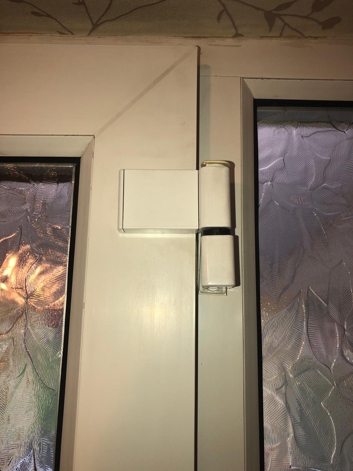

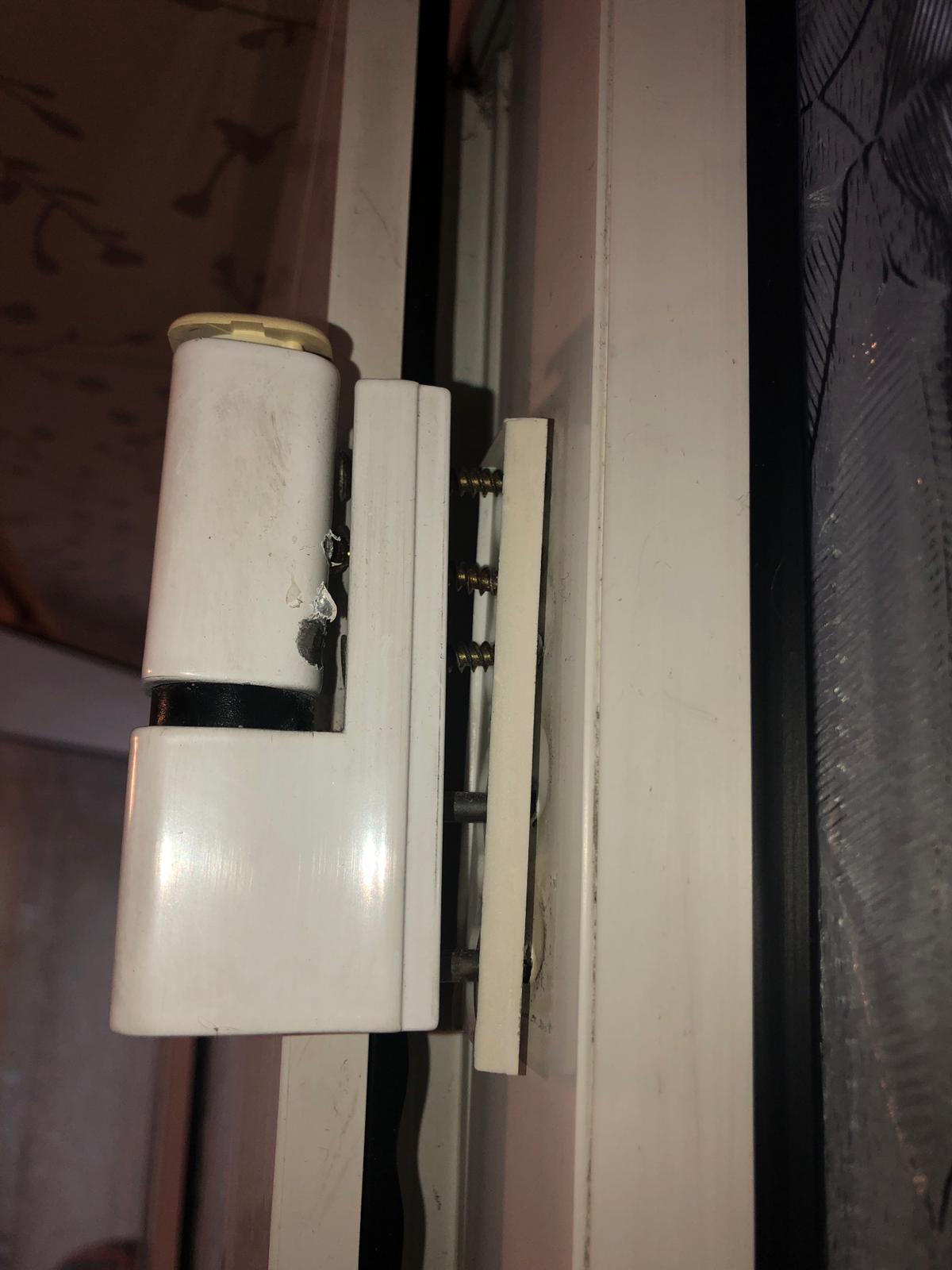

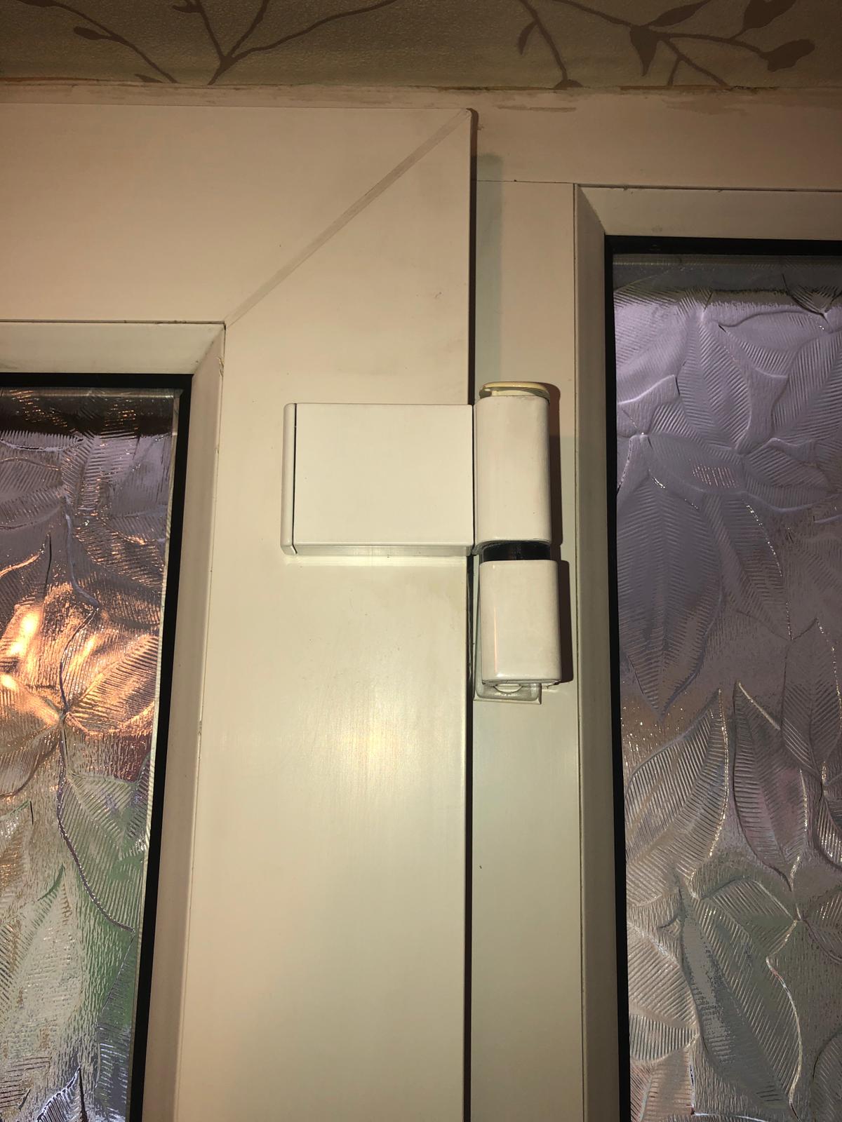

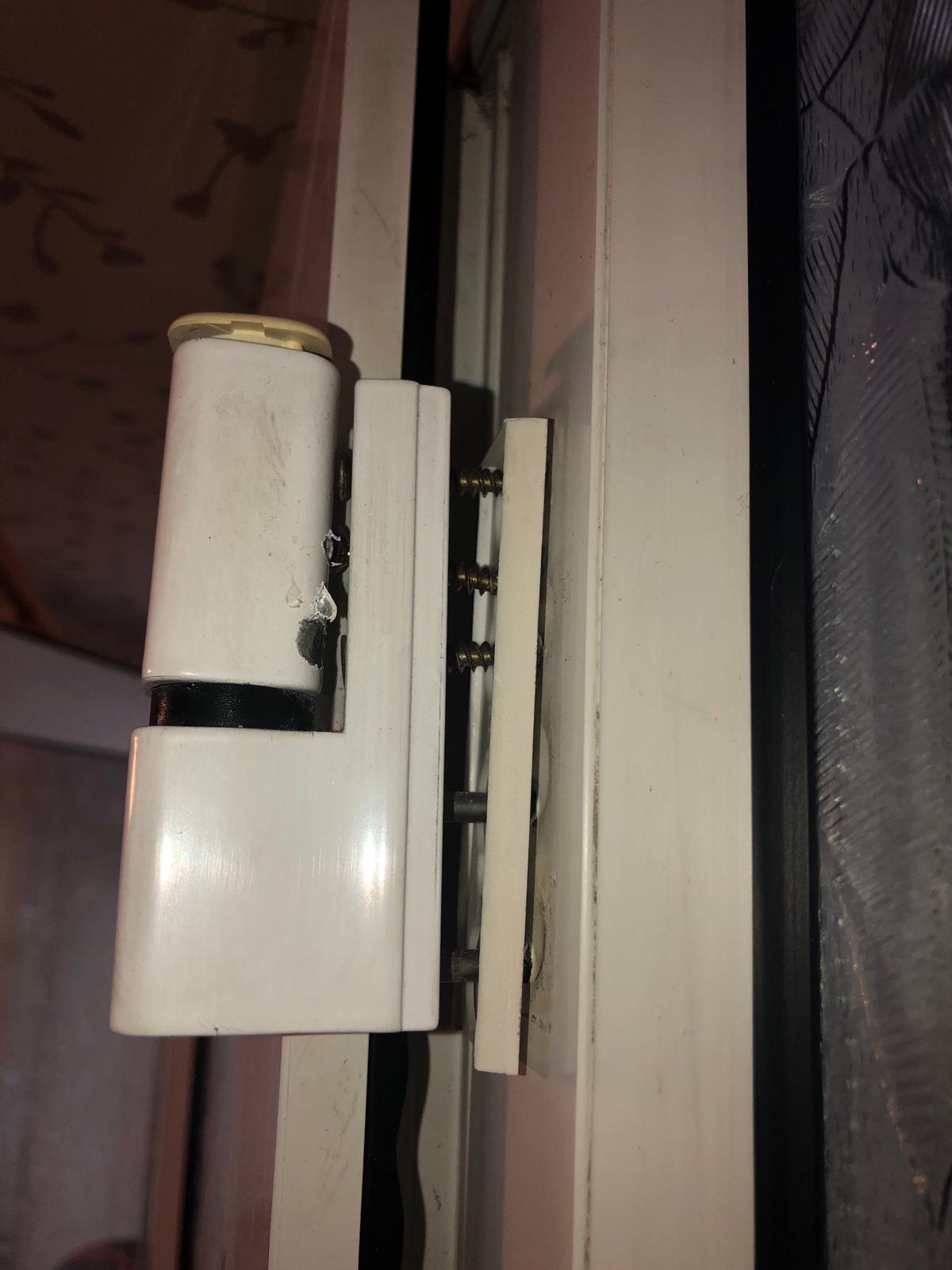

hi. I hope you can help.
My conservatory door screws have come off. How can I fix it back?
Would I have to take the full door off?
thanks for your help.
Hello
If you open the door to 90 degrees you should be able to just lift the door off the hinges and accesses the screws.
Hopefully just tightening them will do the job but you may have to put in some slightly thicker screws to bite into the reinforcing
