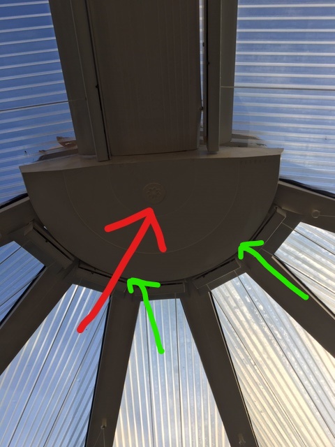

hi All,
need a bit of help please with my conservatory. i moved into the property this year Jan.
now i found out that there is sometimes water dripping from the 'cap' within my conservatory-please see picture mark with red arrow. am not sure of the correct name. the water drips from where i have placed the green arrows. i investigated and found that cap seem to collect water and then drips when full.
Question- is this normal in a conservatory of this type? this is my first conservatory so i really dont know if that is the purpose of that cap or not.
if not normal , what is the easiest way of fixing this leak as a diyer please? any advice welcome
thank you and please see pics attached
No it's not normal, mine leaks from there too.
I've had mine for many years though and it's falling apart so I'm gonna pull the whole thing down in the future.
Yours will probably need resealing again from the outside.
Speak to a specialist window/conservatory place and see what they advise.

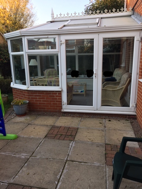

i will upload some pictures later today when i get home. yea i moved into this house this Jan but i think the conservatory is appx 18years old.
i have attached a picture now. many thanks
hi all, just an update on this. am now going to have it re roofed as i found another leak. i think the current roof has had it and to be honest too cold and too hot in winter and summer respectively .
the builder has recommended an A rated glass roof and to raise the pitch slightly, as he thinks the current pitch is too low.
can anyone give me an idea of cost for this sort of roof please? size of conservatory is 386cm long by 270cm wide. thank you
