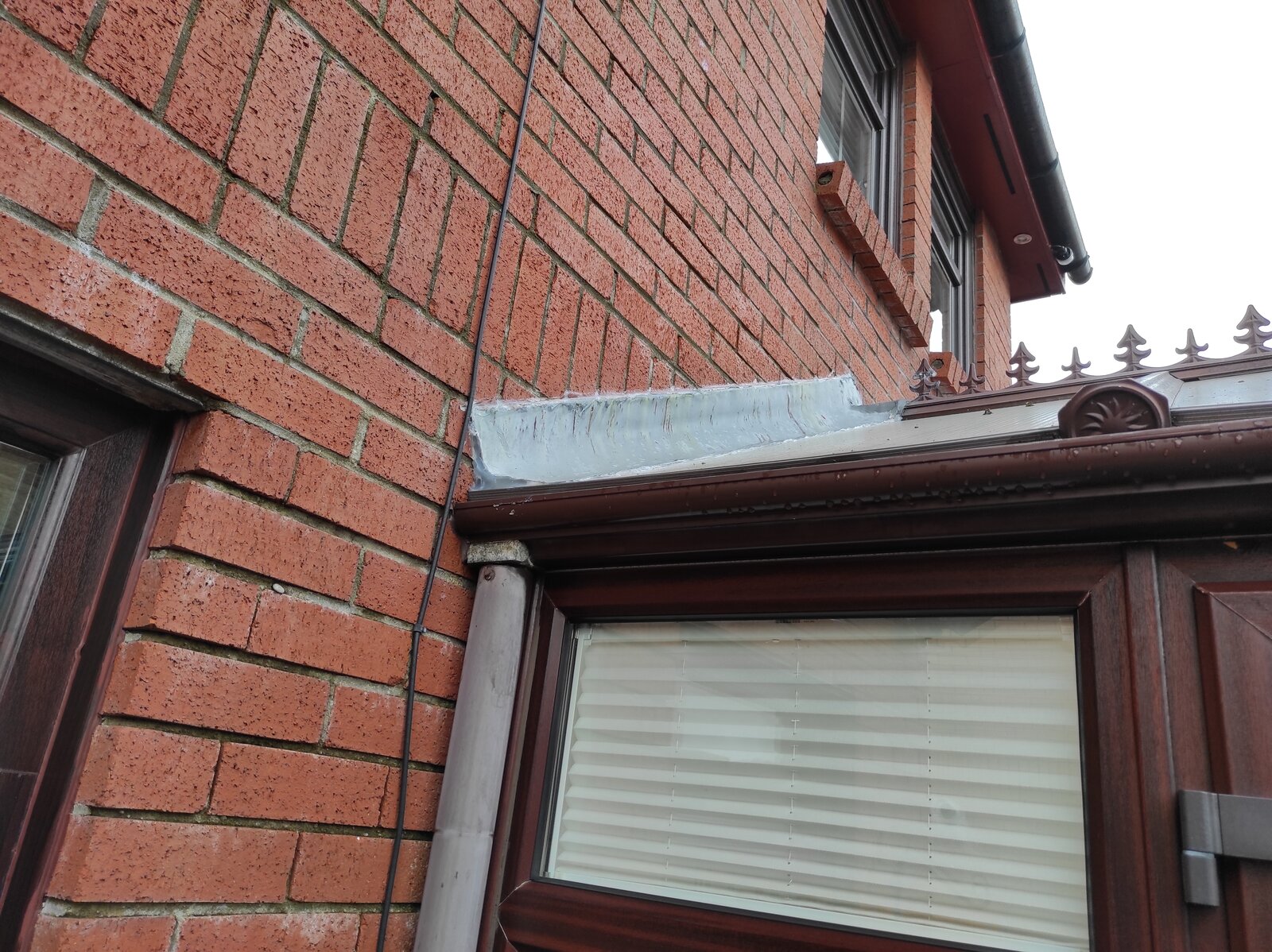

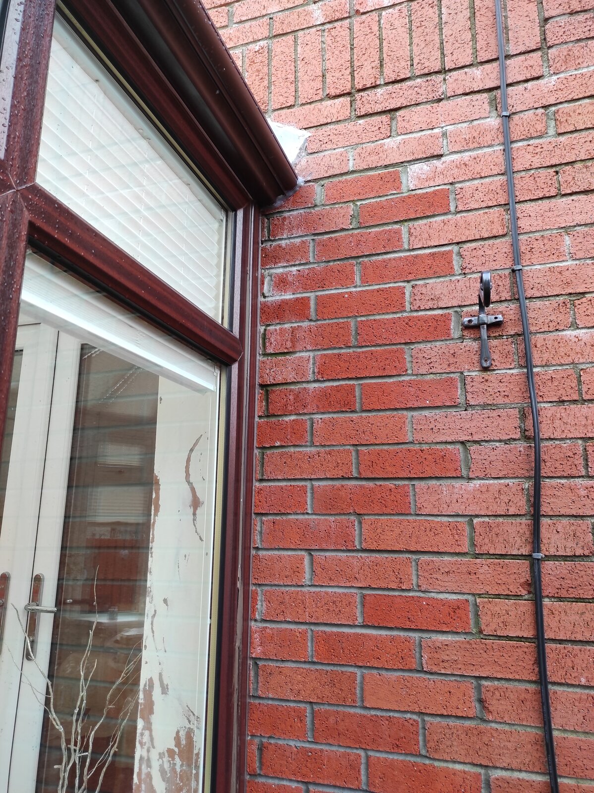

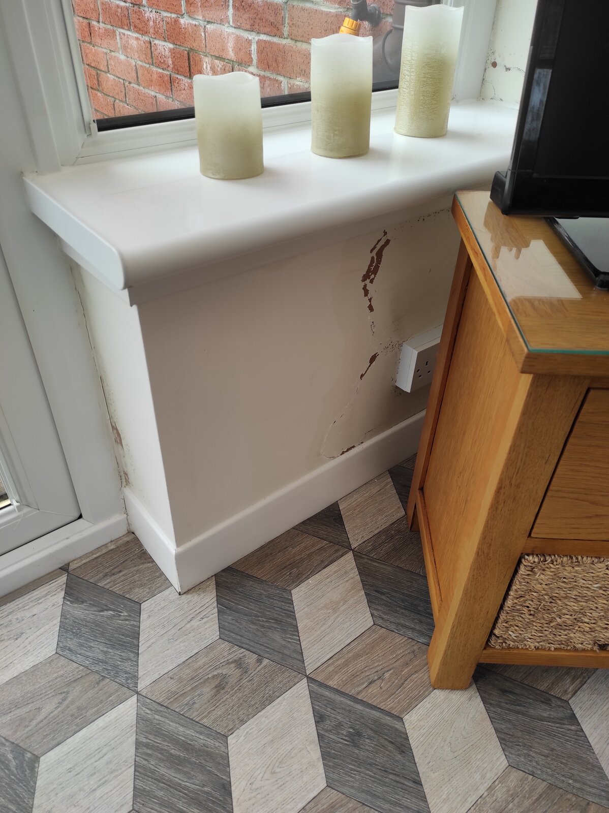

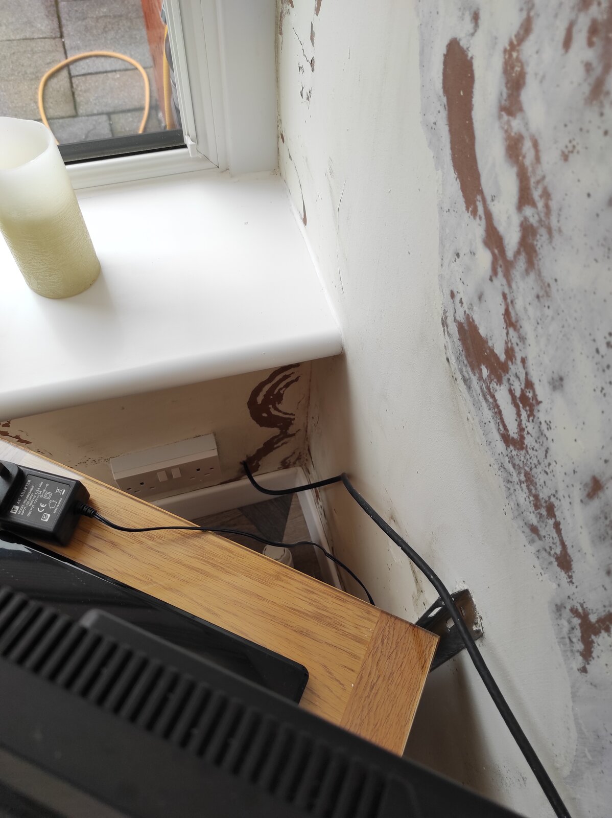

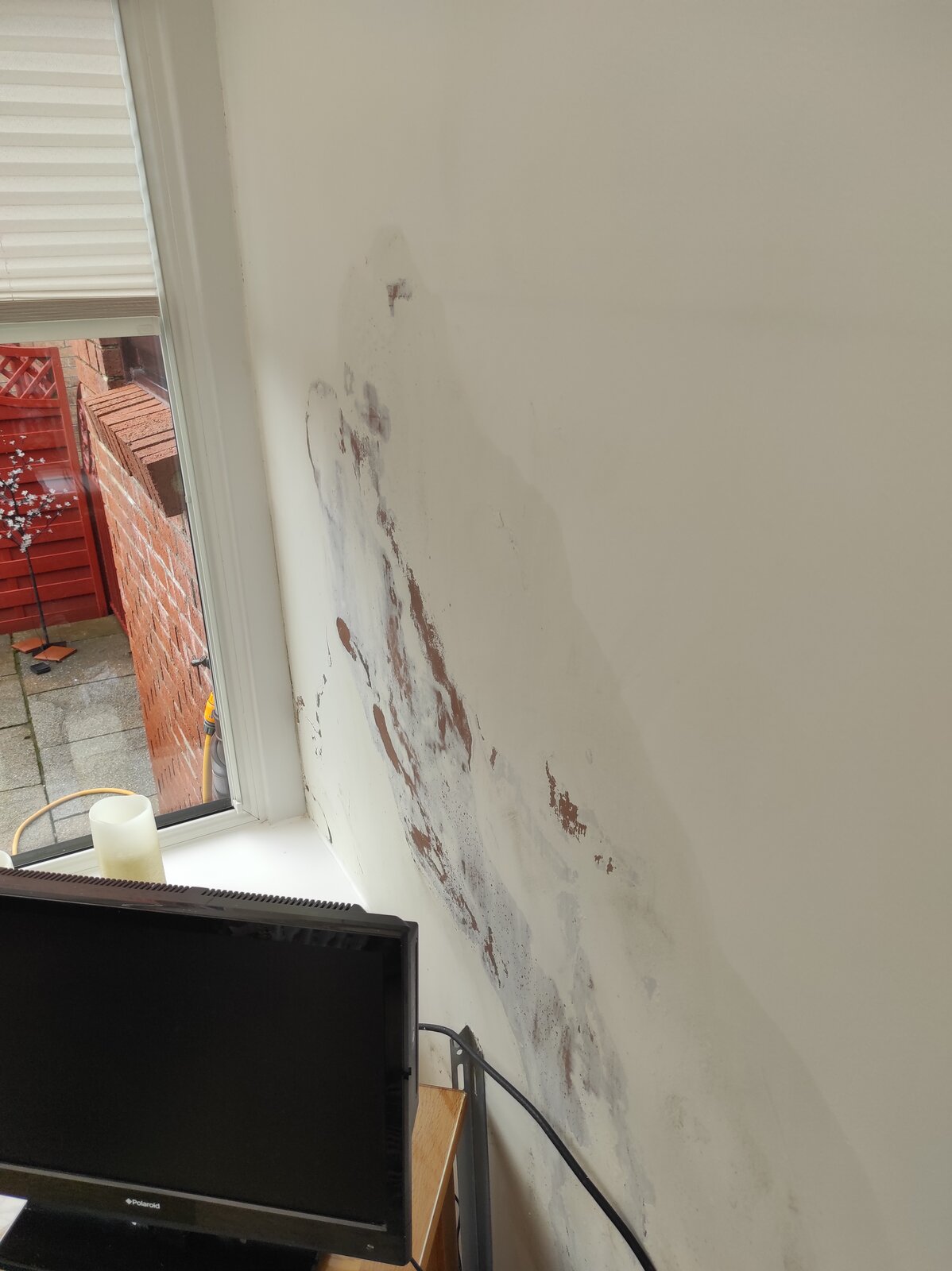

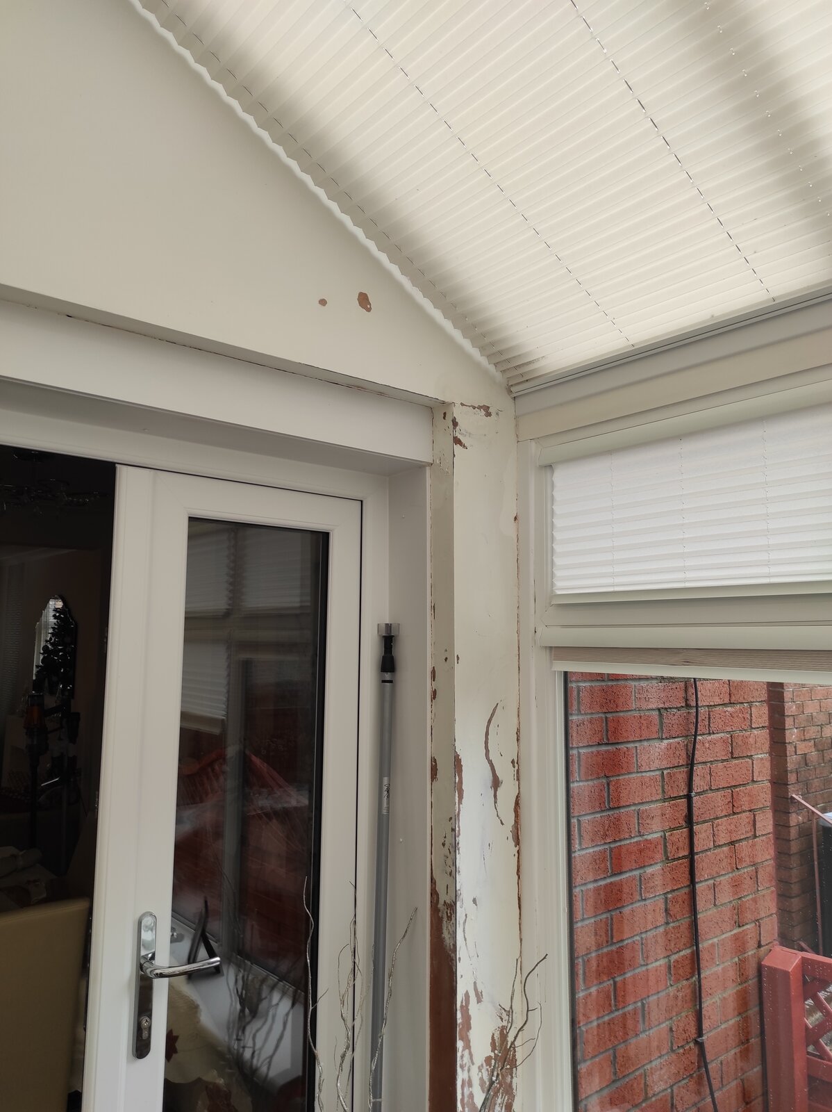

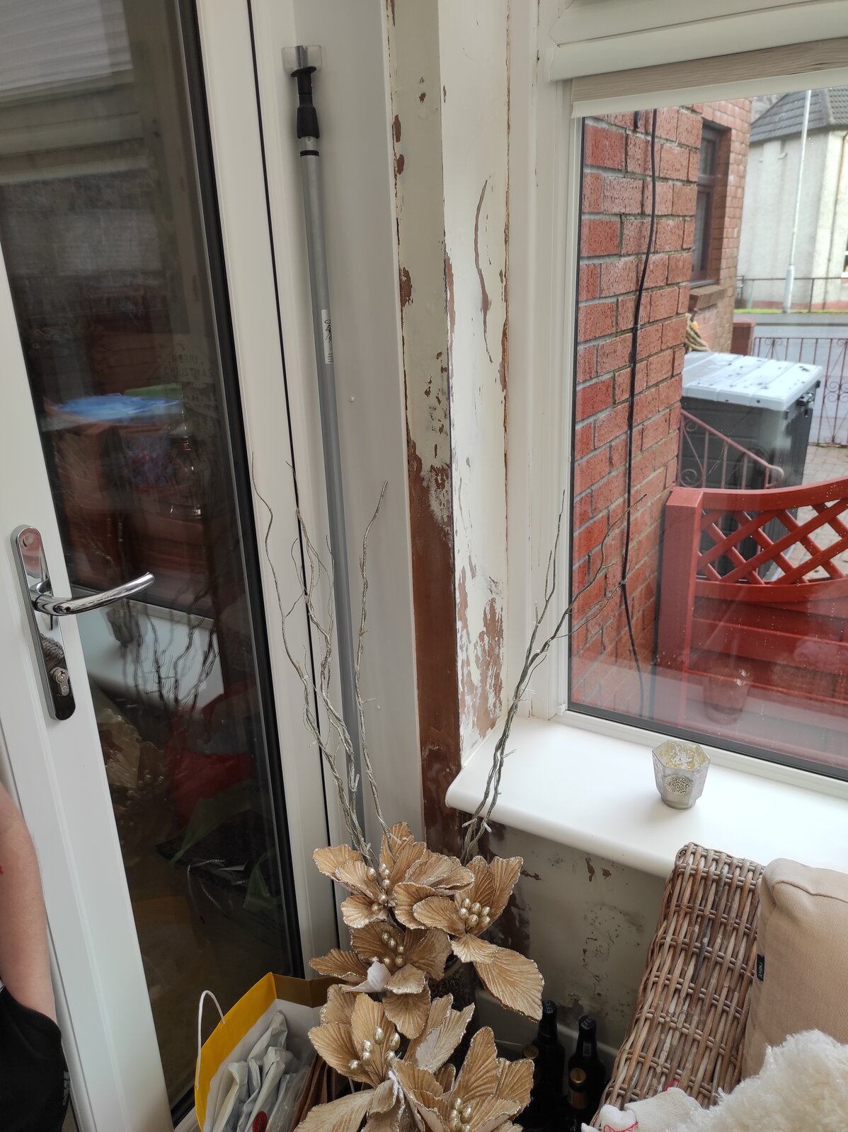

Hi, I was at my aunts today and I seen her conservatory is leaking. I'm not sure who she's had our to look at it but she's older and I feel she is getting fobbed off. One has said they don't know and the other has said they need to apply something in the dry.
I think it could be the flashing or the gutter against the house as that's the worst side from inside.
Any ideas would be appreciated

Given that there is damp on both sides of the cavity wall, I would say it’s not a flashing leak but water getting in the cavity and running down.
it’s possible water is getting at the window above.
a cavity tray is the best option
if it was a roof flashing leak it would be showing near the conservatory roof.
the RHS could be a lack of a vertical DPC where conservatory frame abuts wall.
A semi solution could be to coat wall in a silane based waterproofer. Don’t bother with budget stuff like Thomsons.
