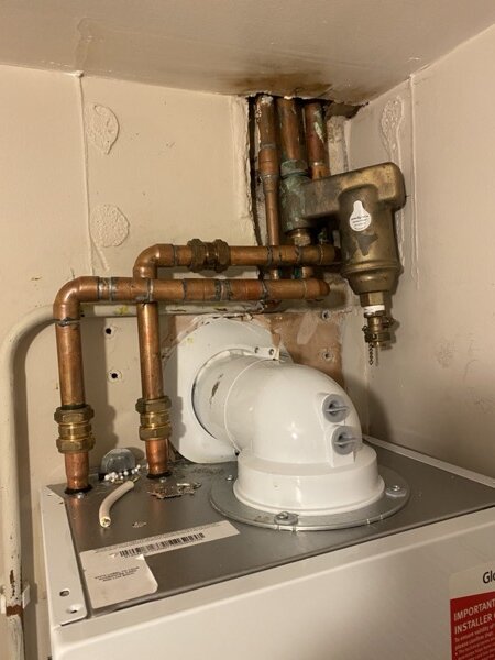

When he finished the install he came to tell my wife something was wrong with our 'pressure cylinder' (I think thats what he said, then I went to speak with him and he had his head in his hands, cursing and swearing, saying it wasn't our problem and he had connected the flow and return wrong. He said even though he marked it on the ceiling (there is a pencil mark I can see which I am not sure was there or not, which says F and R near the pipes going in to the ceiling.). I think he came to this conclusion initially, as the system was not getting hot quickly?
Anyway, he remade the copper pipes at the top and thats how he left it. I have checked and there is a marking on top of the boiler , engraved, F and R which do relate to the pencil marking on the ceiling and appear to be correct. I've no idea if they are correct though. There is a large brass unit, which I believe has a magnet? and collects debris?
This brass unit is connected to the pipe marked R.

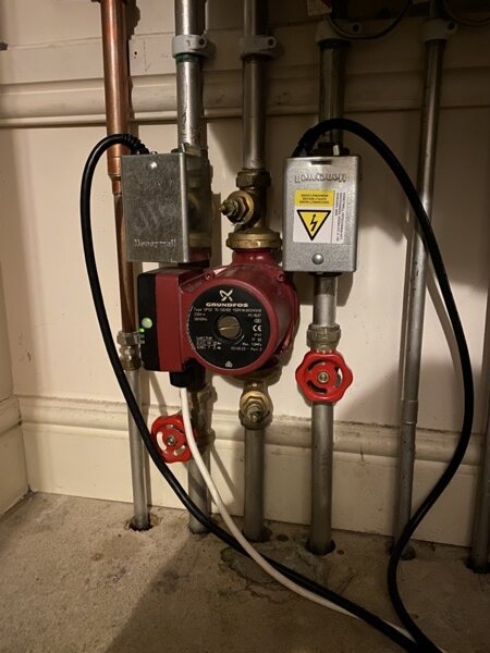

Am I correct in thinking that the pump, which is in the airing cupboard above, should be in the flow? I may be able to check this first?
Thanks again!
The pump may be on the flow, or may be on the return, depending on your pipework configuration. The installation instructions for your boiler do specify that it should go on the flow, however, so that's worth checking. Post a photo of the arrangement in your airing cupboard if you're unsure. There's a flow direction arrow stamped into the body of your pump somewhere, see if you can find that too

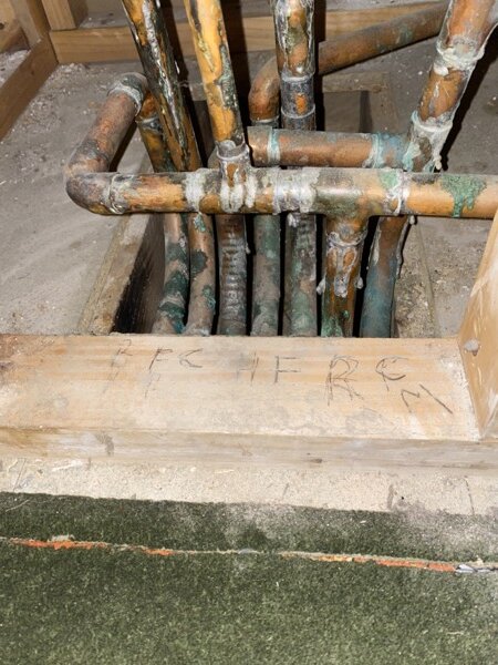

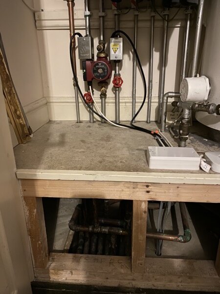

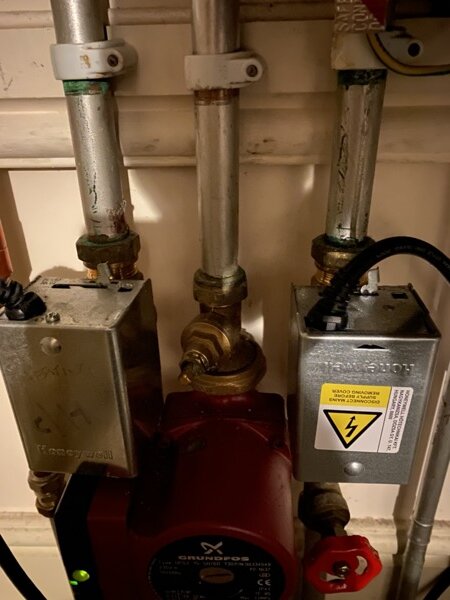

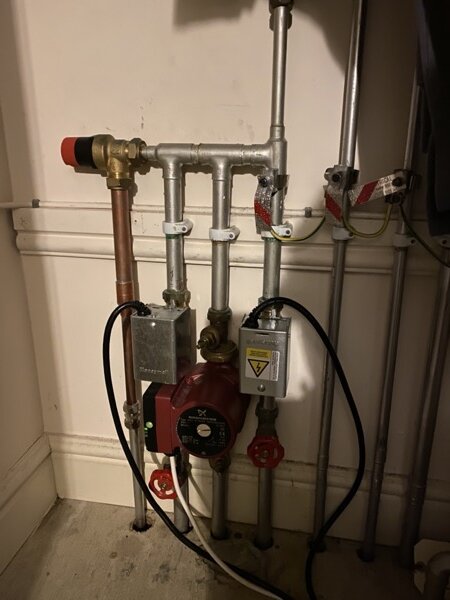

I took some photos, in the airing cupboard and one on top of the boiler. Its not obvious which pipe from the boiler goes to which pipe in the airing cupboard, as they are at opposite ends of the house. Although with the heating running, the pipe in the airing cupboard marked F seemed hotter than the R pipe. (comment noted about not removing boiler cover)
There are some pencil marks on the wood where the pipes emerge underneath the airing cupboard.

One or both of those pump isolation valves appeared to have leaked, I’m wondering if the installer closed them to stop leaking (hard to tell from photo if they’re open)?

The valves seem to be operating, not that I am an expert. When the heating is running, the lever on the left valve (the heating one) moves freely.
