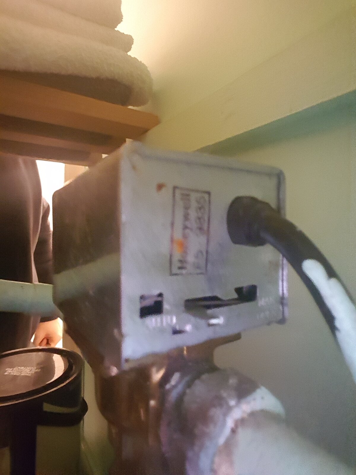

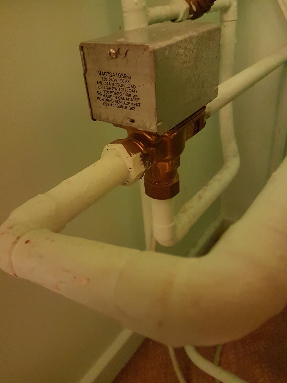

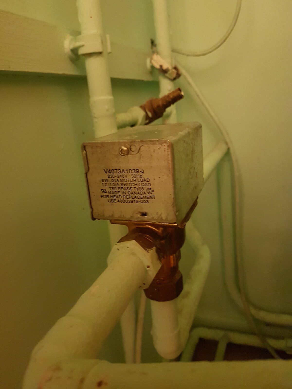

If you follow the 2 pipes out of each side of the 3 port valve, usually the right one will go to the hot water cylinder (B) the left one will head off to the central heating (A).
When only the central heating is on (with hot water off) does pipe B still get hot all the way to the cylinder?

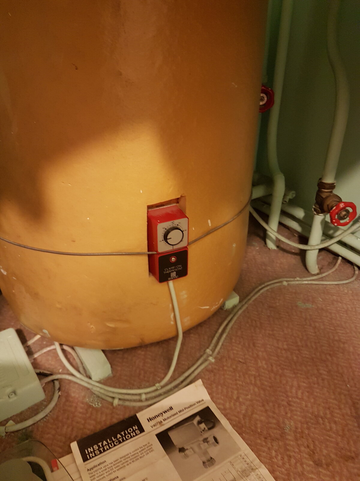

Looking at your hot water cylinder thermostat too, it seems awful low, it should be set at 60Deg.
Yes it does. And thanks- stat now up to 60.
That can depend on which part has failed, probably quicker to replace the head.
Thank you. Based on the info above, is it guaranteed to fix the problem or is there anything I can check to see whether it's likely to?

To test it, enable both HW and CH at the clock/timer, turn HW and CH stats down to minimum and ensure your boiler is not firing.
Now turn the HW stat up to full, boiler should fire, pump and the 3-port should turn/rotate adjust itself to allow heated water to cylinder. Turn the HW stat to minimum.
Turn the CH stat to maximum, boiler should fire, pump and 3-port should turn to allow heated water to your heating system.
Middle pipe if the 3-port is the one from the boiler.
It might be worth removing the actuator/ head of the 3-port and seeing if the D shaped valve spindle itself can be turned. You should be almost able to turn it with your bare fingers - be aware that some valves are only designed to rotate in one direction, do not try to force it the wrong way, rotate that in full circles.

The pump running should be fairly obvious from the noise and the noise of flowing water in the pipes. The 3-port will sound fairly quiet, it uses a small motor similar to that used in an electric clock, but you should hear the clicking of the micro-switches as it moves. It only takes a minute or so to move to a new position. Depending on the type of 3-port, you might hear a fast and brief whirl, if it's a spring return type of actuator.
If it's not clear, the actuator is the upper part in those two photo you posted above. The valve is the water part below with 3 pipes, hence calling it a 3-port.

I've used the timer to request heating and hot water separately.
Pump seems to be fine for both.
For hot water, the 3-port makes a rapid whirling sound for a second before a single click.
For heating, it seems to just click straightaway...
I set the timer to request hot water only and it works fine. However, I was expecting the radiators to get hot as well, but they didn't. Yet when I request heating only, the water continues to get hot...
