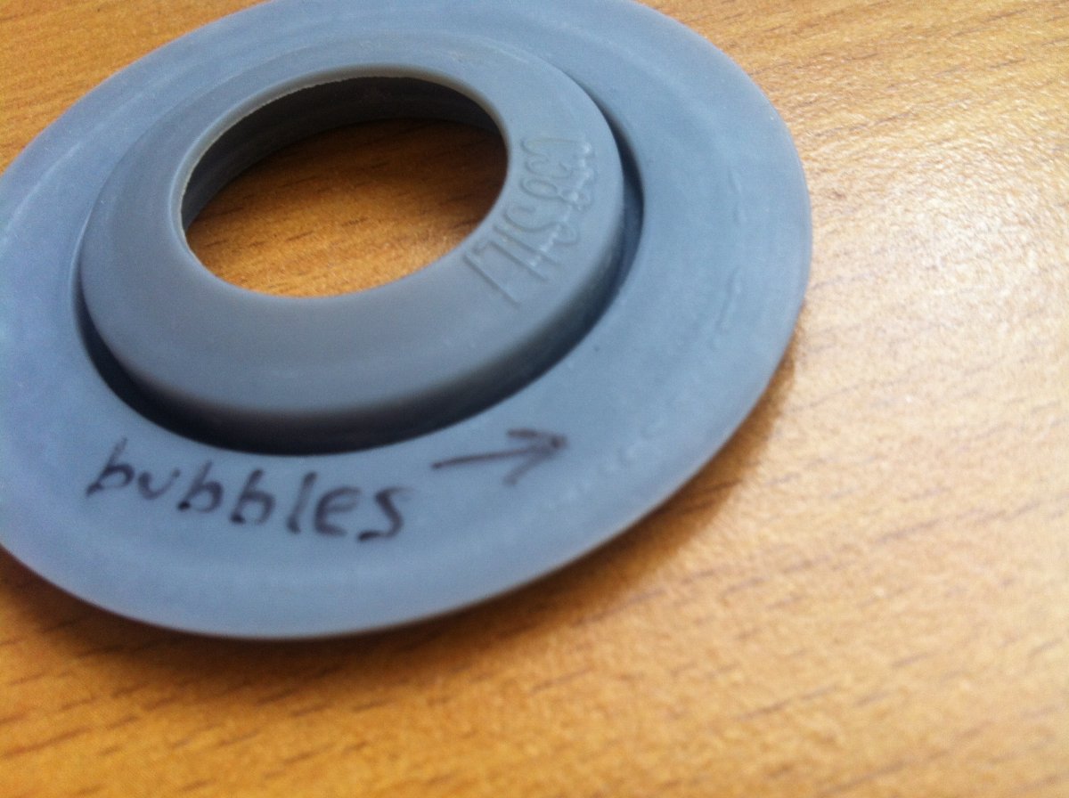

Hi, just to inform everyone on the Wirquin / Jolly Flush type of valves. The problem is that the silicone rubber seal soon fails, we are talking only a few weeks. What happens is the seal perishes very quickly, it starts to bubble up and then the slow leaking begins inside the toilet bowl, wasting your water. I have now replaced 3 such Wirquin silicone rubber seals and they all went the same way, failing after
about 6 weeks. I will provide a photo of the perished seal. I will soon be replacing this useless Wirquin flush valve for something more reliable and will post an update to my solution.

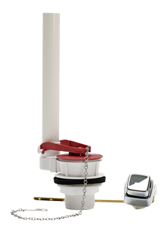

Ok, having considered my solution. I have decided to go with a dual flush flapper type of valve, I will fit this today and if it goes wrong I will post here again. No further comments from myself will mean this flapper is good. Picture added of the exact item I'm using, the fluidmaster 507UKK073 dual flush flapper:
