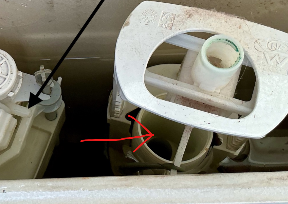

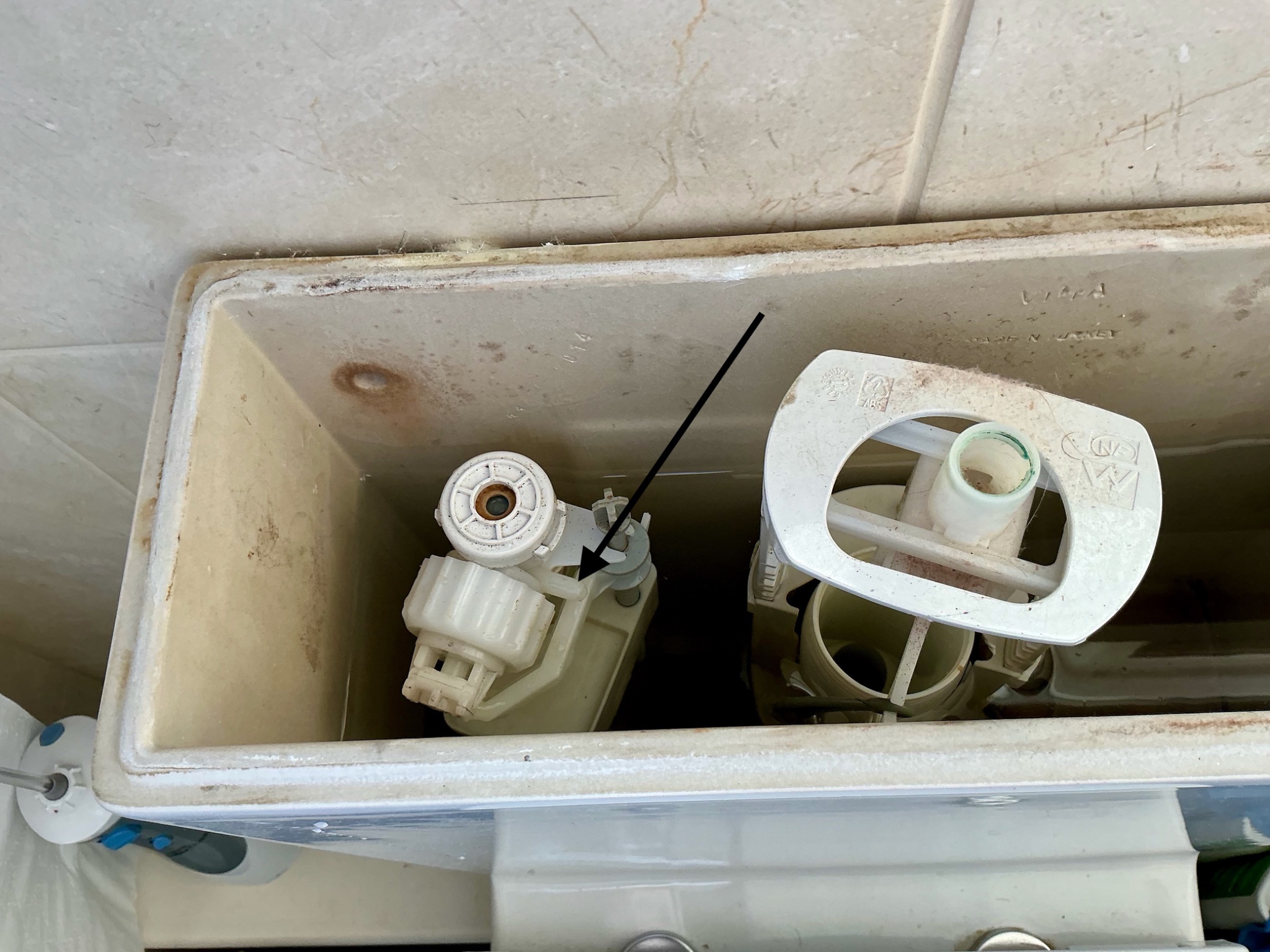

I noticed our toilet was constantly trickling. I flush it and it stops then starts back. I have changed the diaphragm washer but it didn't stop it. I have attached a picture of inside the cistern, where you can see some water coming out of a small tube - I've pointed to this with black arrow. Any ideas? Do we need a new inlet valve? Thanks

Does it keep filling then overflowing down here?
Yes - the water from the little pipe seems to raise the level which goes into the overflow and I assume then the trickling begins.
If you are sure the washer is fitted correctly then, yes, fit a new fill valve.
We're pretty sure we've fitted it right - did it about 6 years ago, although that time it was hissing, whereas there is no noise this time. Thanks for your advice.
Make sure it’s clear of the side of the cistern and is it adjusted to the correct level?
