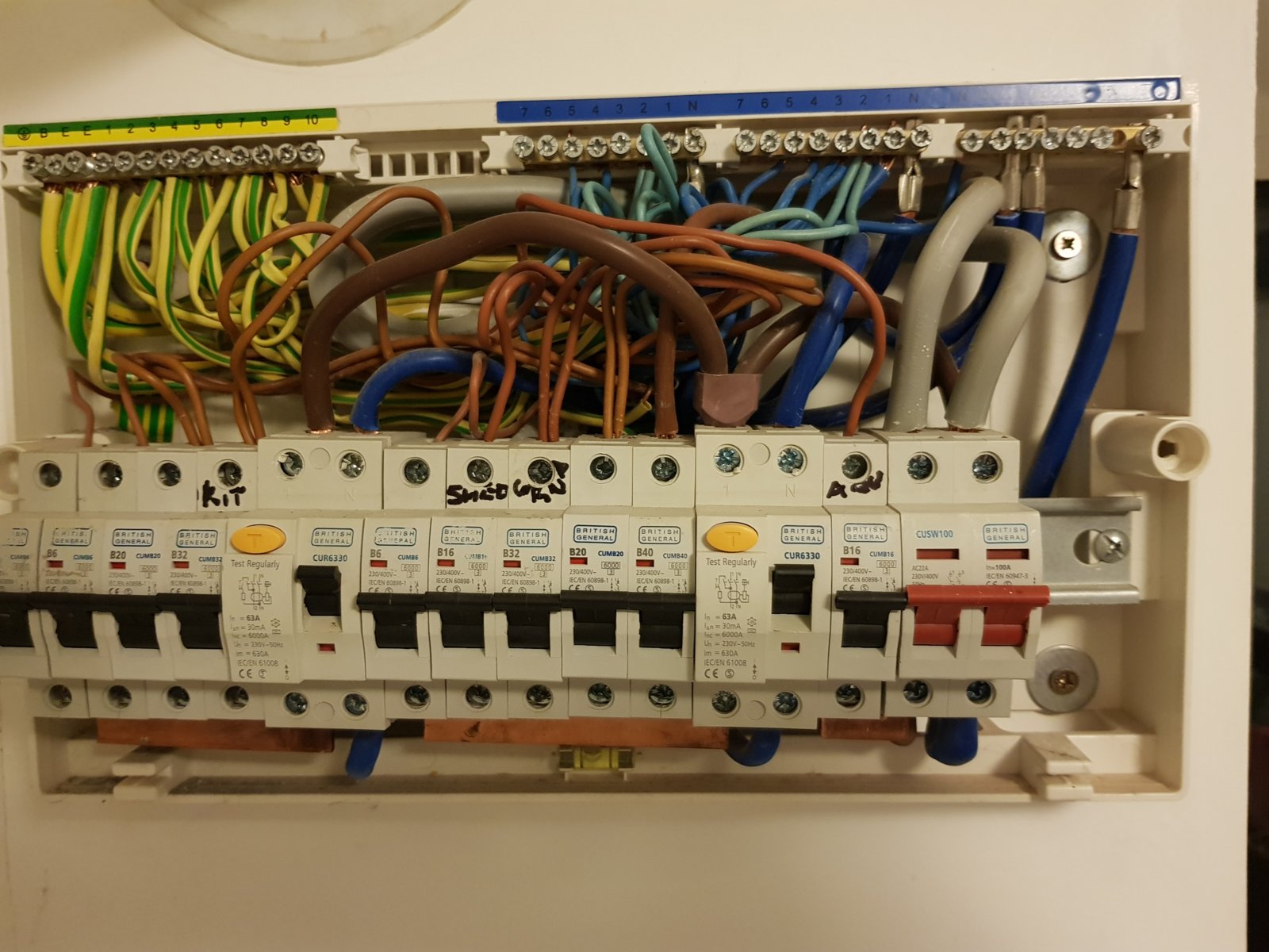

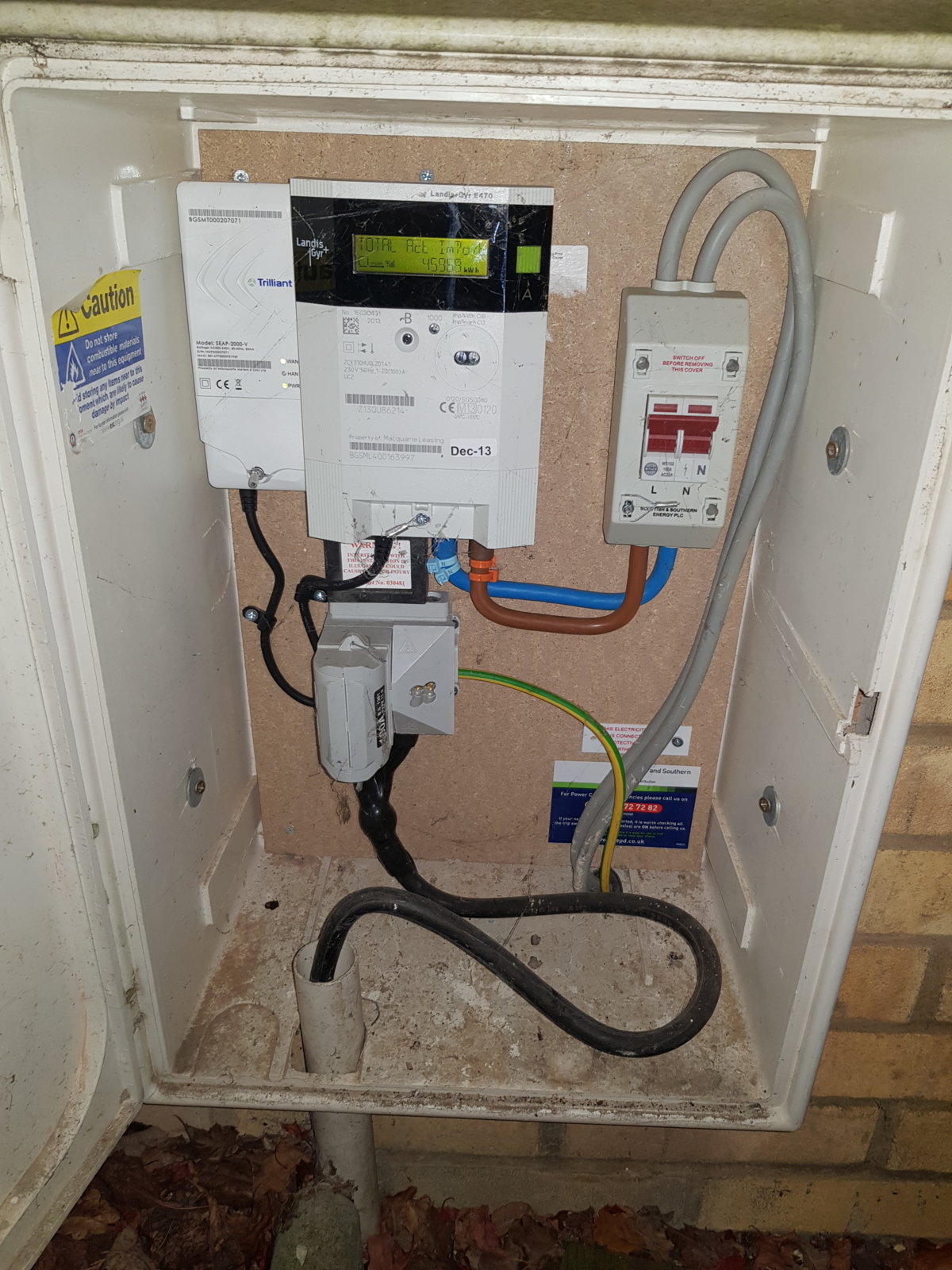

Show us some photos of your existing CU, meter, and the wires around and between them. There may be other reasons why your old installation is unsatisfactory.

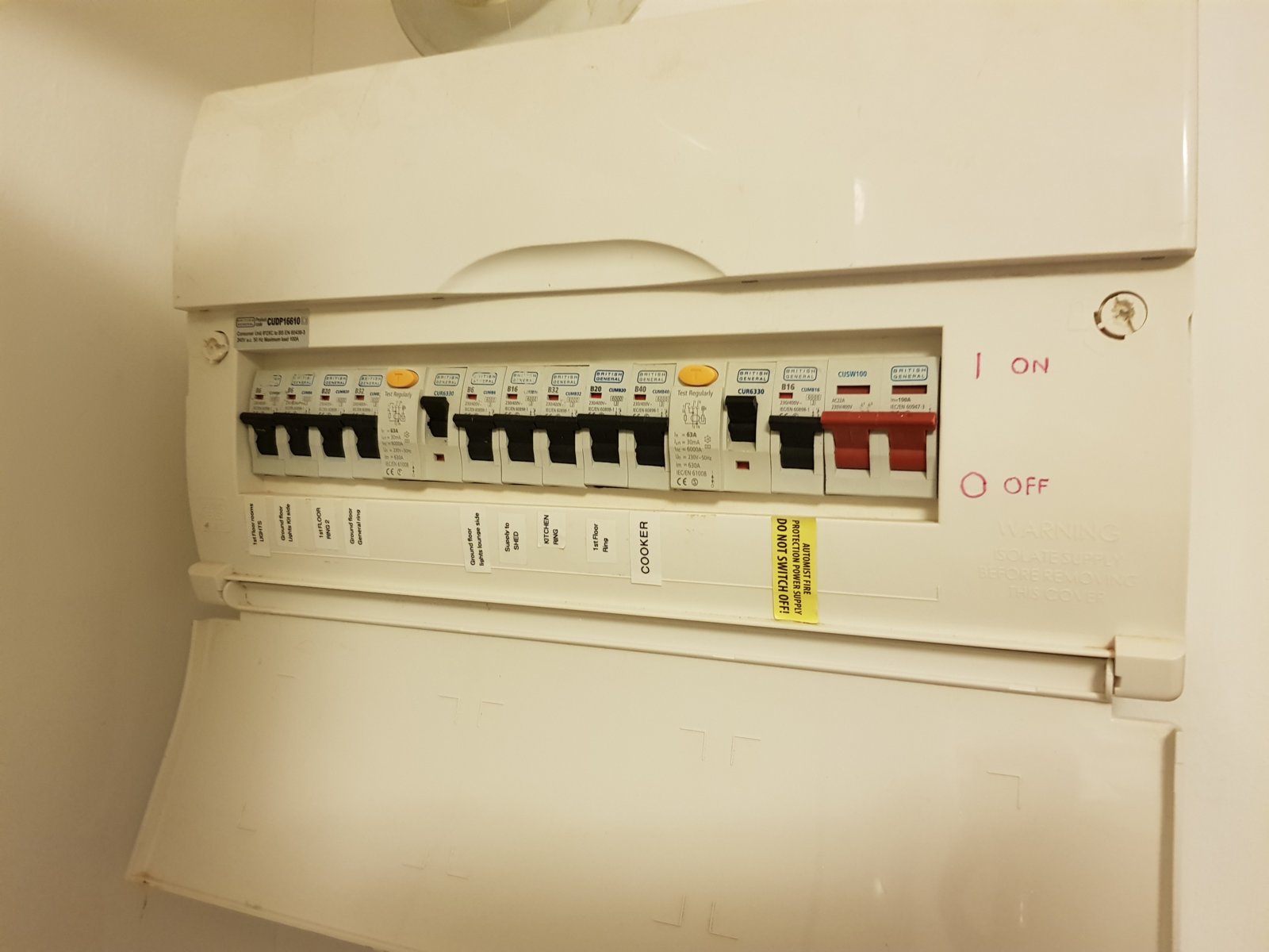

Pic of CU attached. Don't have a pic of meter etc but can add later if that's useful

Couple more photos
Inside the meter cabinet:
Inside the CU:
There are no cables around the CU, all the cables come out of the wall already inside the CU
