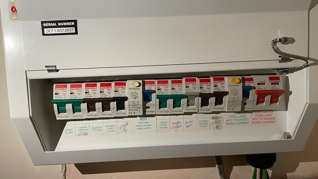

Hi all. Looking for some advice on what options are available and viable for the following.
Next week we move into a new house. The house currently has a Contactum board with no spare capacity. The house was rewired and board replaced around 5 years ago i believe. Later in the year we plan to add a car charger and a garden office so looking at options when it comes to creating the space required to add these to the consumer unit. I don't plan on doing the work myself but was looking for viable options before i contact and discuss with an electrician in the area. Which of the below options, or indeed any others is a good/acceptable way forward? There should be an image of the current CU so you can see whats what.
  • Combine Smoke alarm to downstairs lights. Combine kitchen lights to 1st Floor lights. Creates 2 spaces to add new circuits. Kitchen is a new extension with 6 LED spotlights. 1st Floor has 5 lights - all lights are LED in house.
  • Split the tails and add another smaller consumer unit. There is a dual pole isolation already installed in same location and space/access looks good
  • Replace 1st half of board with RCBO's to make space for the 2 new circuits
  • Replace consumer unit with a larger version?
Thanks in advance.
Step one select the EV charging unit you want to use, as you need to know what is built in, 6 mA DC detection, lost of PEN detection, and RCD. This can change what is required, but yes swapping half to type A RCBO's seems to be a good option.

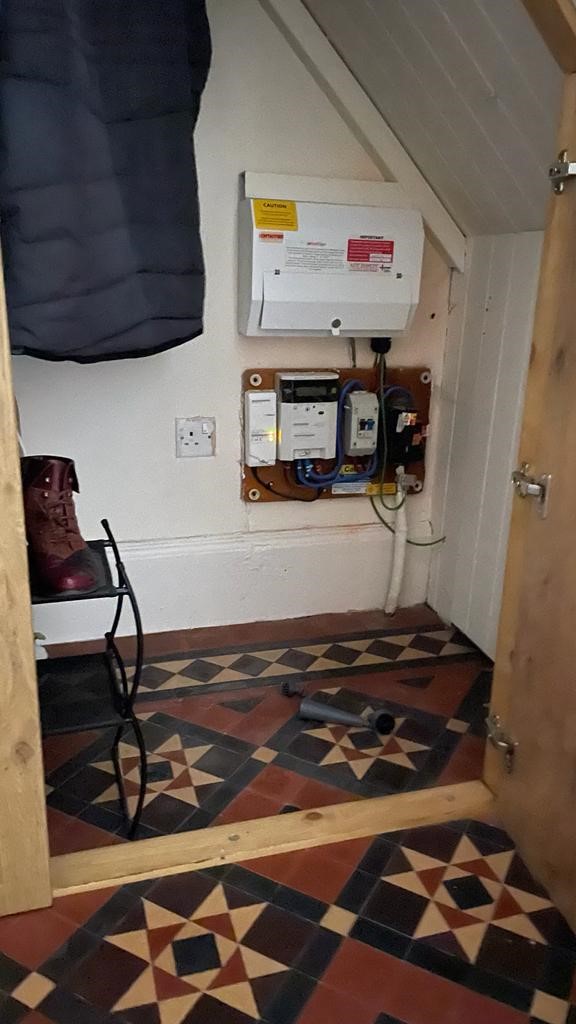

Thanks everyone for the responses. Wider shot for reference (and cover down) to see if this changes any options. Not decided on charger yet, possibly Wallbox pulsar plus but certainly not tied to anything. Many thanks
I had a hunt for Contactum double pole RCBO, it seems they do make one, However no picture and says "Width in number of modular spacings 2" so it does matter if a TT or TN supply. Seems part number CCPBR06322AB
Also a large difference in price. Says Trade price £34.27 and hunting the part number not found any for sale with price.
Single pole switching far cheaper £19.86, so TN or TT. Just seen wider shot seems TN supply. So single pole switching can be used.
