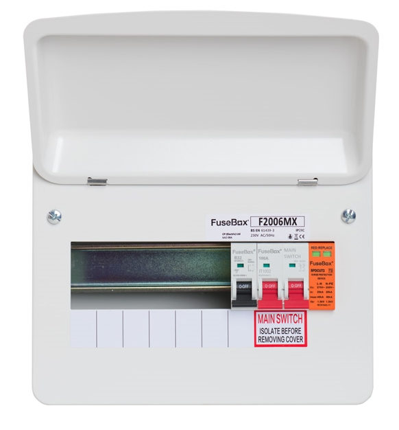

Well, if you have to buy a budget beard, I suppose BG are better than some of the other cheapo options. Personally I would go for something a little more expensive such as Hager or Schneider.
4 way is unlikely to be enough for modern needs though, unless for a very tiny flat. You should consider surge protection as well, that will either occupy 2 spaces in the board, or could be fitted in a separate enclosure.
The electrician selected should advise, not really sure how, as I am an electrician (retired) and am not fully convinced about need for a surge protection device (SPD) but just to be on safe side fitted one to my own house.
What we should do is measure the earth leakage, we are told back ground leakage should not exceed 9 mA, however if you use all RCBO's then unlikely you will have a problem, and it needs 4 modules less, so a smaller consumer unit.

No, the default is to fit them, but the owner may reject their use. They protect appliances not personal so not mandatory. Personally I would say want some thing like this 1688004840085.pngwhich would cost around £60.60 with 4 RCBO's at £9.90 each so £106.20 unless a TT installation if so would want twin pole RCBO's so £118.40, it may need an exterior isolator another £12, and also may need new tails, at £5 per meter, now we start to see the problem in the customer buying the parts, it may also need the DNO to fit the isolator anyway, and a simple error like not having two blanks could mean can't energise the unit until supplied.
