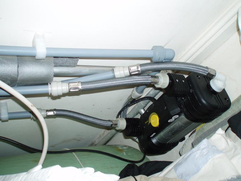

The pump is already by the base of the hot water cylinder - I had it relocated by the plumber as per my original thread.
Taking photos now - will post shortly.
OK Here is the pump located at the base of the hot water cylinder, along with a shot of the newly fitted pipework into the cylinder solely feeding the hot water supply to the shower pump.
Sorry the pictures are on their side!
The cold water feed comes directly from the loft
just looking at the top of the cylinder pic.
no wonder your drawing air in that a right old bodge.
its no good like that an air that in the cylinder will rise up the side of cylinder and take the first exit out which is your shower and cause air don't go down hill will get trapped in the top of the copper section.
i would fit a new flange in the tank.
surrey flange
essex flange
they are designed for showers etc and designed not to draw air in.
I hear what you're saying.
Do you have any suggestions as to how to remedy this situation - in your professional opinion?
In the same location or would the existing one need to be capped and a new hole drilled for the new flange?
just cut the pipe on that one leaving an inch and put a cap end on.
a surrey flange gos in the top centre where your other pipe comes out it just converts that to two pipes instead of one.
essex flange gos in the side of the tank.
a surrey flange will work fine with your set up and can be converted in no time.
this is a surrey flange when fitted.
