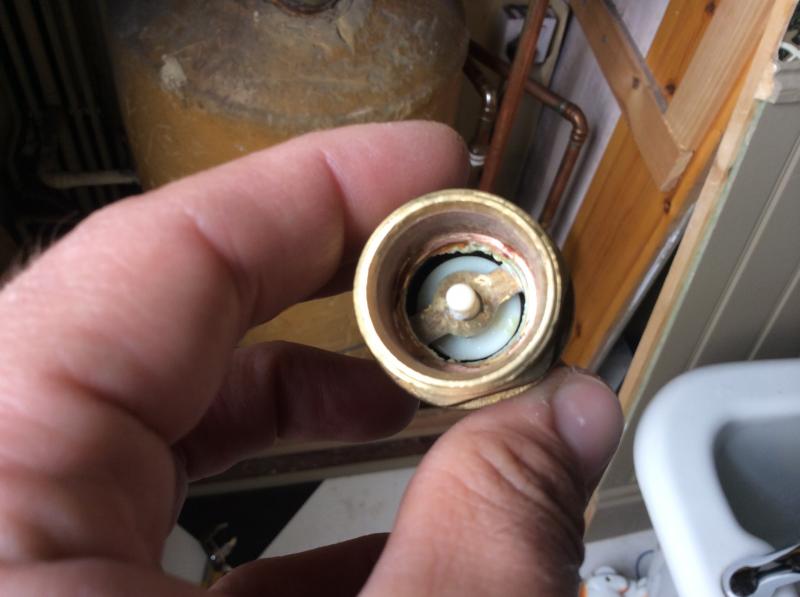

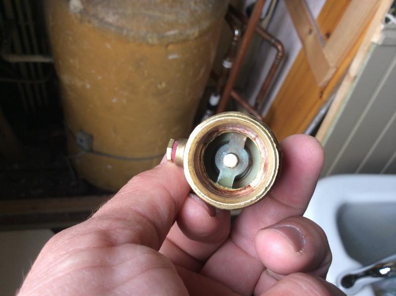

I'm pretty convinced (for what my opinion is worth) that it is not the shower control as I could not get good flow through the hot pipe even when I connected the hot outlet to the cold outlet from the pump.
Would the valve in question cause the 'pulsating' of the pump when only the hot side is on?
Yes it would!!
I have changed the NRV for a straight coupler and hey presto full flow!
Thanks again for all your wisdom and advise it has saved me a fortune. (And I have learnt a lot about my plumbing)
Here is the valve in question for anyone interested.
