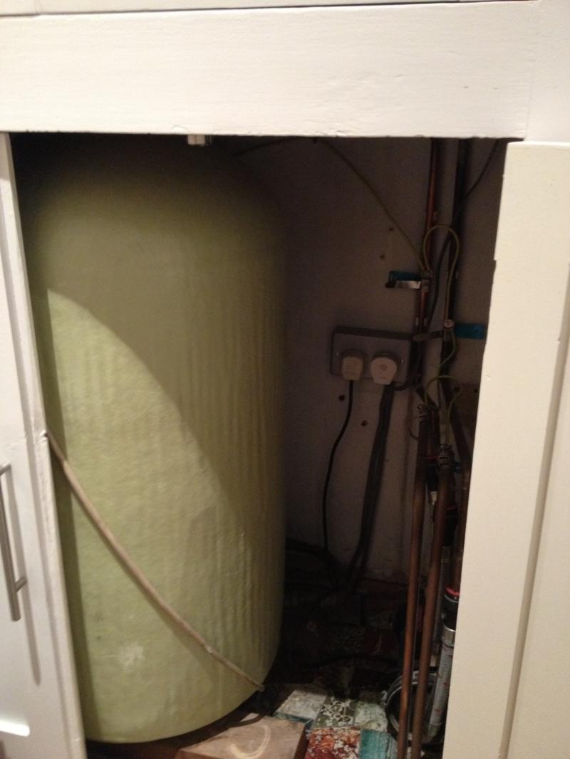

Don't know the exact size of the cylinder, but just took a look and its about a meter high, and normal diameter.

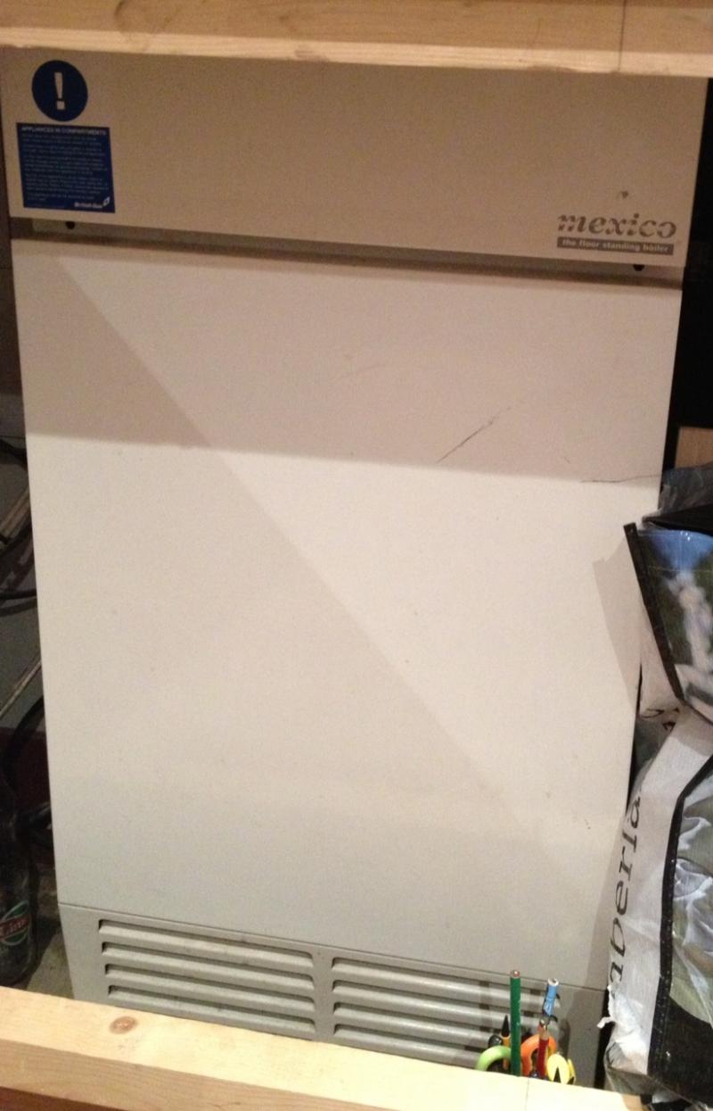

The boiler is an Ideal Mexico Floor standing boiler, with a potterton control panel, couldn't find a model number on it.

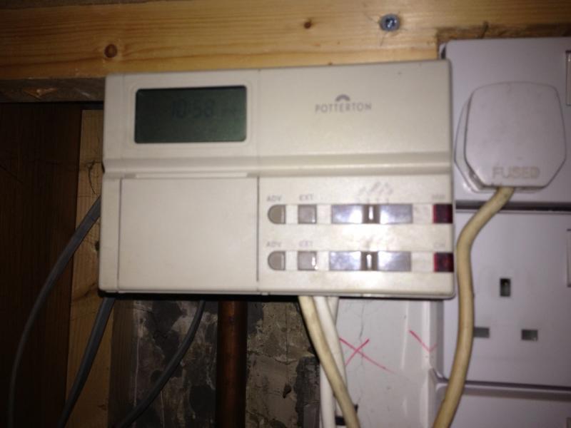

The control only allows for hot water to come on auto twice a day, at the moment theres once in the morning and late afternoon for kiddie baths, we manually turn it on at night for baths.

Not knowing where you are in the country it still depends on limescale and control regime.

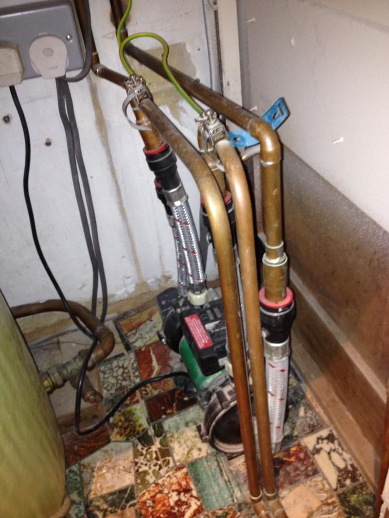

Can you post pictures of the airing cupboards, boiler and timer along with any control valves.
But guessing at age and things I would say it will take 45 to an hour for the tank to heat, and a decent bath and shower will deplete the tank pretty quickly.
It would be helpful to see what control valves are directing the flow from the boiler to the heating and hot water.
But the boiler is a good one - if not very efficient.
Unless you are planning major works on the house I would leave it be but invest in some decent controls.

If you have a thermostat on the side of the cylinder, try setting the time to ONCE and see if that helps. Make sure the thermostat is set to 60 as well.
Am I still right that I would have to predict when we wanted hot water and then either have the timer turn it on or do it manually?
Yep.
Allow an hour I would say. If there is a thermostat it should switch off once you're up to temperature anyway.
Setting the timer to ONCE means it comes on in the morning, stays hot all day then switches off at night.
