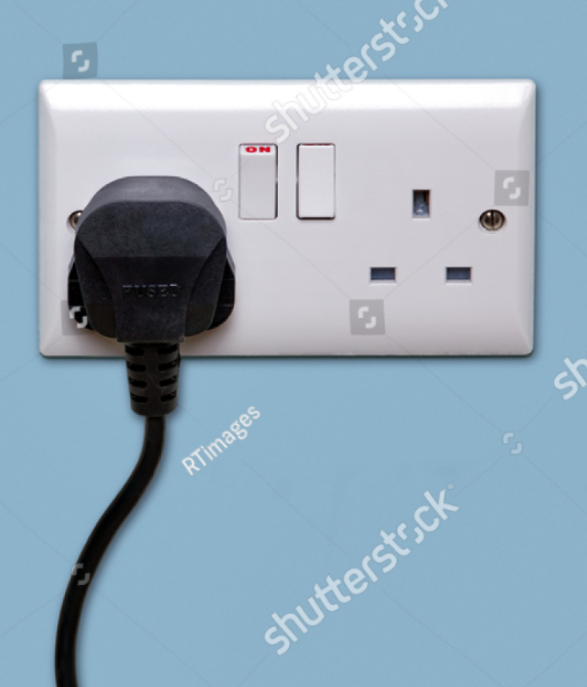

a single socket + single FCU sounds like a useful product.
I mean, if you think about, there are actually millions of them in the country:
Single socket- check
Switch controlled outlet- check
Replaceable fuse- check
Flex cord to appliance- check
Depends on the wattage of the heater, (and the condition of the plug and socket) really!
