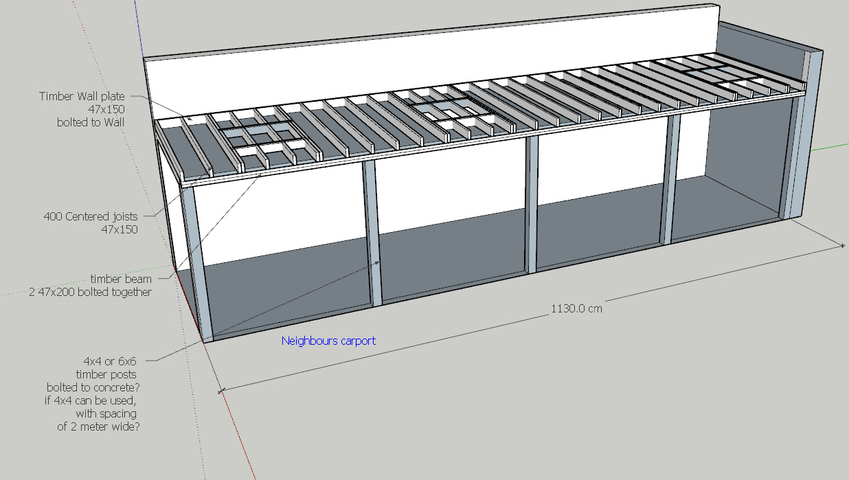

Hi ,
Planning to convert my carport to garage with flat roof (warm roof), I was thinking of using timber posts and beams on one side as shown in the attached picture. I was wondering if I could use 4x4 timber posts evenly spaced at 2 meters (Bolted down with Galvanised Bolt Down Post Shoe - https://www.toolstation.com/galvanised-bolt-down-post-shoe/p93265)? or should I use 6x6 timber post? Any other issue you foresee in the design (ignoring planning/regulation related, it will be dealt as necessary)
