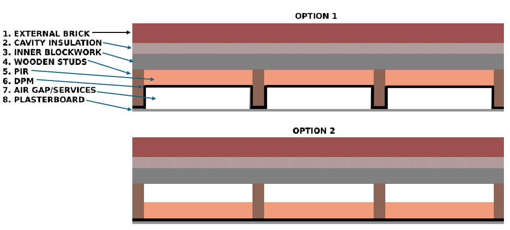

I'm currently planning to convert my external workshop (approx 60sqm) to WFH offices. At the moment, it's got a roller garage door, uPVC windows + door, filled block and brick cavity wall and a pitched trussed roof with no loft insulation. I'm currently having air conditioning installed as a means of heating the area (I plan to erect 2x offices, 1 main area, it already has a w/c), and as such the heating engineers have spec'd out a 3x internal and bosch 5000i external unit.
My question arises here. I've done endless research into this, and I'm trying to work out the best way to improve the thermal efficiency of the building. I'm going to be adding 300mm loft insulation, changing the garage roller door to a triple glazed sliding door, but i'm unsure of what to do about the walls. I've been thinking of going for 50x75mm CLS studs (63mm finished) and 60mm Rockwool RWA45, followed by a vapour barrier and then plasterboard. I'd welcome any thoughts on this - Rockwool rather than PIR to keep the cost down, and surely this will be better than dot'n'dab anyway? So my wall make-up:
- Block and Brick wall with 80mm blown-in insulation cavity
- 50x76mm CLS studs secured to the wall
- 60mm Rockwool RWA45 between Studs
- 1200 gauge vapour barrier
- 12.5mm plasterboard
Also... bonus question... the floor is currently concrete slab, followed by 40mm (or so) polystyrene and then 18mm T&G P5 chipboard. I'm thinking of changing this out to also improve thermal efficiency, as it's been cut up in a few places so want to also avoid the dreaded creakyness of poorly maintained T&G if possible (my entire house has T&G which was ripped up when CH was installed 20yr ago, before I moved in). ANy ideas on best action here? Thinking Concrete Slab -> DPM -> PIR -> Engineered wood floor
