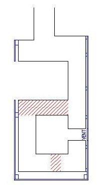

The chimney structure is effectively freestanding in the centre of the house (it ties into one thin internal wall) made from engineering brick (hard as nails) and is quite massive. on the ground floor it consists of a pair of 'cavities' side by side, one facing the front of the house for the front room, one facing the rear for the back room. The rear fireplace is unused, and closed up with a small vent at the bottom.
On removing the old stove we discovered that the existing structure had been butchered somewhat to allow fitting of the stove:
The sketch plan below illustrates this a bit:
The red hatching is removed structure that has now been repaired/replaced. The front room, where i intend to put the fireplace is to the left of the structure in this view.
Other electrical work in the room has required the affected chimney breast to be batten & boarded to allow electrical services to be flushed onto the face - this is shown in blue on the sketch.
We've got a cast iron fireplace, hearth, and fireback/chairbrick from B&Q and I've been reading around a few forums websited trying to figure out what else I need to make it all work.
- The brickwork supporting the right hand side of the lintel had been removed, leaving the lintel held up by mortar to the surrounding brickwork only.
The dividing structure between the front room and back room fireplaces had been removed, effectively making a single cavity with 2 flues.
The external side of the cavity adjacent to the unused fireplace had been opened up (badly) to allow pipework access to the old back boiler.
